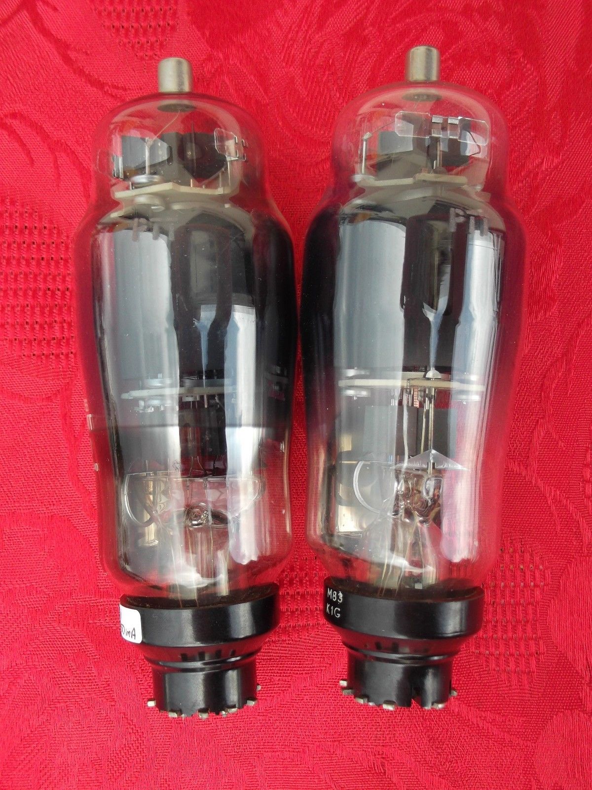

I assume that your amp is the sound application PP, if so may I ask what the OPT and the idle currents are?
My amp is an SE amp of my own design, the Tubelab SSE. I have explored the upper limits of SSE power output using a bunch of "previously auditioned" Electro Harmonix KT88's I got cheap about 10 years ago. I wired the amp up to a variable power supply and kept cranking up the B+ voltage until I felt that something bad was about to happen. I then backed up a bit and found a suitable power transformer. I have one SSE amp that runs a B+ that is around 465 volts, but since the amp is cathode biased, there it about 425 volts across the tube. Running in UL I set the cathode current at about 100mA to get the best bass with the OPT on the 3K ohm tap. This is usually only done when I play some loud dynamic music. Most other music sees triode mode with about 75 mA of current and the OPT on the 6K ohm tap.

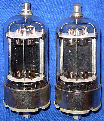

Here are some pics of mica insulators for TV Sweep tubes.
I'm sure that the mica can provide a leakage path inside the tube from G2 to G1. So can "gas," the less that perfect vacuum that's found in most modern new production tubes, and a fair percentage of the 50+ year old tubes we play with.
Even in a box on a shelf, the vacuum inside will eventually collect a minute amount of contaminants from air leakage, and the imperfect nature of the internal components. Then we crank them up and make them hot, adding to the cloud of "gas" inside. A voltage potential between two metal elements in a gaseous environment of less that atmospheric pressure will cause some of the "gas" to be ionized in a manner similar to a neon light. Then there will be an unwanted path for current to flow.
As stated some of this will be from G2 to G1 since they are very close together. This current will cause the voltage on G1 to be pulled in a positive direction cancelling out some of the negative bias, causing tube current to increase, generating more heat. More heat, more ions, more unwanted current.......runaway happens.
This is why the tube makers publish a "maximum grid circuit resistance" spec. The lower the grid circuit resistance, the lower the change (in the positive direction) in grid voltage caused by the unwanted current paths (mica and vacuum contamination). This spec is often ignored, or purposely violated in the quest for more gain (especially in guitar amps) and is the main reason for random tube meltdowns in an otherwise good working amp.
Both of the contamination mechanisms cause accumulation over time, so that shiny new pair of new production Tung Sol KT88's may be fine for the first year or two, then randomly go bang down the road. Particularly if run hot. So if you are going to lean on a tube in an amp design, keep the grid circuit resistance down. A mosfet driver is excellent here for grid voltage control, since the voltage can not creep up.
I'm not familiar with the EL51 since they are rather uncommon here. The 7403 is the Bendix version of the 3D21WB (not 3D21A or 3D21WA) which used to be relatively common in military surplus. Unfortunately many of the surplus tubes are gassy and will runaway.
7403/3D21WB and EL51 appear to have ceramic supports, rather than mica. Different ballpark.

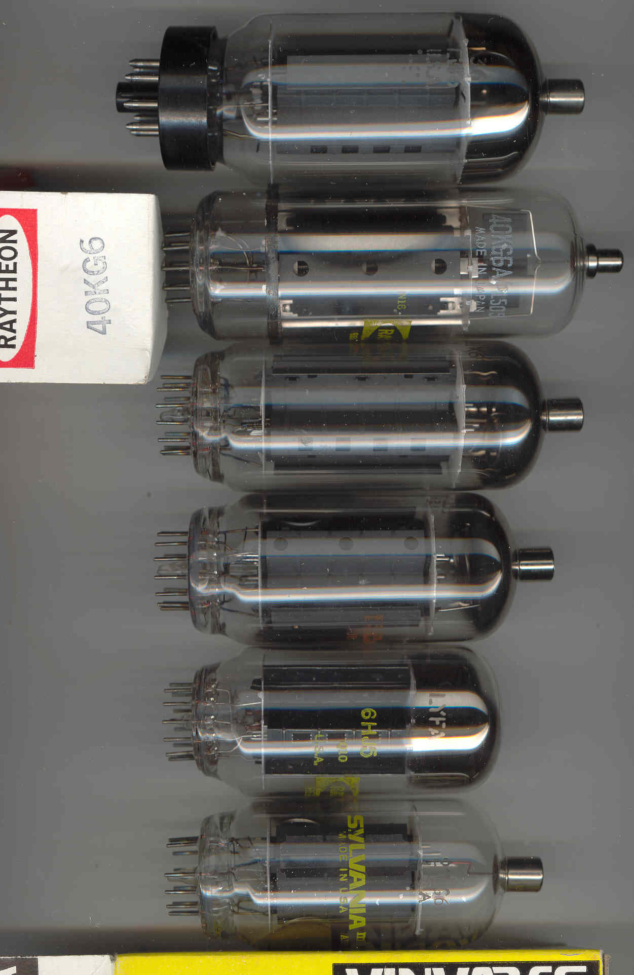

Some TV Sweep tube pics, with the 40KG6/PL519 for comparison.
From bottom to top: 21LG6A, 6HJ5, 35LR6, 26LX6, 40KG6, 36LW6
I have some of these Matsushitas. I have disasembled one dud some time ago and if I find it I take some photos of the internals.
In my PL509 collection the Philips PL509's have stronger gain and emission, but Matsushitas are equally reliable and stable.
