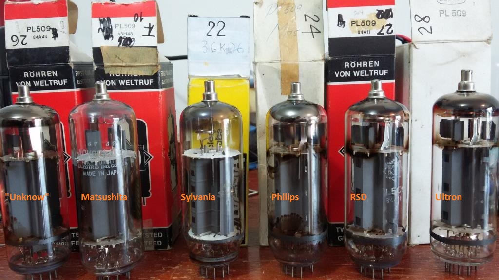

Very good! time to make some new measurements (but I have said this since late November :mad::eek: so no one will believe me :D )
Some business take all time (including my new purchase, the locky-z transistor tracer***) but with this new data I will find some time to take new measurements. Easy now since I have purchased some russian Magnoval sockets and arrived last week.
I will experiment this values in some different PL509 brands (I have Matsushitas, Philips, RSD, Ultron and Sylvania)
***good to have a transistor tracer and make some peace of mind about device curve linearity and then tube don't look too bad, after all :);)

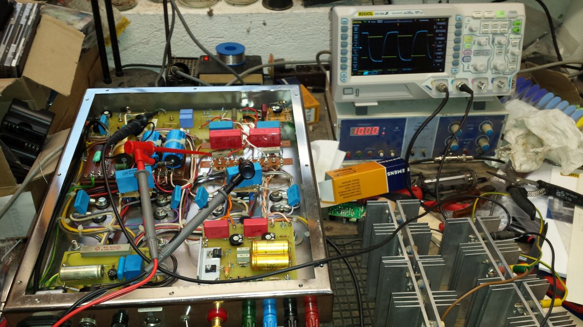

This week I had both my Circlotron monoblocks, built in 2001, on the workbench again for an overhaul. I replaced the worn-out PL519s and did some modifications in the NFB in order to increase stability on 8 ohms loads. As the 4 ohms terminal is grounded, with '0' at one side and '8' and '16' on the other, while '0' and '16' provided NFB to the symmetrical driver, there were huge oscillations if a load was connected to '0' and '8' by wires loger than 1 metre. Now this symmetric NFB comes from the OT's outer terminals, i.e. the PLs' cathodes. Output power is slightly more than 100 watts.
Some pictures. We see a 10 kHz square wave, right before clipping:
