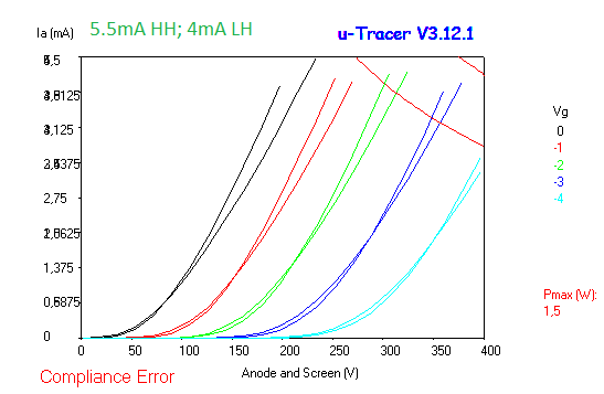

...and finally the fialment examination in superposition
Well, this is more "tense". One slight error and one needs to remake all measurements :mad: (occurs several times)
And is necessary to make one, play with it and repeat to precise one-time adjustment or becomes a big mess
Thanks smoking-amp by suggesting this, so I insisted in subject and obtain a more clean graph
In section one (the high-µ), is impossible to match. With low heater, the curves become more J-shaped. With high heater, the curve become more /-shaped. I bet some HD (distorition) change, maybe even dramatically, but I prefer to play with a preamp and my FFT first...
In output section, the change is small, but the J-/ behaviour is the same. is easy to see when the tracer are making the curves.
Interesting...
Remark: the tube tested here is a 6EM7 GE coin base NIB NOS (is a other sample, not same from previous 6EM7 graphs)

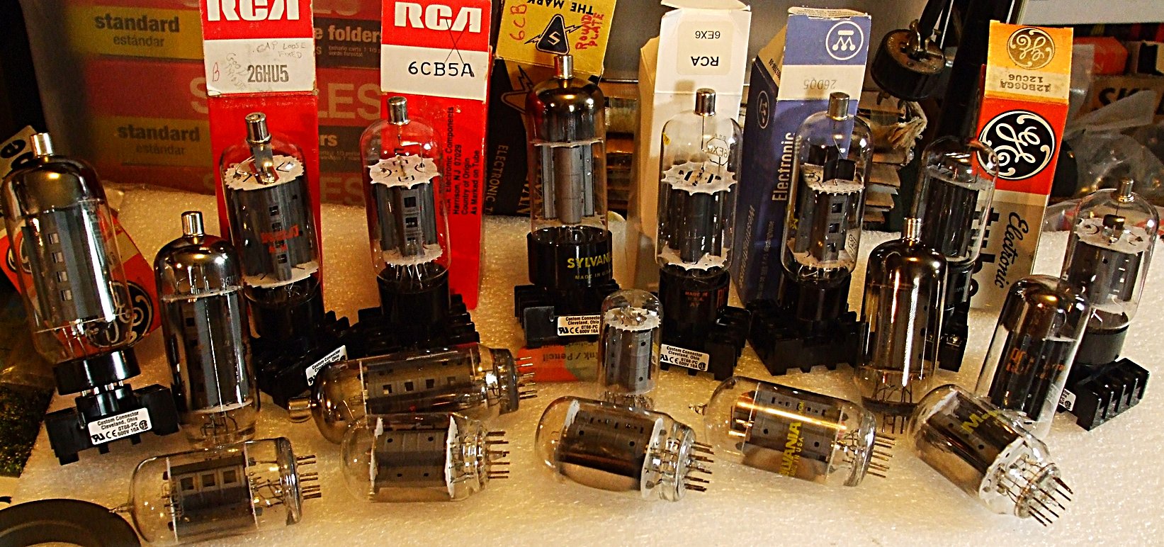

That earlier 4D32 design didn't look too likely for Crazy drive either at 300 Volts spec'd for g2. But I guess they only wanted 6 Watts from the 50 Watt tube.
The TV Sweep tubes work like wonders though, using Crazy drive. All those cheap $1 TV tubes I got way back are looking WAY better. :) :) :)

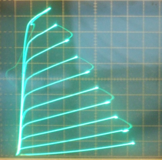

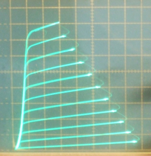

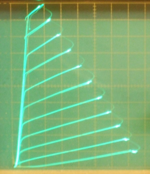

Looking at the 26LX6 Crazy drive info, around 2.7K from g2 to g1 and around 1K from g1 to cathode worked. (Rg2g1 usually in the 4K to 2K range, and Rg1k usually in the 2K to 500 Ohm range) Probably a good ballpark resistor set to start with for the PL519 in Crazy drive. Be careful not to overdrive grid 1 in the now positive territory. Some current measurements of grid1 with a DVM can indicate average current and voltage (+ with respect to the cathode). Doesn't take much resistive grid 1 drive to linearize the tubes, no need to get grid 1 hot at all.
You will need some N Fdbk somewhere to lower the output Z of the amplifier, Crazy drive looks like a pentode output in it's native mode. A simple local resistive Schade Fdbk network to a pentode driver plate could help, but the g2 drive or Crazy drive approaches have 1/Mu reduced loop gain (around the output tube only) versus normal grid 1 drive. So a local loop may require N Fdbk to the driver cathode(s) to pick up enough gain. Of course global N Fdbk alone could work too, or could supplement simple Schade Fdbk.

I think just 2 PL519s will give at least 150 Watts output (using maybe a 3.3K or 2.5K Zprimary) from what George has said before. Using 4 of them will double both grid gm's, so even less driver voltage swing would be needed. I would guess that just 2 PL519 could drive the 2200 Ohm P to P OT. (one PL519: 500 mA max DC current, 1500 mA peak DC current using +185 Vg2) Of course, lower current per tube will last longer. Seeing as Crazy drive gives near perfect output tube linearity, you may want to listen to the amp for a while longer. :)
On the op-point:
g2 drive amps usually operate closer to class B with high efficiency. So I would guess Crazy drive can do similar. This all depends on how the P-P tube characteristics overlap around crossover. Some testing needs to be done with Crazy Drive to see how well crossover is handled, and so how low the idle current can be. But I expect some idle power economization will be possible over usual class AB setups.
Looking at typical Crazy drive plate curves, they give near constant effective gm over the full current range (except at very low currents). So setting the idle current too high in P-P could produce gm doubling in the overlap range. So the optimum P-P conduction overlap range is going to be smaller than for typical class AB. Hence, lower idle current expected for best results. Some tweaking of the Rg2g1 and Rg1k resistors may optimize the overlap region too. On the other hand, a little selected gm doubling could overcome the low permeability of typical OT steel cores near crossover. FFT analysis called for.
