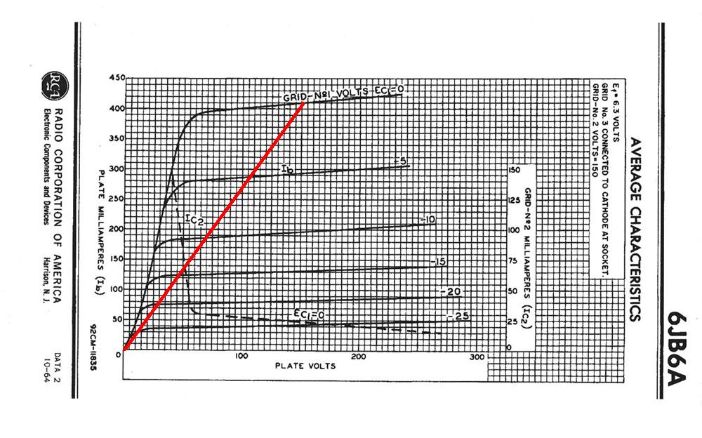

First Approximations
Since the G2 voltage is given on any set of pentode curves a very good first approximation can be made of the triode zero bias curve. That originates at the origin & projects to the point where plate & screen volts are equal. See attached.
Then draw in something adjacent that looks like the 3/2s power law if we like.
Power dissipation & load lines can be drawn in for a rather good estimate of power out & so on.
Always worked for me. Might be useful to some here. But a set real curves would certainly be superior.🙂

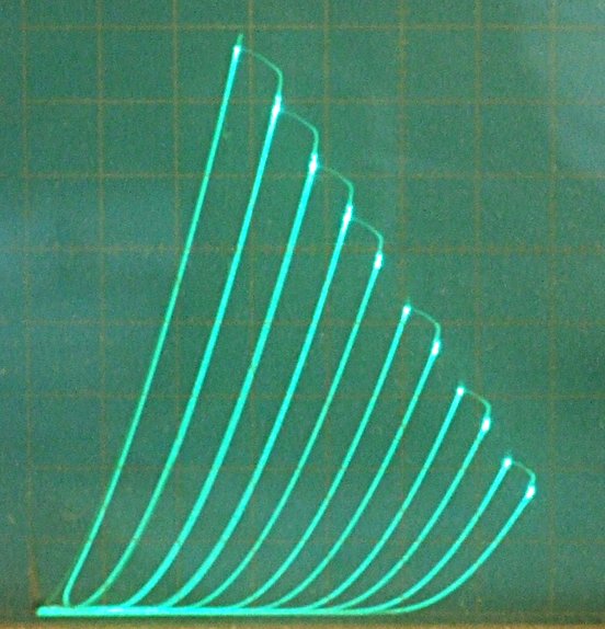

Here is the 12GT5 (ie, 6JB6) in triode mode. 50 V/div Horiz., 50 mA/div Vert., and -7V steps on grid 1 from 0V. This was a GE tube.
6MJ6s I don't have. The RCA JEDEC datasheet for them says they are an ultra-reliable field replacement for 6LQ6 and 6JE6. (and 6ME6) Should be curves around for those. It also has almost identical specs to the 21/6LG6 (GE's version). Curves are around for that. 21LG6 and 6JE6/6LQ6 look identical on the curve tracer. A $4 replacement for 6LQ6.
