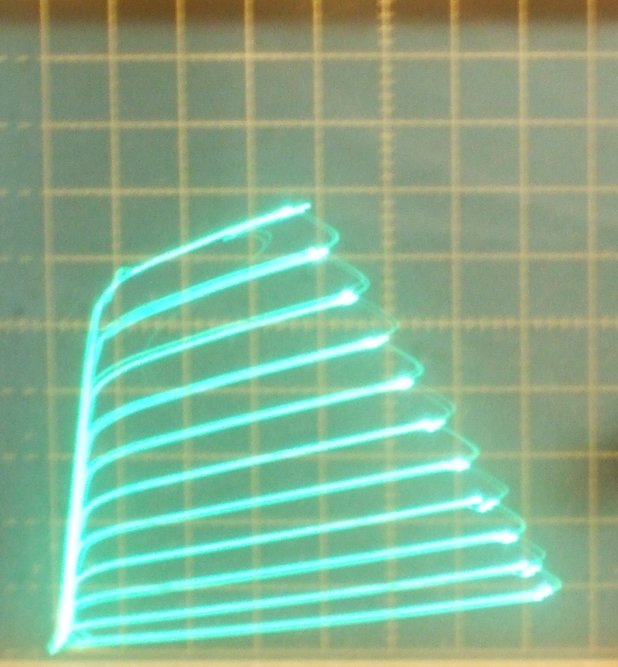

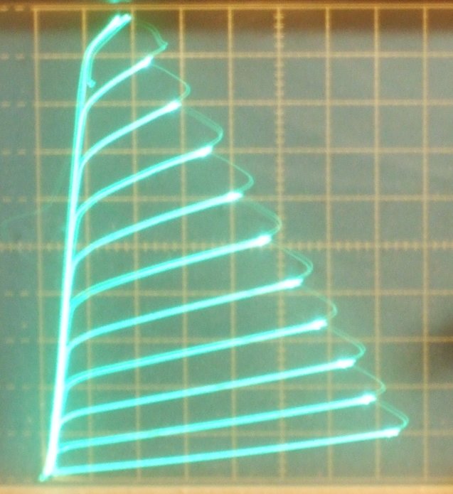

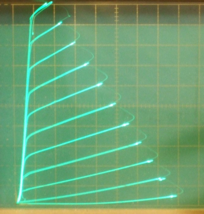

I haven't done any actual dist. measurements, but just from looking at the plate curves I'd say it removes from 50% to 90% of the 2nd harmonic curvature (depending on tube type). The lack of curvature remaining, even with-in the individual plate curves, as well as the very monotonic spacing between the plate curves, bodes very well for reduced higher harmonics.
Combine that with the reduced g2 drive swing required (about 23% less for 26LX6), making for much safer operation of the tube, and this is clearly a BIG WIN over normal g2 drive. That also leaves a little more loop gain for any Schade Fdbk added.
50mA/div., 50V/div
for the same plate current span:
1) 26LX6 Crazy Drive 5.4 V steps
2) 26LX6 g2 drive 7 V steps
for the same total drive swing:
3) 21LG6 Crazy Drive 7 V steps
4) 21LG6 g2 drive 7 V steps
50mA/div., 50V/div

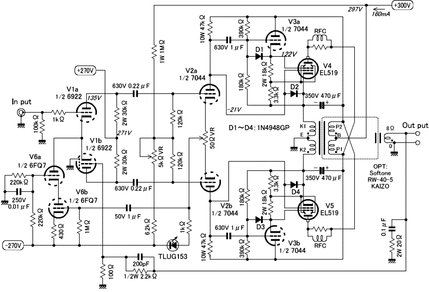

"what about this amp , from EVO"
The output stage is running grid 1 drive with CFB (50% CFB, Unity Coupling?) with the g2 and g3 grids effectively bootstrapped above the cathode to prevent any UL effects. (preserving constant voltage from cathode to g2 and g3) Also bootstrapping the 7044 plate loads.
CFB and Unity Coupling are interesting, but require a special OT. Pretty much the same effects can be obtained just using local feedbacks to the driver stage for conventional OTs. (Schade scheme, or Fdbks to driver cathodes or crossed Fdbks to driver grids)
The most interesting part:
An interesting arrangement in the front end, with a common mode control loop from the 7044 tail to the 6FQ7 cascode current source (which is the tail for 6922 diffl. input). This keeps common mode drive effects out of the final stage, likely making it more efficient (avoiding some, but not all, CM currents in the OT) and helping to keep the output stage linearized somewhat (less gm variation at peaks). Effectively acting like an interstage xfmr, but without the phase penalty. These may be the mysterious effects that are appreciated in the sound of an interstage xfmr. (CM rejection sorely lacking in some capacitor coupled amplifiers, ie, lacking a CCS tail for the driver.) (this more complex loop here -might- avoid 3rd harmonic effects of a CCS tail for just the driver stage, by introducing complementary CM distortion of total gm in the input stage. Simulator test territory, adjust CM loop gain for least 3rd harmonic.) I would recommend saving a copy of this front end design. Well worth trying at least. (a SS controlled current source tail could avoid the requirement for -270V)
No you won't. Look at where the plates of the 7044 are. That VT is "sunk" below ground to put its plates at -21VDC to bias the finals. You could replace the 6FQ7 cascode with either a pentode or cascoded transistors that could handle the negative rail voltage.
Other than that, the front end looks to have borrowed somewhat from o'scope vertical deflection amp practice.
Running the 7044 plates directly coupled to the outputs looks dangerous for the health of the output tubes without some type of servo anyway (power supply drift, aging). I would eliminate that part, then the differential tails can be conventionally lowered to SS CCS neg. levels.

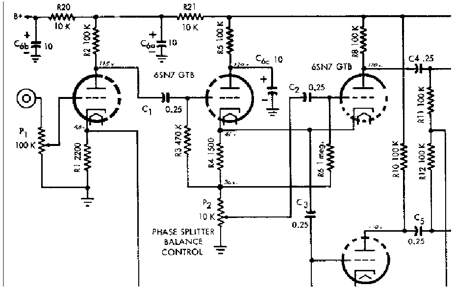

"I would put an AC adjust pot in the driver loads, for SET 2nd H sound, as an option too".
Then how about the attached phase splitter? This one already has a balance adjust that could be put on the front panel as an extra twiddle knob.
A schematic drawing would be nice
Okay, I know this looks trivial, but would you post a simple schematic drawing about the connections? Just to be sure about what I'm reading.

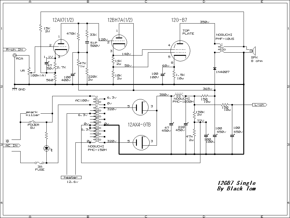

Jazbo8 found this schematic (1st pic below) online. (posted in ""Low" B+ Voltage Amplifiers", post 60) It has the correct connections for Crazy drive, although the 14K and 10K resistors below the 12BH7A cathode follower are probably too high in value to get much linearity correction. I'm guessing this design used this approach mainly to boost the effective gm, above gm2 alone.
And the original schematic find, by AJT, of this similar configuration (likely from MJ magazine) is the 2nd schematic below, a 4D32 SE with CFB. Here, the 3.3K resister below the 6V6G follower is much more like what I've found for linearization of TV Sweep tubes. However, the 4D32 is a HV screen grid tube, with zero bias grid1. So I'm not absolutely sure how well it is performing in that design for linearization. It may actually want a higher value resistor there. But its in the ballpark for sure. I don't have one here to test on the tracer.
I should be able to get one of the 12G-B7 tubes to test cheaply though.
We would more likely use a Mosfet follower these days, but nothing wrong with a tube follower (except a floating heater).

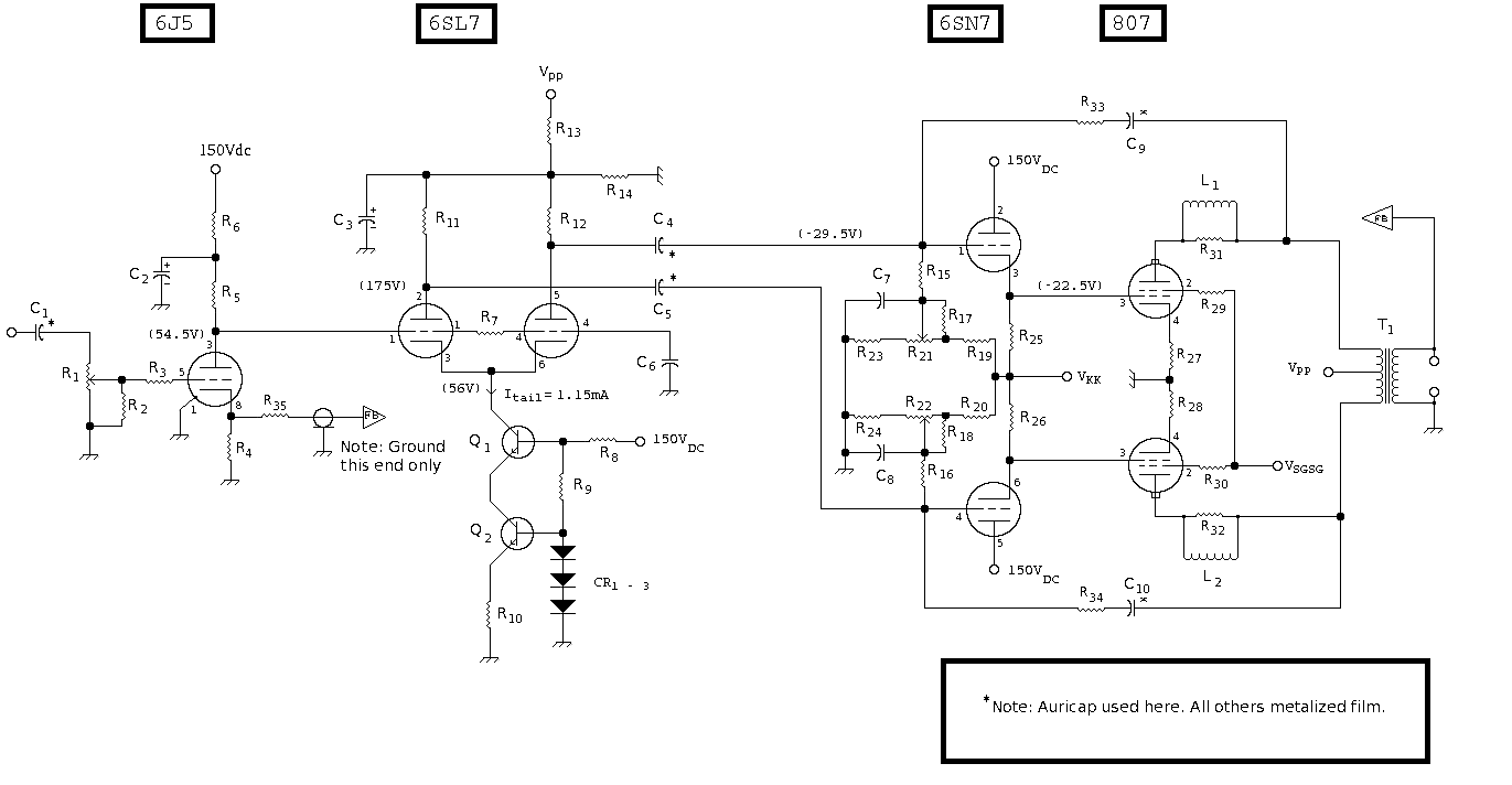

The oldest occurrence of this g2/g1 drive scheme appears to be this article in RCA Ham Tips:
"RCA-807's, used as zero-bias class B modulators, will furnish enough high-quality audio to fully modulate a quarter-kilowatt transmitter!"
http://n4trb.com/AmateurRadio/RCA_Ham_Tips/issues/rcahamtips0702.pdf

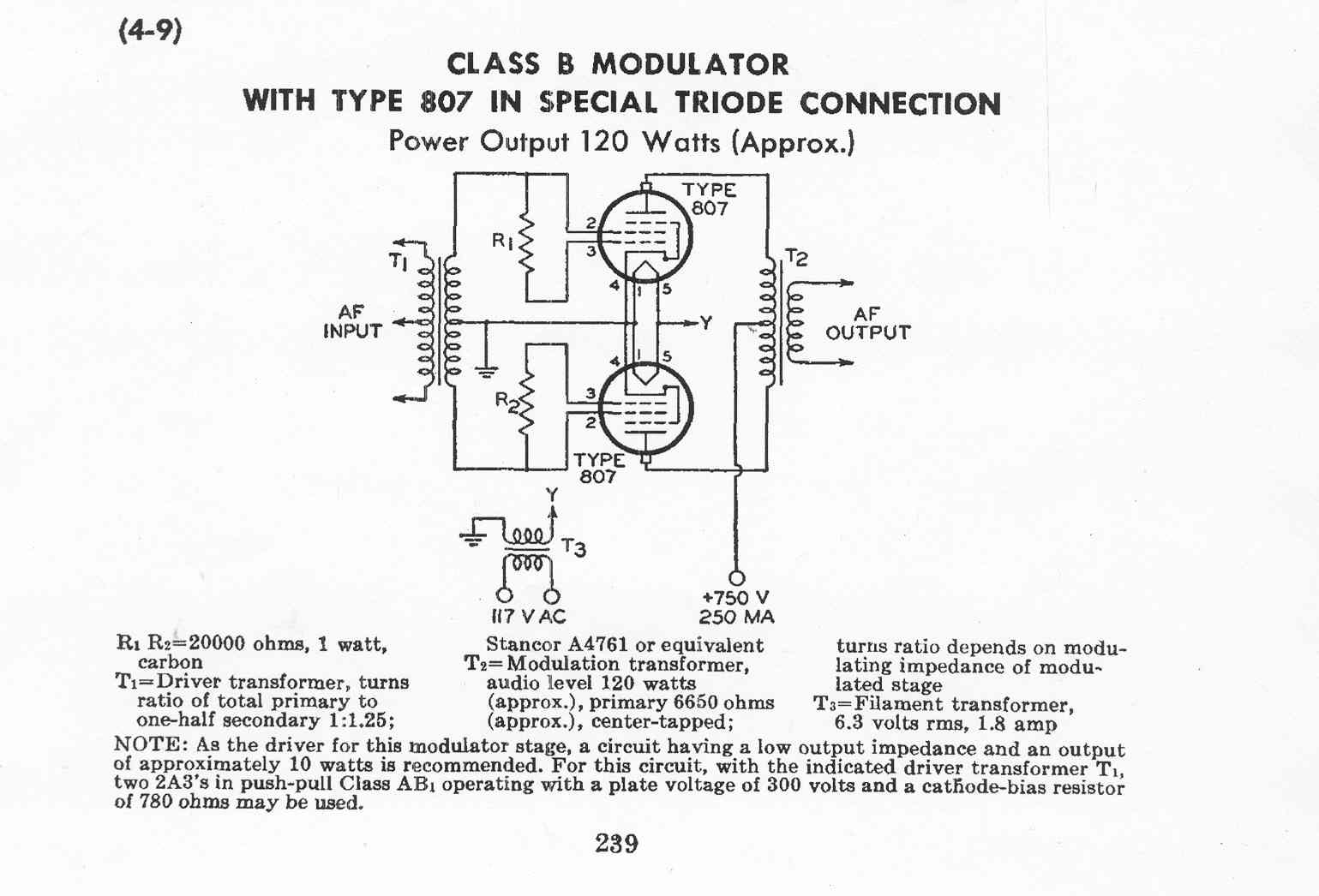

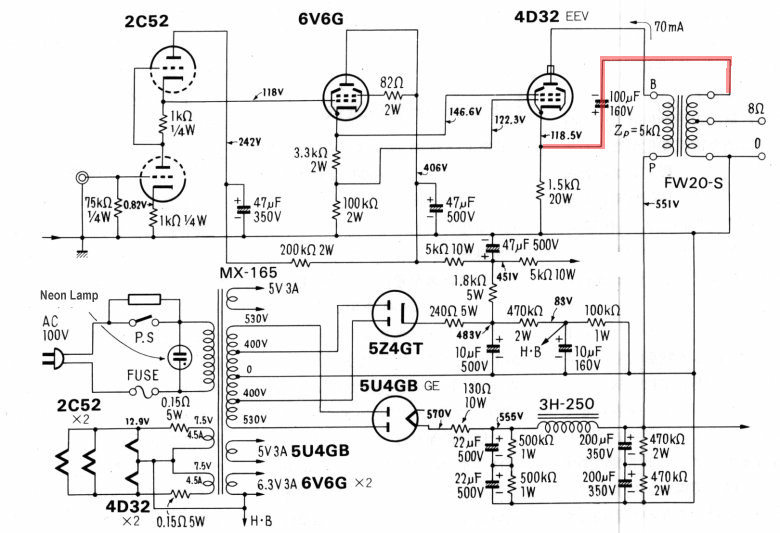

and the RCA transmitting tube book "Special Triode Connection" TT4 (1956) page 239 below:
(notice they are using 20K Ohms for the R1 and R2 resistors, rather high for any linearization effect I think.)
The RCA Ham Tips article was from June 1947. So that's the earliest reference found so far. Could be something in RCA's reseach journal.... you would think we would have heard more about it then.
