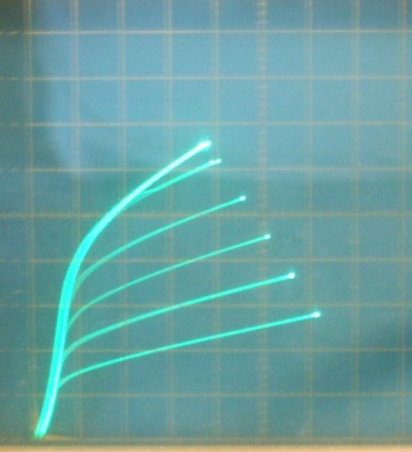

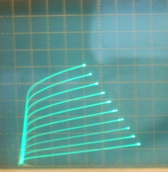

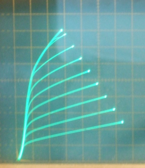

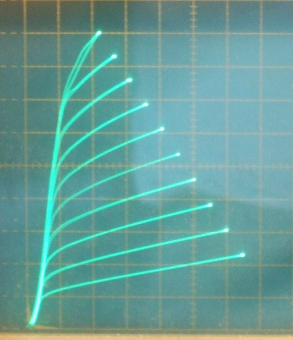

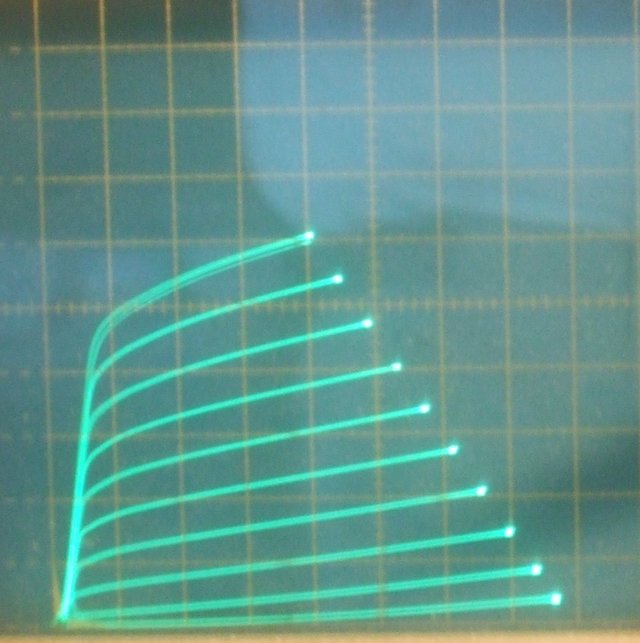

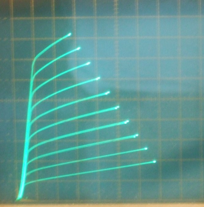

Crazy Drive Tuneup
I ran off some 6HJ5 curves with different Rg21 values. (Rg1k was around 10K for all) (6DQ5 is very similar to the 6HJ5)
These were all at 50 mA/div Vert., 50V/div Horiz., and 5.4 V steps on g2 down from 68V. (except g2 only drive and pic 2 were at 6.5V steps)
1) g2 drive only (6.5 Vsteps down from 68V for this one)
2) Rg21 = 19700 Ohms (6.5V steps down from 68V)
5.4V steps for these:
3) Rg21 = 2750 Ohms peak Vg1 = 1.7V peak Ig1 = 5 mA (so like 8 mW peak diss. for g1)
4) Rg21 = 1780 Ohms peak Vg1 = 5.0 V peak Ig1 = 30 mA (so like 0.15 Watt peak diss. for g1, average would be about 1/4 of that) (this is the type curve set I select for)
5) Rg21 = 700 Ohms peak Vg1 = 10V peak Ig1 = 140 mA (1.4 Watt peak diss. for g1, NG)
6) Rg21 = 600 Ohms peak Vg1 = 14V peak Ig1 = 180 mA (2.5 Watt peak diss. for g1, NG!!)
7) Rg21 = 350 Ohms (didn't measure this one, takes too long, might poof it)
The Rg21 = 1780 Ohms is the region (well, this type of curve) I typically selected for the resistor values posted earlier.
Higher Rg21 Ohms reduce the gain (peak current) but seem to still do well at linearizing the curves. More peak Vg2 needed to reach the same plate current. 2750 Ohms and above seems to be where most gain effects from g1 drop out, but linearization effects seem to extend up to the 19700 Ohm level.
G2 only drive lacks the obvious linearization and requires the most Vg2 drive to reach similar plate current.
Lower values of Rg21 start to significantly increase the heating of grid 1 and eventually produce gross distortion at high plate current as seen. (g1 absorbing the plate current at low Vp)
So some current limiting for the Mosfet follower(s) is a very good idea when adjusting Rg21 for distortion or gain.

Changing the other resistor (for Crazy Drive) Rg1k seems to mainly effect the curves in the 0 to 50 mA plate current region (effects the gain there).
Some tubes seem to develop a gain bulge in this low current region, and a lower Rg1k (about 2X Rg21 typically) seems to fix that. Making Rg1k TOO low however, will lower the gain for all the curves. (knocks out g1 effects)
Occasionally I found a tube that also needed a small voltage offset from 0V (or cathode V, typically 0 to -1.5V offset needed) for the bottom of Rg1k to fully fix the low current gain bulge. I would guess this is due to some thermo-electric offset in the tube from dissimilar metals bonded.

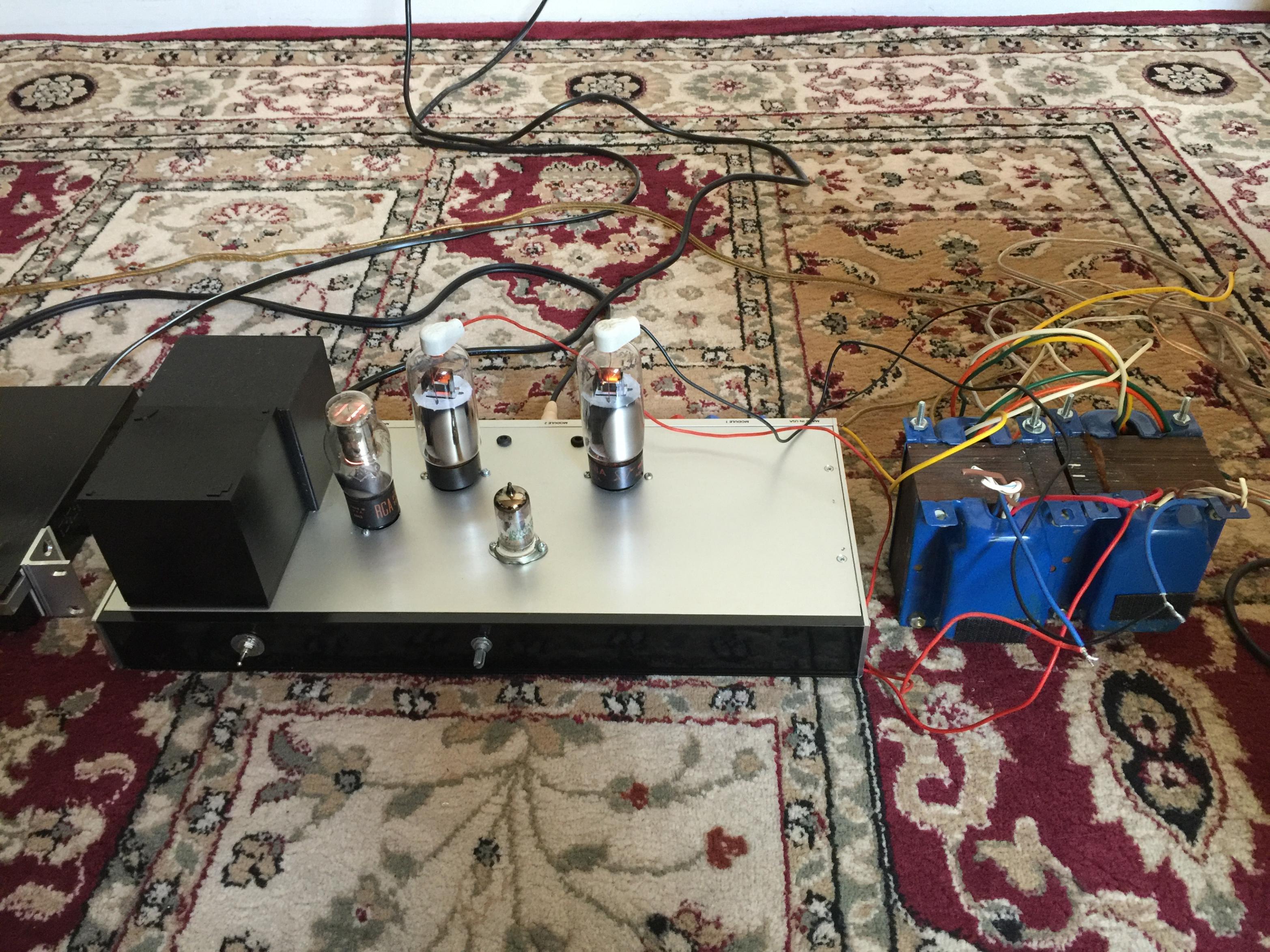

6CD6 amp. As straightforward as a stick. Pentode output, regulated screen grid supply, cathode self-bias. 33W each dissipates. Sounds fantastic without any sneakiness. Almost 10W on onset of a "round" clipping. Waiting for transformers, Westons promised to ship them June, 22..... waiting....
