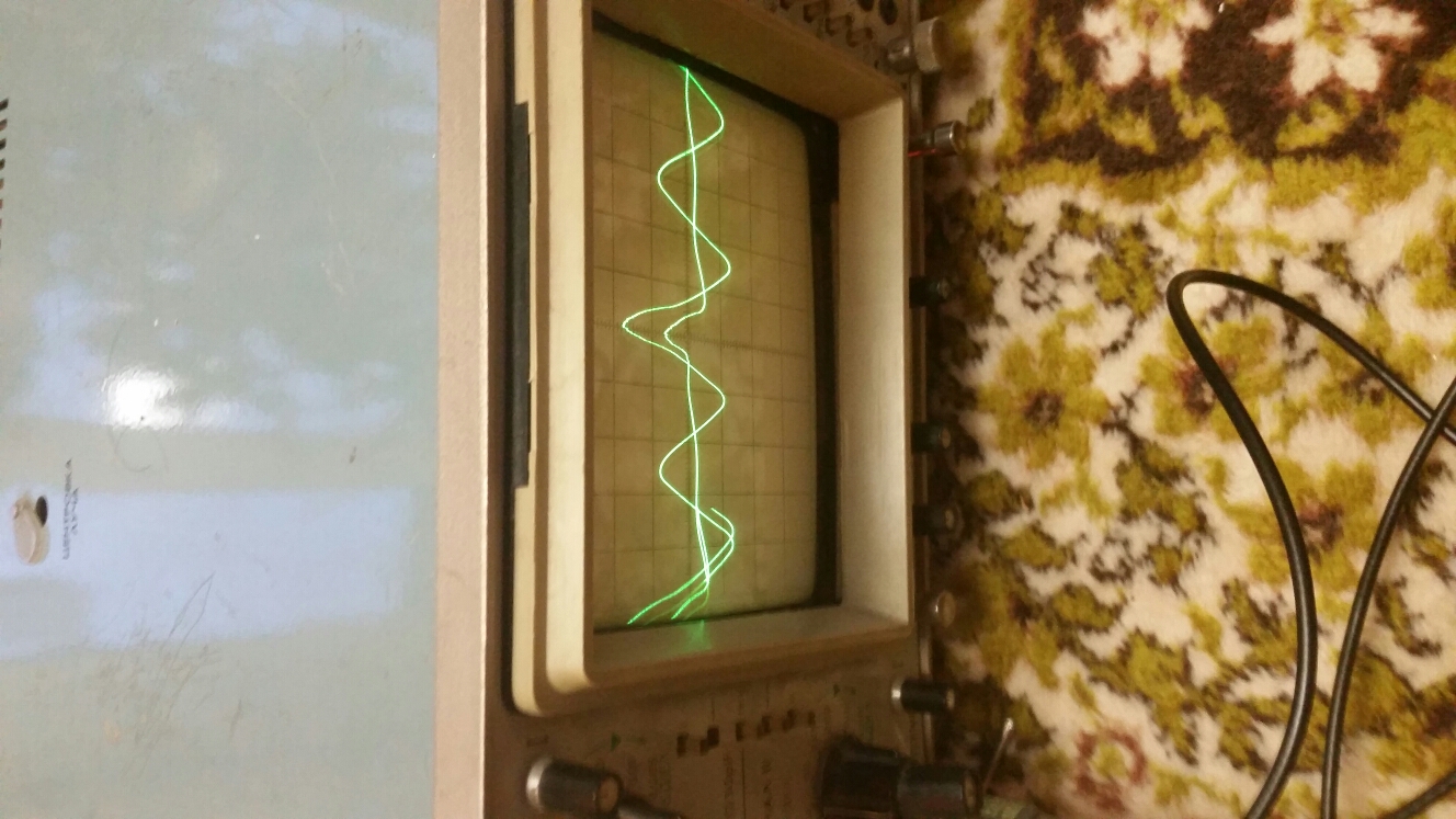

First the last question about the 1st pcb. Why on the C3 is a steady voltage of 13V? If there is a crack it should be 0V i think?

Lets try and explain this to you in such a way that you might be able to fix it.
Use the point arrowed as your ground for all measurements. This is the point where the middle wire from the transformer enters the board. It is important you make sure that the wire from the transformer connects securely to the board. This is where your black meter lead connects for all the measurements.
You now measure the voltage on C2 and C3 as shown here. Measure first using a DC voltage setting on your meter and then change to AC voltage setting. You MUST measure on the actual leads of the components and not on the PCB. That is to make sure continuity is perfect all the way to the capacitors.
In BOTH CASES the voltage should be zero (0.00 volts).
Now set your meter on AC volts and measure the voltage on the bridge. You MUST measure on the bridge leads directly and NOT on the PCB. Again, this is to confirm continuity all the way to the bridge. You should see around 14 volts AC on each point.
Now measure the DC voltage here. You should have around 20 volts DC. Again, you MUST measure on the bridge lead itself AND NOT on the PCB.
Now measure the DC voltage on C3 as shown here. It should be identical to the reading you measured above. Again, you MUST measure on the component lead itself and not on the PCB.
Here the results (everything from the ground):
1)
DC C2+ 0.01mV
DC C3- 0.04mV
AC C2+ 0.032mV
AC C3- 0.035mV
2) AC
bridge ~1 15.2V
bridge ~2 15.4V
3) DC
bridge minus - minus22V
bridge plus - 12.85V
4) DC
C2 minus - minus22V
C3 plus - 12.85V

So bridge is the first that gives me lower voltage than it should be (12.85 instead of 22V)

Excellent 🙂 now lets see this through if we can.
Based on those readings (very clear, thank you) then either the bridge or C3 appears to be faulty. Now its 50:50 which it could be. The easiest way to prove it might be to eliminate C3 from all this and we can do that by tagging another similar cap across it. Do you have another cap of around that value (anything over 1000uf and 25 volt) ?
Don't remove it or disturb anything if possible, just tag it across C3 and retest.
Yes, with 14 volts ac going into the bridge it should be giving over 20 volts across C3. If the bridge has gone high resistance then it would cause this and also if C3 was open circuit it would do the same.
So we have to prove which it is now.
Another 'engineers trick' which might give you a clue but it isn't guaranteed is this......
When you switch off, does the voltage across C3 fall away slowly or does it suddenly drop to nothing. If the cap was open it would drop to nothing instantly.

I have 1000uf cap behind me. Should I solder it to the points of C3 instead of it or in addition to the old one?
It will do no harm to try it. Just lightly solder it across C3 leaving C3 in place and undisturbed.
Not unexpected, but its further proof.
Change the bridge. I'm assuming its not getting hot in all this.
