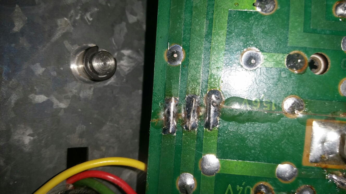

Some posts back I saw a PCB with a crack that looked like it would interrupt the traces as well. The proper way to mend a broken trace is to solder wire across it, or to run an insulated wire from the closest solder pads on either side. To mend a crack by soldering, you clean the surface of the trace in order to accept some solder. Apply a little solder flux (not plumbing flux, liquid electronic solder flux). Apply a little solder to each side, then "tin" (apply solder to a surface) a lead of solid wire, like a component lead you may have clipped off. Then, bridge the defect with the lead (hold with pliers or tweezers) and solder it to each side. I did not see that repair except on one trace. I think you used solder wick to cross the defect.
If a crack runs across a trace, assume the trace is broken. Even if it isn't now, it will probably fail later on in time.

You can easily have intermittent connections with a cracked PCB. I would highly suspect this is the case. Note that intermittent connections can be highly sensitive to vibration or changes in position.
We have told you how to find a crack in a PCB a few times now. Please, go back and read this thread again. There was no need to replace that rectifier. Your fault could not have been that part. It sounds like you have problems on the circuit board.
I did see a crack in a PCB in one of your pictures. It looked like it was glued together, but there were not enough repairs made to the traces. If I were you, this is where I would start looking. Always assume there is a problem if you aren't certain about something you did.

Could we put away this PCB? I couldn't find a problem. I have only 3V on the C3. I soldered all the cracks with the solder again but nothing changed. Let's put in aside.

Keep on this board. You have just started to service it properly, forget everything you did before - especially anything you "know" to be true. That is one of your problems.
You could also have broken solder connections to components near where the board is cracked. Those trace repairs are good. To fix a broken solder joint, remove the old solder and make sure the lead isn't broken (it can happen where the lead breaks just above the solder surface in the PCB).
So, make sure you repair all the traces that could be broken first. Don't get ahead of yourself like you are doing.
-Chris
How about further along the crack on the board? You should also drill a round hole at the tip of the crack so it doesn't continue to grow.
