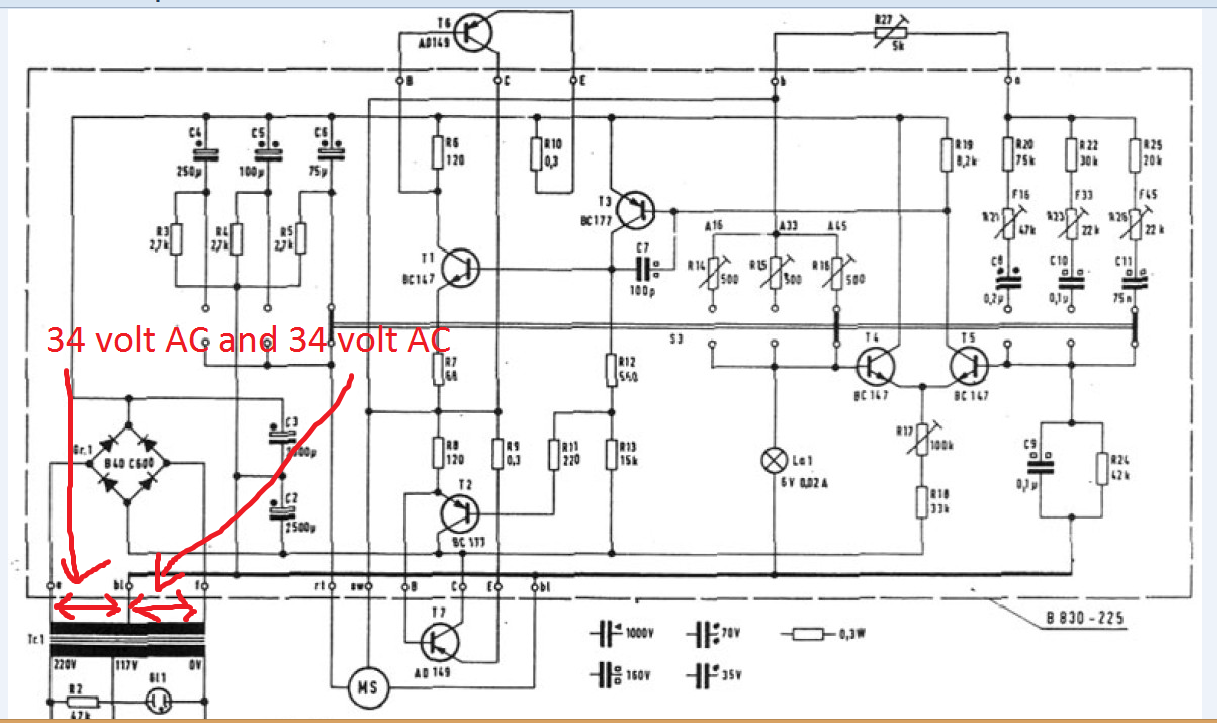

On the second 2bridges PCB version there R10 T6 T7 also isolated and there is voltage of 0.67V on ala the directions! while the other bridge give me perfect results like it's written on how to check the diode bridges.

34V everywhere
2/ Switch on and now read the AC voltage on the other two transformer wires at the point where they enter the bridge.
34V everywhere
On the TWO bridge version it's
I removed R10 and R6.
1st bridge 10V AC
2nd bridge 18V AC
between the c2 c3 voltage is jumping very fast from 0 to 34V

Lets concentrate on this one.
If you have 34 volts AC on each of the two transformer wires with respect to the centre wire... that is what you are saying... then you should be seeing 48 volts DC across C2 and 48 volts DC across C3 which is crazy 😉

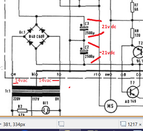

Wires from the transformer give me 16V each (it's jumping 15-16V)
bridge is working perfectly. What is next?
Everything is on the PCB ONEbridge version.
15 to 16 volts AC sounds OK for the transformer voltage.
Switch your meter to DC volts and keep the black lead on the junction of C2 and C3 as before.
Now measure the voltage to C3 positive end (should be around 21 volts DC) and also the voltage to C2 negative end (should be around minus 21 volts DC)
We (me 😀) are going to have to leave this for tonight but your reading of 13 volts is much to low. The minus 22 is good, the plus 13 is not.
A couple of things could cause that. The reading of 13 volts is like you would get if C3 was open circuit.

I'm sorry, I was going cross eyed keep looking at these diagrams last night and had the C2/C3 and R9/R10 mixed up.
Go back to your reading of 13 volts across C3. That is a wrong result and means either the cap is faulty or the connections to it are broken or there is some strange problem with the bridge.
You have 14-0-14 volts AC applied to the bridge. That must give you 21 volts DC across each cap.
C3 + have no connection to R9

Look at the diagram above. You are trying to confirm (or not) that those four voltages are as marked. All can be measured with the black meter lead on C2/C3 junction.
This is to try and find why you have only 13v dc across C3 when it should be nearer 21 volts dc.
Voltage to C3 positive end - 13V This voltage is wrong. We need to find out why
voltage to C2 negative end - minus 22V
