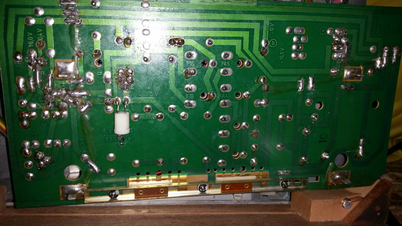

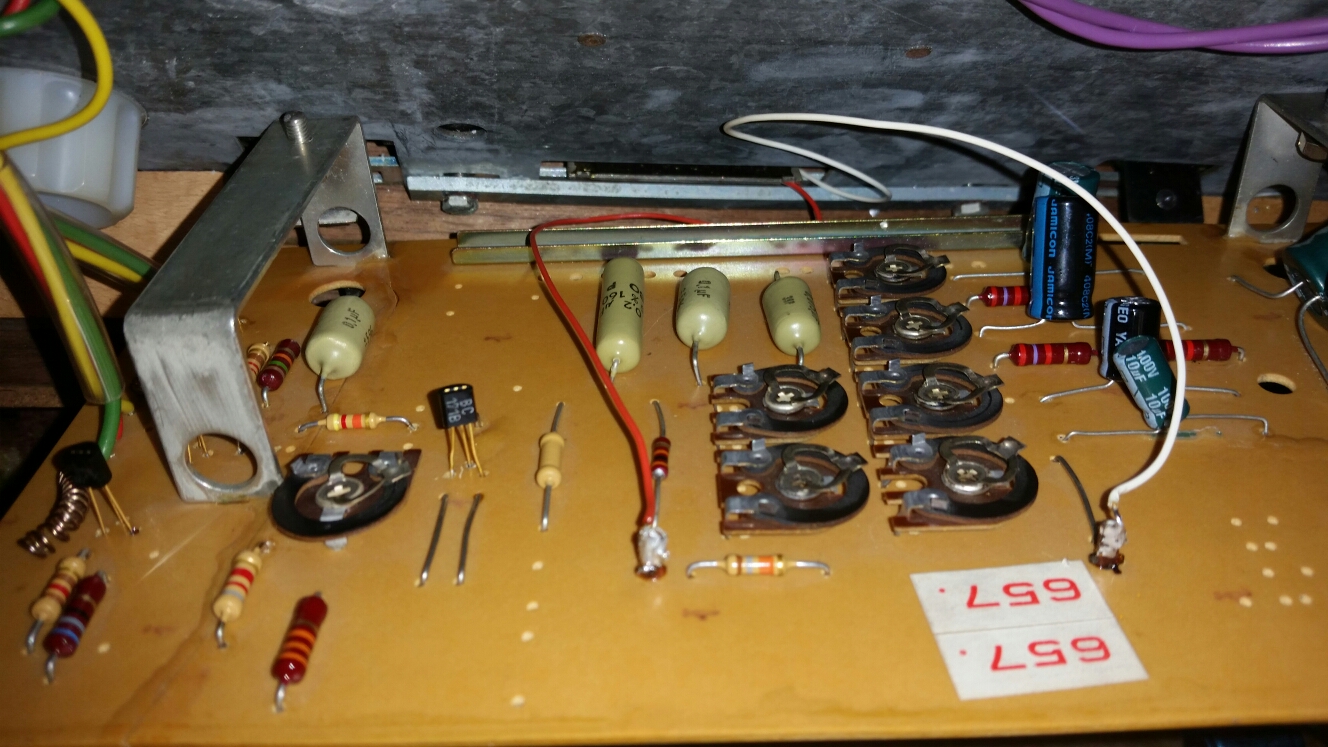

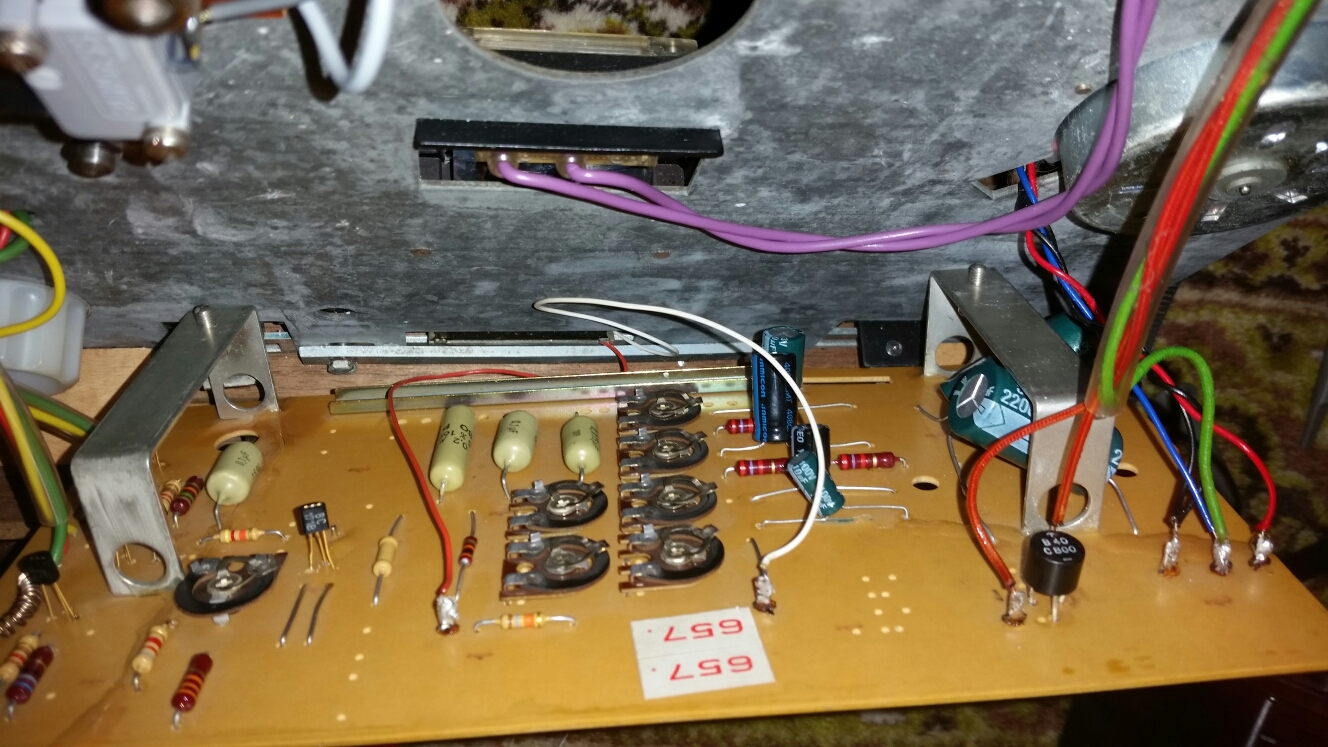

Hi terrom,
Can you take a picture of the area you worked in please? Both component and foil sides.

Hi terrom,
Can you clean the flux off that board so we can both really see it? Use lacquer thinners and a soft toothbrush. Make sure the fluid is away from the switch and any controls. Don't flood the board. The removal of the flux will allow you to actually see cracks or hair like shorts.\

The only thing that is hot is the R10 resistor. I also think that a transformer should be coller. It's warm but in a working example it seem to be cooler.
Al also changed T6-T7 to another pair. Nothing has changed. Also removed the switch complitely. Have the same voltages.
T6 disconnected. Now C2 is 24V and C3 is 22V. Voltage is back!
