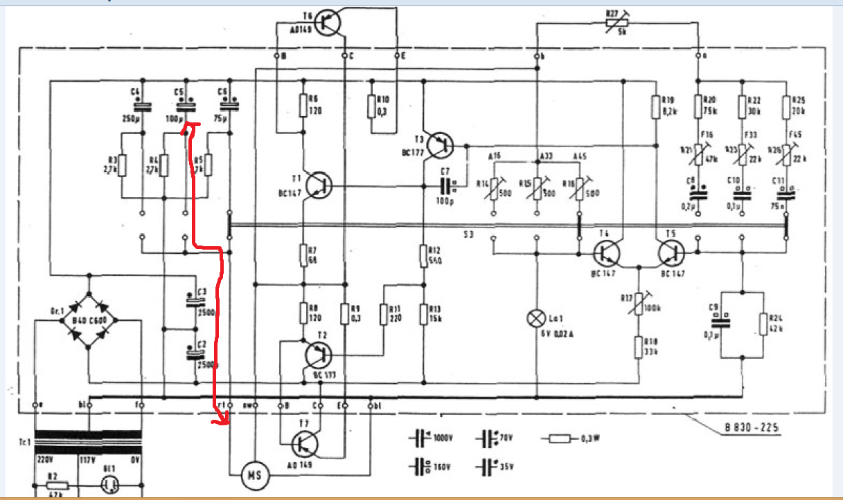

To confirm it I've just tried another motor. Result is the same. 22V + 13V with the motor bit it was 22V + 22V without the motor on C2 C3 and the bridge

across R6 is 0,7V DC, R7 - 1V DC
0.7v means T6 is fully on. I actually suggested it would be around 0.2 volts but of course the volt drop across R10 is adding to the base/emitter drop of T6.
across the base/emitter junction of T1 minus 0.7V
If the red meter lead was on the base and the black on the emitter then yes, that is also fully on.
across the base/emitter junction of T3 0.65V
Again, that suggests it is on.

I want you to look at the circuit and put the speed switch to the middle position. Now put your meter on DC volts and measure from the negative end of C5 to what is the left hand connection to the motor on the diagram. There should be zero volts. This is to test for continuity through the switch.
Look at the circuit again.
This time switch it off and put your meter on ohms (to check continuity). Connect the meter between T5 base and the end of C10 that goes to the switch. It should read 'short circuit' or very nearly zero ohms. This is to test for continuity through the other section the switch.
I have 9V DC. One lead to the C5 minus and the other to the motor as rugular?
to the RT point (red wwire of the motor) is 0V
It gives me 0.3Ohm and I have a beep sound so it have connection T5 base - C10
That needs looking at closely. With the switch in the middle position these points should be linked (if the diagram is correct)

I'll have to give it more thought because its defying our best efforts at the moment.
The whole circuit is really just an amplifier with a long tailed pair at the input (T1/T2) and so we should be able to at least test it at a DC level............. I'll see what I can come up with tomorrow.
In the meantime just make sure there are no breaks around T1/T2. Use the circuit and measure DC voltage between the various points.
For example T3 base connects to T5 collector and so there should be zero volts between those points. T3 collector to R12 is another check. The same for T4 base and its connection to the bulb... and so on.
