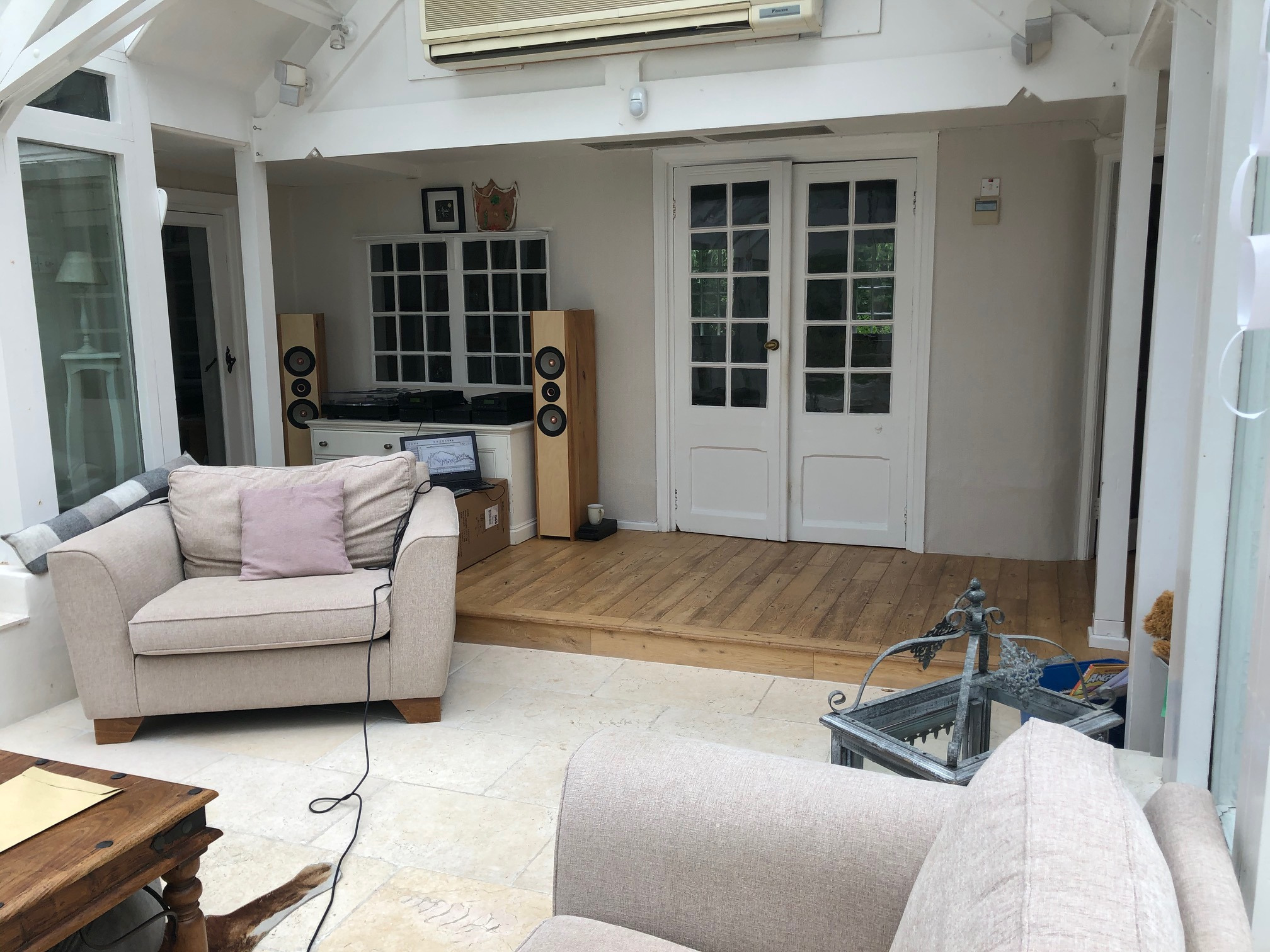

You have some speakers that are a step up in quality from the majority of studio monitors. Seriously.
Now, you're saying that vocals don't quite come through as you think they should. That could be down to a whole load of factors - anything from the way the music was mixed/mastered, through to the speakers themselves, and also your own expectations and biases.
I really do think it's time to start measuring things and see where you're at. We're trying to figure out what you're after, with only vague descriptions from you. That's not an insult. "Vocals not sitting right" is nowhere near as precise as "I have a 2.5dB dip from 1-2.5kHz".

I must admit that if I was to choose a set of HiFi speakers for an acoustically reflective room, I would have seriously considered compression drivers with horns, or at the very least a waveguide for the tweeter. By focusing the sound on a narrower area, you gain efficiency (or give the HF driver an easier life) and avoid throwing excess sound at the side walls.

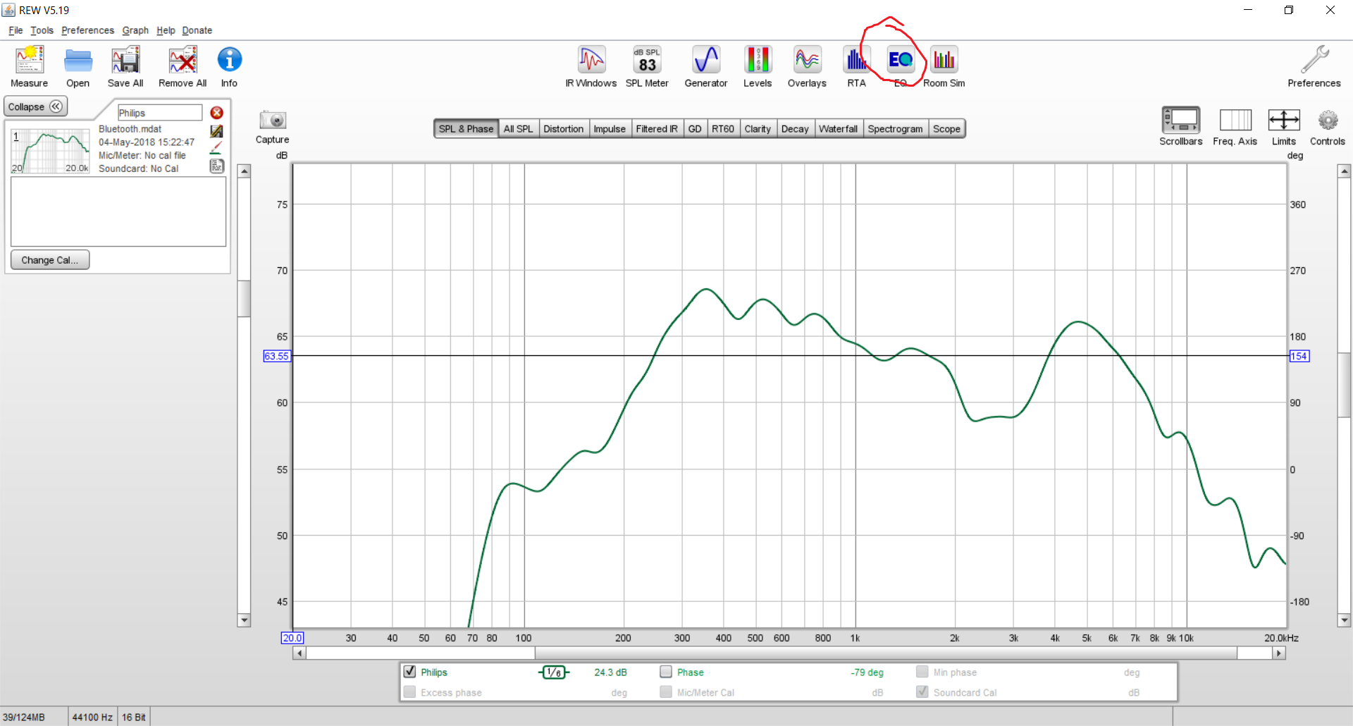

Hello again Chris,
I've finally received the equipment that you recommended and have spent a few hours getting set up, but I've given up and have absolutely no clue whatsoever how to set it up or make it work. In summary, I have the UMC202HD, the ECM8000 microphone and REW software. I'm really struggling to connect my laptop to the hifi, having bought a USB to USB (to connect into the USB connection in my Cyrus Streamline 2), I can't get anything to play through that port and I have since noted the Cyrus instructions specifically state in bold that a computer is not to be connected through there.
Subsequently, I have an RCA cable from my laptop headphone jack to a direct input into the DAC XP preamp. This works, as I can play YouTube through it.
And thats it, I have no idea whatsoever what to do from here and cannot understand the instruction on the REW software. The first thing it is asking me is to do is a calibration against an 'SPL meter' whatever one of those are. It keeps telling me that the levels are too low. I also can't output any sound (i.e YouTube to the hifi) when I have the UMC202HD connected to my laptop, as the laptop is trying to output sound to that rather than through the headphone jack/hifi.
I also have no idea whether I should be playing music through the speakers and measuring the sound form there, or using some REW generating sound, whether I am doing both speakers or individual ones, where to place the microphone etc etc. I've no idea what to measure, what an SPL meter range is and how to calibrate it, how to get the input levels to 75dBL or anything else that the software is telling me to do.
Is there any guide in plain English that I could refer to?!!! I can't even identify what the 'UMC202HD' actually is. I've no idea what it does and the manufacturer doesn't seen able to describe what it actually is or does other than an 'interface'. I'm sticking to designing bridges in future!!!!!!!!!!!!!!!!!!!!!!!!!!!!!!!!!!!!!!!
All help welcome.

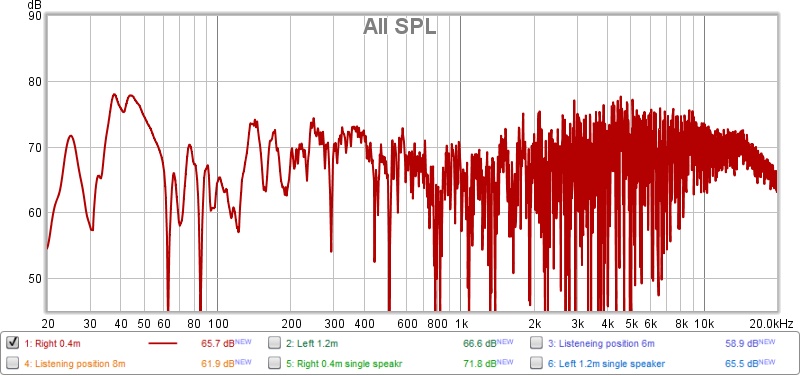

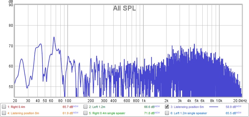

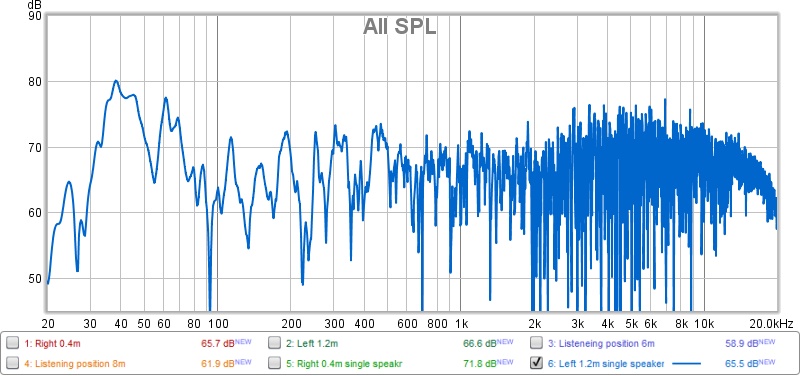

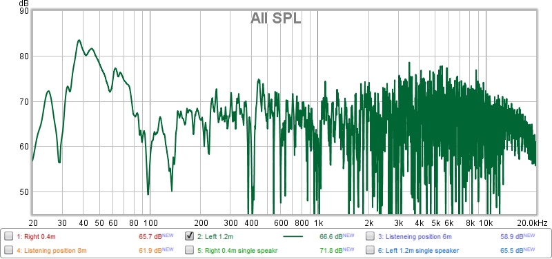

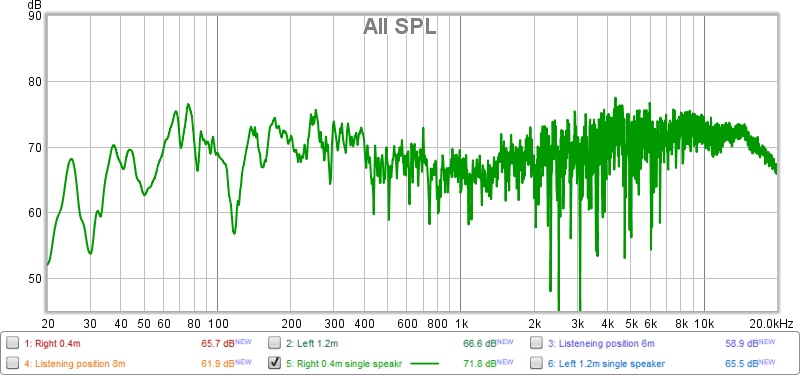

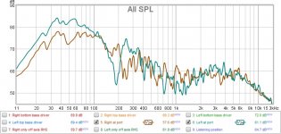

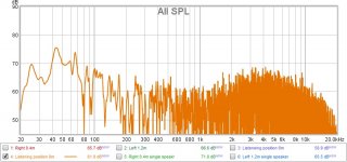

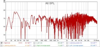

I've managed to play around with a lot of settings and get something to work. I'm not sure if it is correct or not, but I have some graphs at least.
I'm also not sure what I should be measuring and where, so I've made a few different measurements.
Does any of this make sense or is it more helpful if I overlay them?

Looking at your measurements, I'd say there's work to be done for sure. Try the mic positions I've suggested, apply a bit of smoothing, and see where you are.
Chris
PS - The apparent dip in the midrange (1kHz-ish) might give us an idea of why the vocals aren't right, but there's a lot of mash in those graphs, so difficult to say for sure.

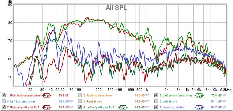

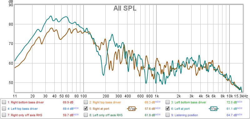

Right, I think that I got everything set up correctly and changed the input and output to the UMC. Please see the measurement results below. I hope that it isn't too messy with them all being on one graph? I've also taken a photo from my listening position, showing just how impossible my room actually is! There's nothing that I can do about this so will have to make the best with what I have. I can move the right speaker over to the right more, closer to the door. I've no idea why it is displaying up side down as it is the correct orientation on my laptop.
I also took a measurement at each port as you said. This is at the back at the end of the 'transmission line'.
Do I need to change the graphs to make them more readable?

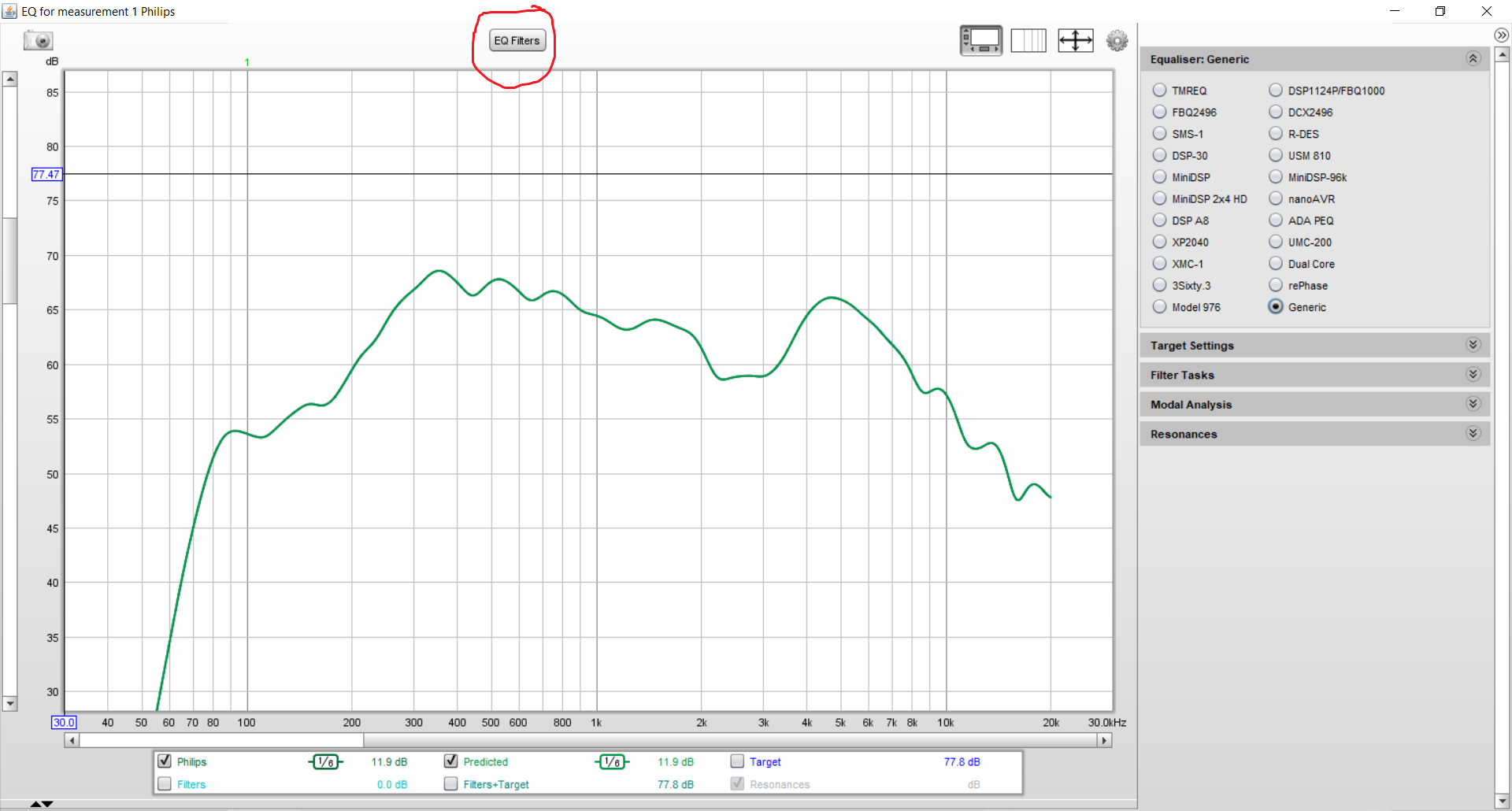

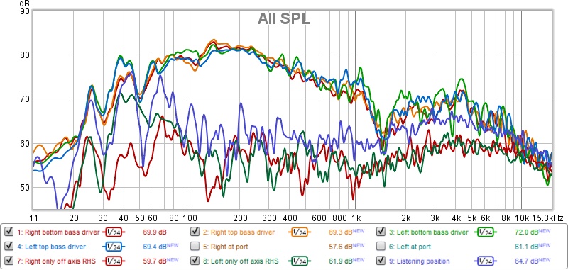

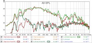

Your measurements look pretty reliable. Well done.
Separating out the measurements a little would be useful, though. It looks like the bottom red and green curves are the left & right speakers off-axis, and the nearby violet line is at the listening position. Is that correct?

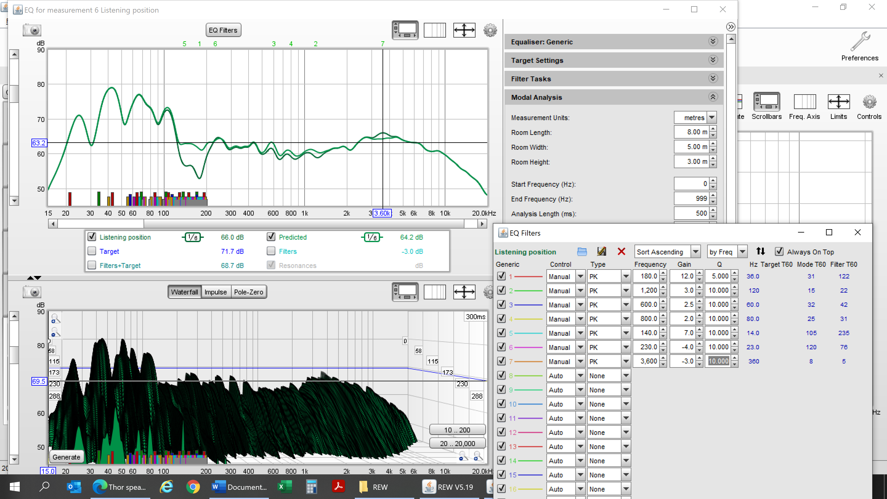

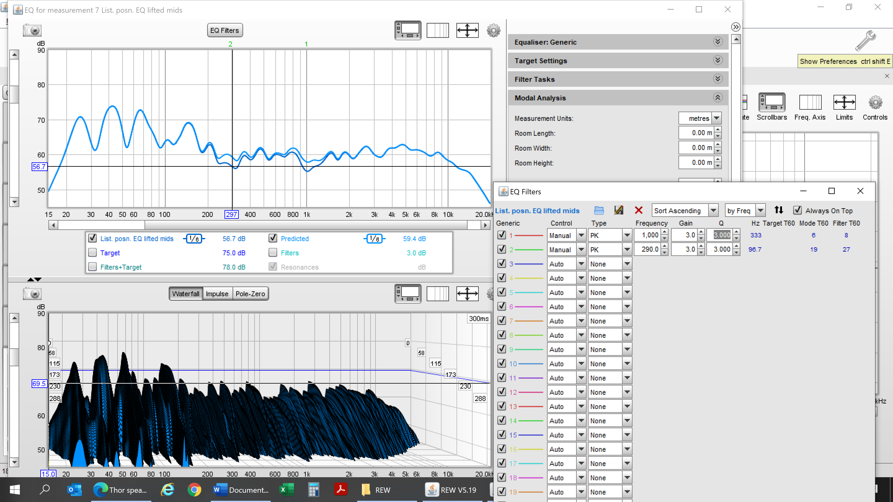

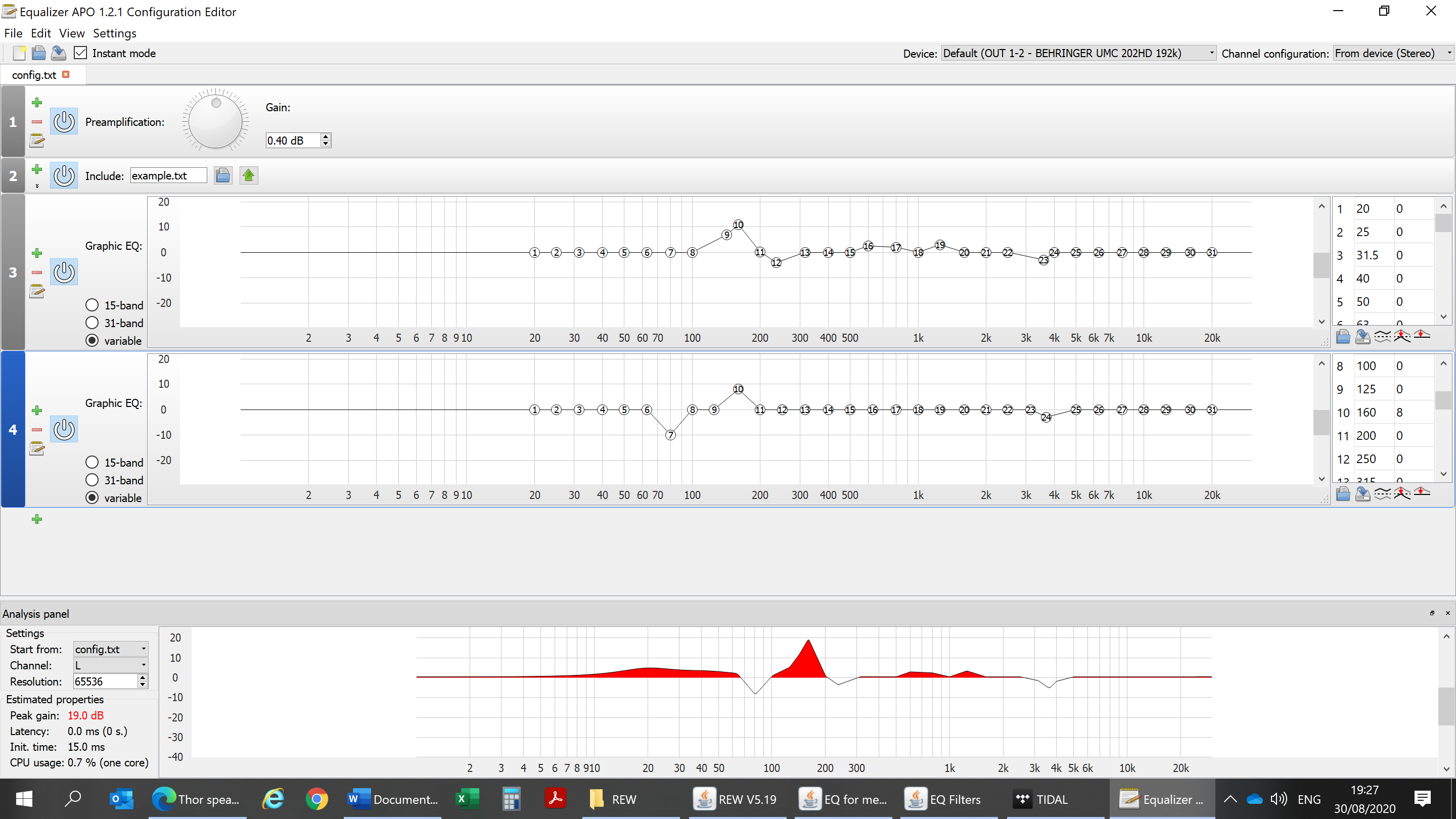

If so, it looks pretty obvious why the vocals don't sound great - the 200Hz-1kHz range is recessed, followed by a bump centred on 4kHz. The LF response looks pretty choppy, too.

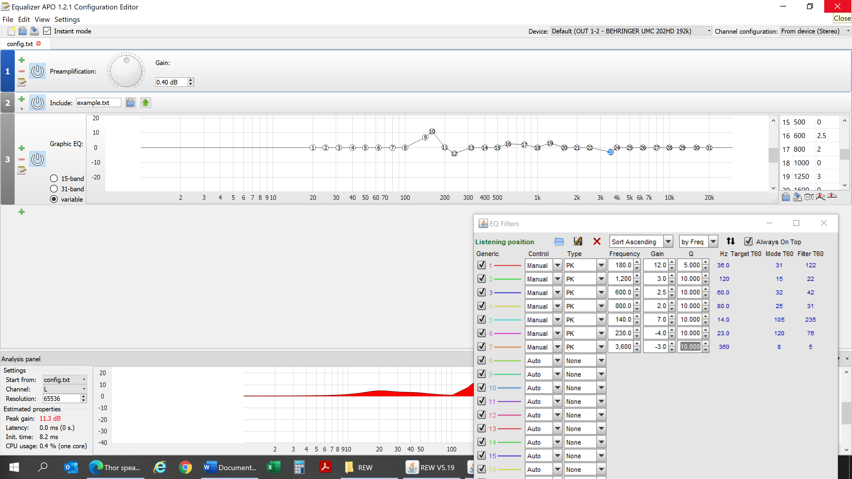

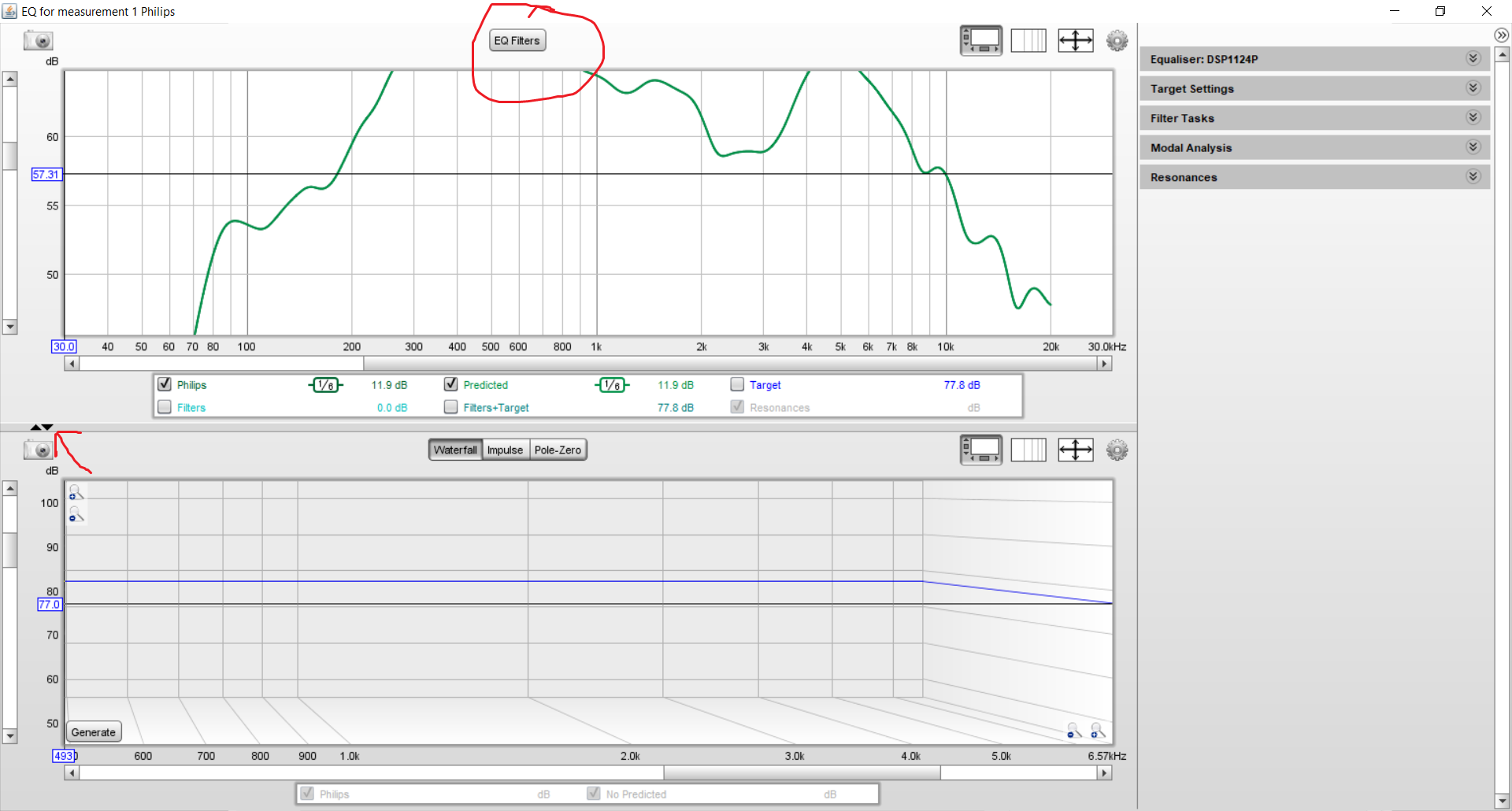

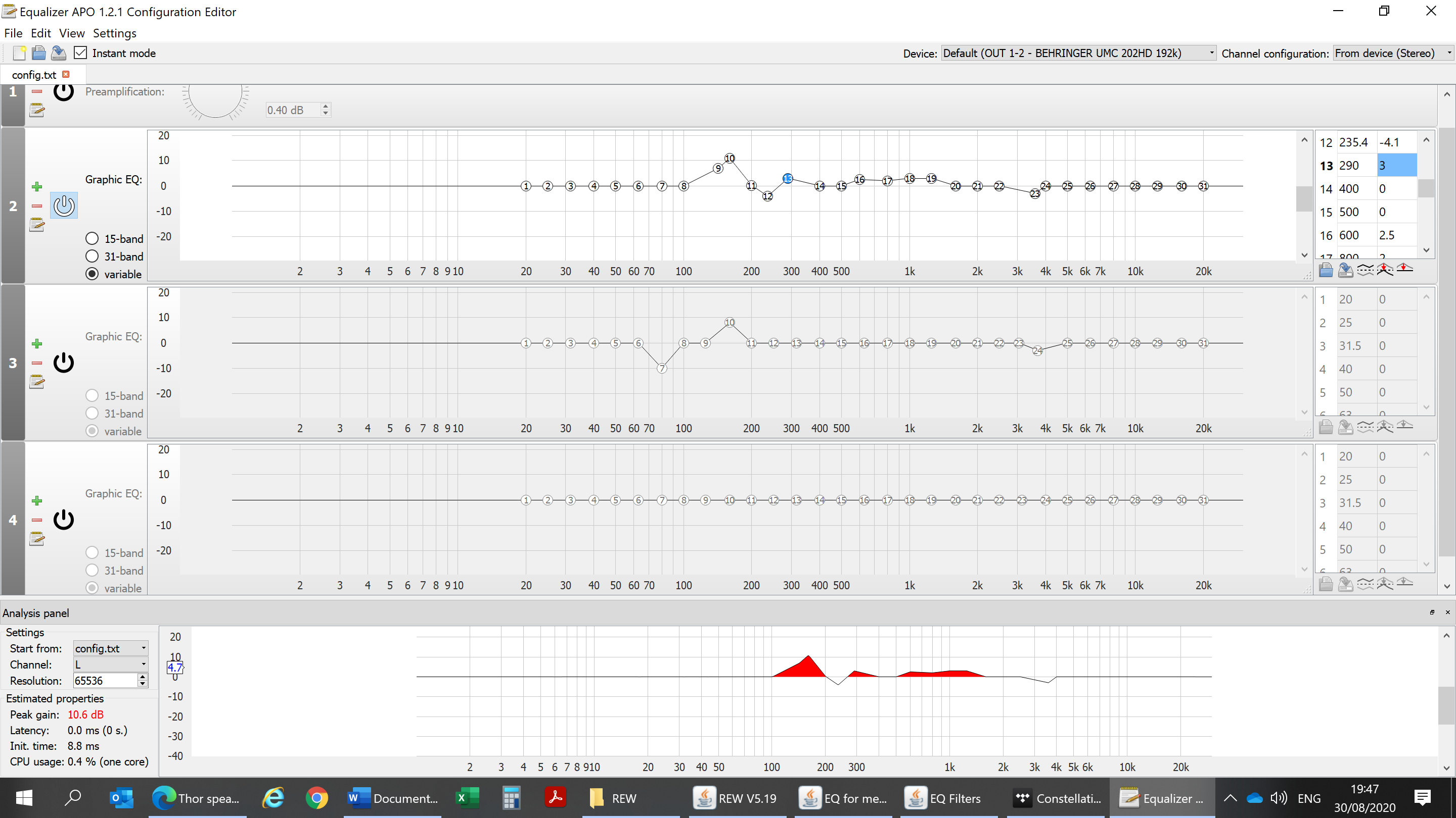

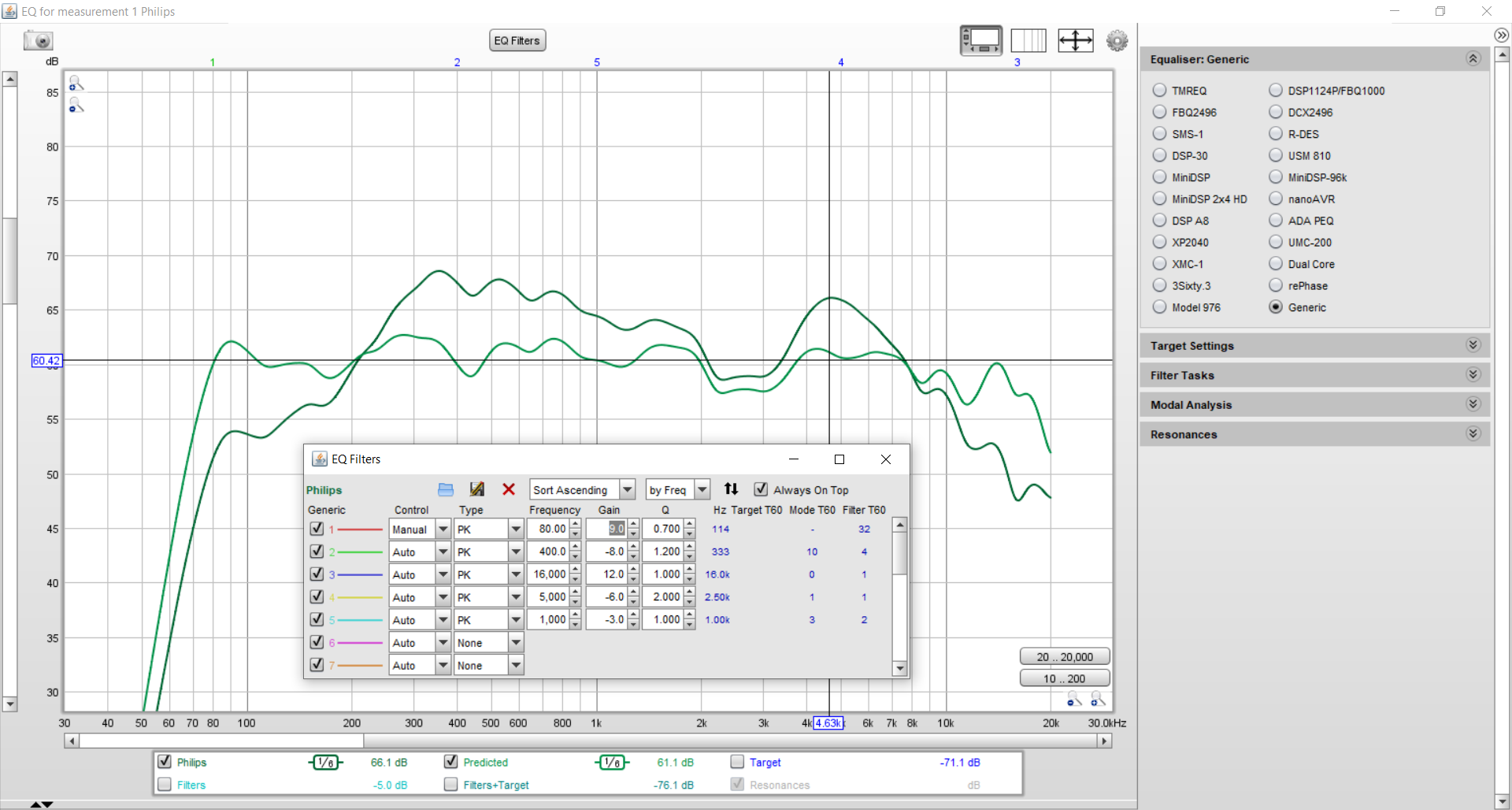

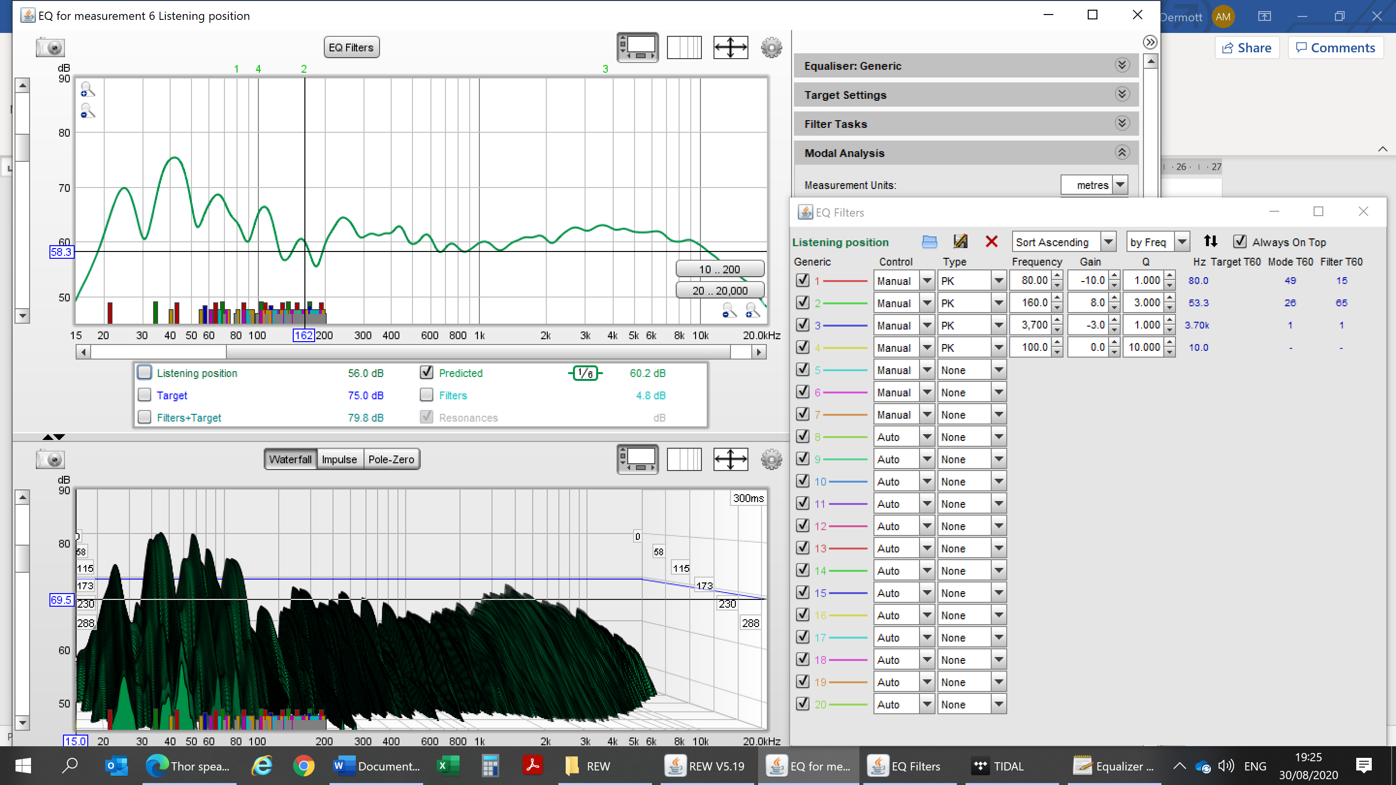

If you've got music on your laptop, install Equaliser APO and use REW to (manually) come up with some EQ settings and see how that goes. If you like the flatter result, then it's worth modifying the crossovers to get a similar response.
Chris
Chris

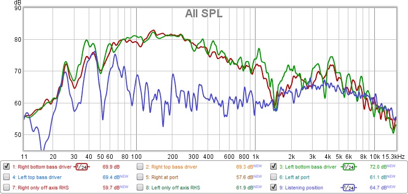

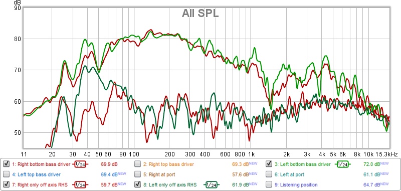

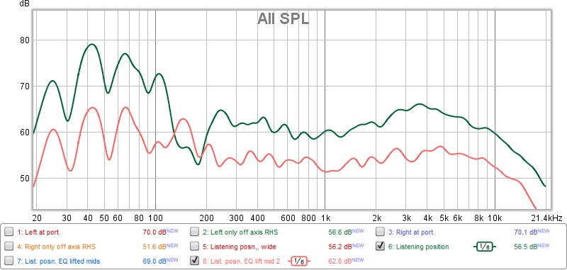

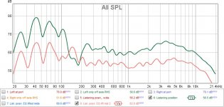

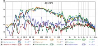

Chris,
That is correct. I've made them a bit simpler as follows:
Simplified graph - Top red and green are at the bass driver, purple listening position and bottom red and green are off axis
At driver and listening position - listening position in purple. Ignoring the fact that the purple is more like a roller coaster than the at driver measurements, the line is more horizontal than the at driver measurements, which surprised me.
At driver and off axis - the top two are at driver.
I'll have a go with Equaliser APO.

Well, when you close-mic a driver, you get a decent idea of what that one particular driver is doing. The response shape is as I'd expect:
- At the bottom end, the port helps
- In the 100-300Hz range, baffle step generally reduces the level.
- Towards the top of the band, another driver comes into play, so the response ought to roll off.
Anyway, that's largely irrelevant. What matters is how the speakers sound in-room, and the mid- and distant-mic'd measurements matter more there.
If you apply smoothing to get rid of more of the fuzz (try 1/12th or 1/6th octave), you'll have an idea of the EQ shape needed. See if you can get it done in two bands for a start - broad strokes.
Once you've got EQ set where REW says the output will be nice and flat, have a listen. Chances are it'll sound like an AM radio initially, if you're used to all that bass and lower-treble.
Give it 10-15 minutes of good listening to allow your ears to adjust to the new sound, and then break out the reference tracks which you know well.
I have an idea of what you'll think about the result, but I don't want to suggest anything that might influence your perception. Give it a try, see what you think.
IMO, you're on a good path. You've got a set of excellent drivers and a measurement mic. Good results are in reach.
Chris

Can you share your EQ settings, and a screenshot of the REW EQ simulator?
What you're saying makes sense. Give it a while for your ears to adjust, and see what you think after that.

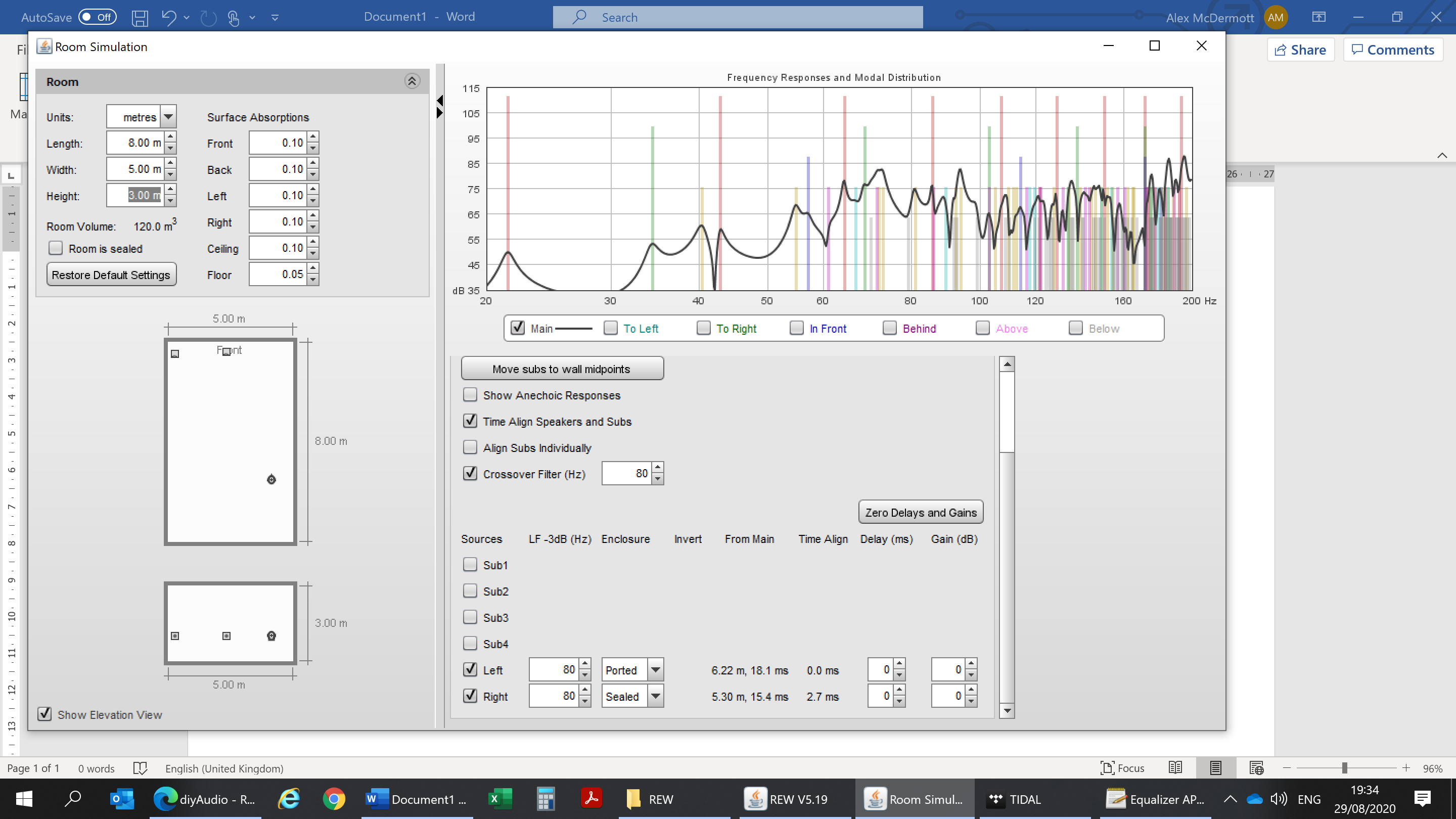

Ah. I think I've not been using the software correctly as I didn't know about REW EQ simulator but have just found it. Having a look at it, I've no idea how to use it so I'll have to have a play around with it.
What I did previously was look at the SPL graph at the listening position, then manually adjust the graphic equalizer in Equalizer APO to lift the frequencies approx. by the amount they dipped in the SPL graph, if that makes sense, mainly 100-200Hz and 800-1800Hz.
Anyway I've scrapped that and started looking at the REW room sim - is the attached graph the one which I'm interested in?
I really appreciate your patience with me by the way!
The images attached should help. This was just the frequency curve of an old bluetooth speaker I had lying around, which clearly needs some work.
Don't bother with the auto-EQ or anything like that. It usually throws 10+ filters at something that can be "close enough" with two.
If I had to guess at yours, I'd say a wide cut at 80Hz and 4kHz would do the job. Remember, if you use EQ to boost things, you'll need to drop the overall level to avoid digital clipping.
Chris
Chris
Right, I've finally made some good progress.
Initially, I tired to lowers the lows and highs around the values that you suggested, but I couldn't get a decent curve without creating many more filters.
Instead I tried to lift the mids. All I can say is wow, what a transformation. Although only a series of small changes, the overall effect has been to really lift the vocals and in general make the music much more three dimensional, it's like switching between mono and stereo!
Is it worth me doing any more iterations or are there diminishing returns? I'm conscious that whatever adjustments I make I need to do the same with my crossover equipment at some point!
The attachments are:
Equ lower 80 & 4000 1a & b = lowering lows and highs at values you suggested
Equ lifted mids iteration 1a & b = lifting mids iteration 1
Equ lifted mids iteration 2a & b = lifting mids iteration 2
Equ lifted mids iteration 2c = recording the values of the equalizer (so I dont forget them)
Equalizer = iteration 2 measured at listening position (in pink, original measurement in green)
