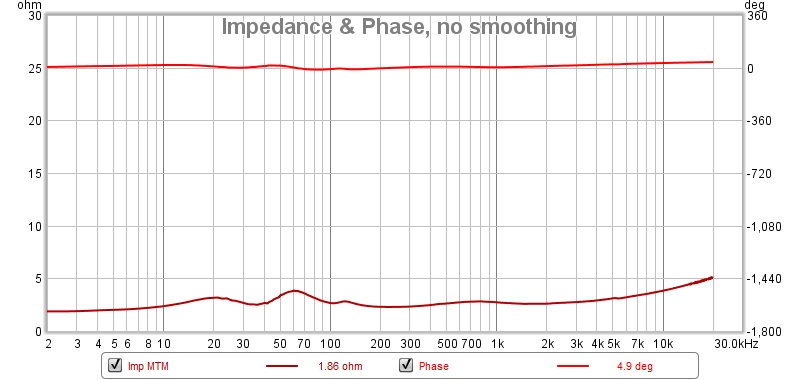

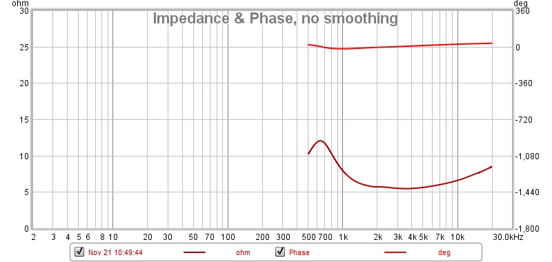

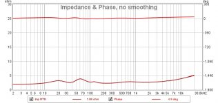

I've just taken a further measurement:
Looks pretty sensible.
Next step is to take impedance curves of the woofers and tweeters. Fine to leave the woofers wired in parallel and simulate them as one unit in the crossover.
I wouldn't introduce DSP into your system yet. Unnecessary rounds of A/D and D/A conversion should be avoided in my experience.
Chris
It looks like you've wired the complete speakers in parallel.
I meant access the crossovers, disconnect the drivers from the crossovers, and test impedance of the tweeter on its own, and the 2x mids in parallel.
While you've got the drivers disconnected, you can take frequency response measurements of each passband, and we'll use those in the crossover simulator. NB - Make sure the tweeter doesn't receive any bass by setting the sweep to start at 500Hz or so, and keep the volume level sensible.
Chris
