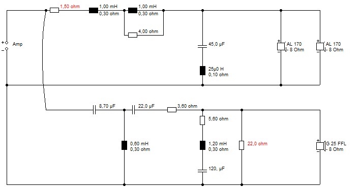

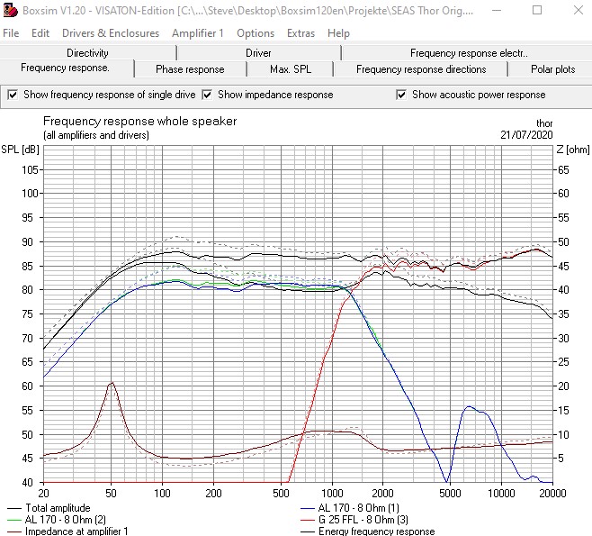

I thought I spelled it out clearly enough:
https://www.diyaudio.com/forums/multi-way/356953-thor-speaker-lots-help-please-6.html#post6282483
The circuit mods in red:
And what they do with similar drivers, dotted being original, solid being with mods::
Just takes the bass down a bit. What Dissi did was adjust for your bass unit Qts, which is not the original SEAS Thor driver. Still not convinced the tweeter LCR is right. I think I got nearer 68uF when I looked at the tweeter Fs resonance.

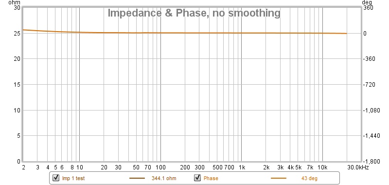

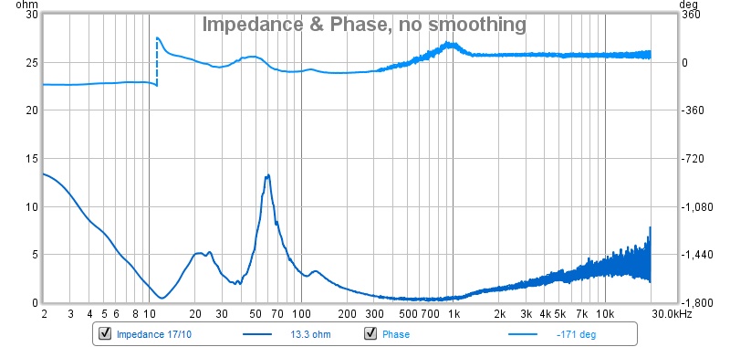

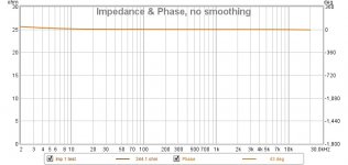

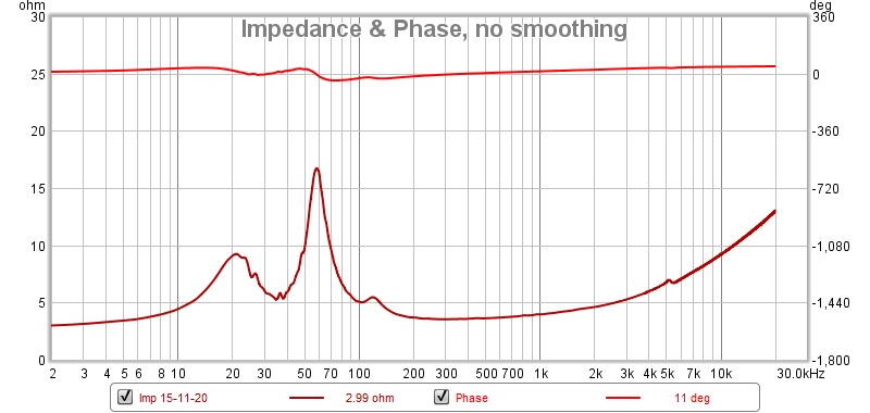

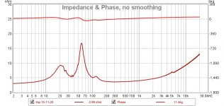

I seem to have made some progress as I can hear the faint noise through the speakers now, however as you can see from the attached, there seems to be something wrong with the measurement.
Perhaps I have my wiring incorrect still. To explain what I have done in my non-elecgrical terminology:
I have connected the XLR input 1 white cable (bottom pin I believe) one side of the resistor and the white cable coming out of the headphone jack. I have connected the other end of the resistor to the driver +ive cable, this cable feeding both mid bass drivers. Finally, XLR input 2 white cable to the driver -ive cable feeding both mid bass drivers.
Does this sound correct?
It would be much easier to work with 1/4" jacks, but if we're working with XLR inputs:
Pin 1 = ground, pin 2 = +, pin 3 = -
Given that, you should connect pin 1 & 3 together to make it unbalanced. If you're using the XLR cables for other purposes, you should remove this link after doing the impedance measurements. Particularly, it'll stop phantom power (which your measurement mic needs) from working.
I'm not sure what you mean by "white cable". Are you referring to the inner jacket colour? What are the other colours?
You should have the headphone side of the resistor connected to input 1, pin 2, and the speaker side of the resistor connected to input 2, pin 2. You can safely connect all the negative terminals (headphone out, input 1, input 2, speaker -) together.
Chris

Ah, sounds like I misunderstood the diagram. Firstly, yes, the white cable is the inner sheath running from the XLR (and headphone) connection. I'm using XLR as its the only input connection on the UMC.
Up to now, I've not had the red inner cable from the any of the 2 x XLR or headphone cables connected to anything as I thought the diagram used only negative cables, as those round symbols are shown at all outputs?

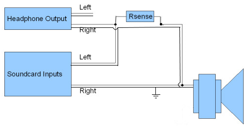

Chris,
I'm even more lost sorry, however I've found the below diagram that does actually make sense to me. I can follow this but the problem that I have is that this shows 4 cables coming out of the headphone jack, but I only have one headphone jack and therefore two cables.
However, there are two 'output' jacks L and R in the back. I don't believe these to be headphone outputs but perhaps that is what I should be using? If correct, then I don't need to connect anything to the L side, just the R side. The only thing that I need to work out then is to do is connect which XLR pin to where. Pin 1 is 'earth', 2 is positive and 3 negative, which I have checked. So using your previous advice, I think that I just need to make sure that pin 1 and 3 are connected together at the end of both XLR cables?
Also, there areonly two inputs into the UMC, both of which being XLR.
mcgi, I have two of these interfaces in front of me (well, one's a UMC404). It's an XLR/jack combi. You can plug a jack cable into the middle. See here: Would I buy it again? Review of the Behringer U-PHORIA UMC202HD Audio Interface - Plus 2x bonus gear! - Ben Lobaugh Online
