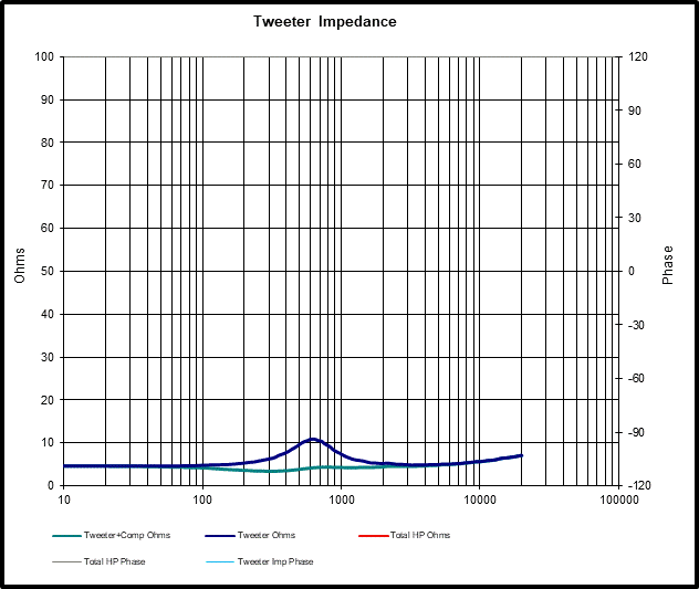

Attached. Dark blue using D'Appolito's measured impedance of the Millennium tweeter, teal with the aforementioned Fs LCR conjugate. Not perfect, but looks 'good enough' for purpose.

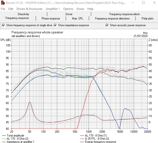

I just did some rough simming of the three filters.
The steep one in use here is 1.7kHz or so. Nice flattish impedance, BTW.
The shallower SEAS is 2.5kHz. Regular sort of bell-shape impedance.
Troels' 4th order is 2kHz. Didn't want to spend too long on it, but looks OK.
Interestingly, IMO, the SEAS one has almost 3dB more midrange energy between 200 and 2kHz. Or the other one is bass heavier.
That sounds like what mcgi is hearing.

Possibly. Thor was designed by D'Appolito (the Seas filter is D'Appolito's) to be flat on [tweeter] axis at 1.25m or > for proper summing, with 4th order acoustical slopes, and measures that way in his data; if memory serves the alternate filter has a slightly declining response trend along roughly B&K lines. In this case, I suspect more of a problem lies in the fact that it's not using the midbass drivers the speaker was designed for, and without compensating for both the lower Q and the increased sensitivity of the EX001, the balance will be thrown out by several dB through the midband, nor will the enclosure loading be optimal. Being an Augspurger type TL, the Thor was not a high-output line design in the first place, so with overdamped drivers and potentially inadequate compensation for the balance above mass-corner, there are going to be issues. Unfortunately based on the Seas data you'd need about 5ohms series R to artificially increase the EX001's effective Qts up to the 0.42 of the E001 the Thor enclosure was designed for, but that will reduce overall sensitivity to a level lower than that unit, so the tweeter is likely to need more padding to get the overall response into line.

Well, the fact that the EX001 drive units, even with 1ohm - 1.5ohm series R are still significantly over-damped relative to the E001 springs to mind. While it will help to a point though the midband, the mass-corner frequency will still be raised, with output reduced below that relative to the E001 the Thor was designed for; an effective Qt of 0.29 (1ohm) - 0.32 (1.5ohm) plays against 0.42. And some found the overall balance of the Thor a little bright to start with due to its well-damped LF characteristic, so if you have even more LF damping, it will push the overall balance even further that way.
I stand corrected, yes. I forgot they changed the datasheet. That'll teach me not to check my records. However, it seems we all agree that the EX units require series R or it's flat not going to work (notwithstanding my error re the necessary quantity due to overlooking the datasheet change).
Agreed, and probably not excessively so; it can throw the overall balance out though so worth at least keeping in mind given that Thor as-designed uses a well-damped TL alignment. You can also bring the LF levels up by pulling some damping from the last few inches of the line. As noted however, I overlooked the fact that the data sheets have changed over the years since I last looked at it; the difference in practice isn't massive though and relatively easily compensated with the modest series R Dissi refers to that also helps with midrange level-matching.

An ohm sounds like nothing. But 3dB of midrange presence is a lot. I consider the Thor speaker problem solved.
