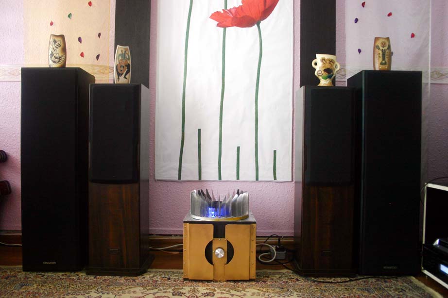

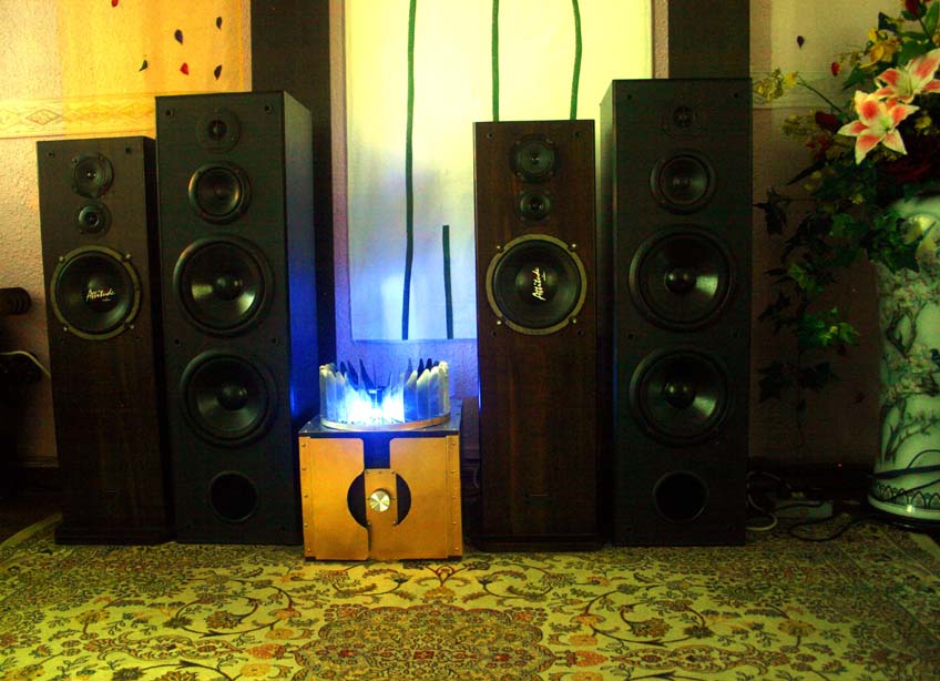

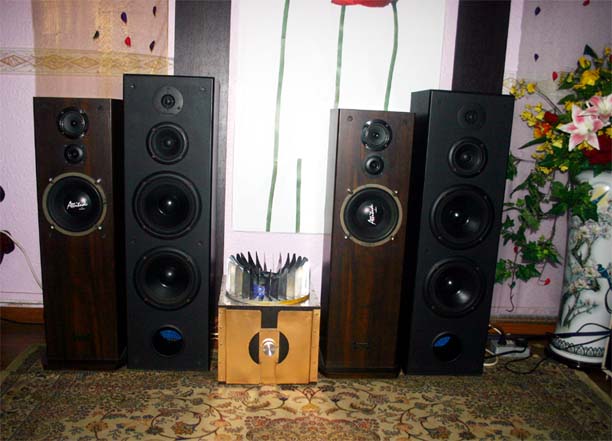

finally completed the Dx-turbo amp.
Dear Dx and all,
i have completed the Dx-Turbo amp. now really enjoying its sound so great.....
here is the picture of completed amp. i am using this two 8ohms speaker system for now so its become 4ohms, but not for long i will be using in 4ohms. sound really great.
i have taken the pic without the flash so can see how its lights are at night.
thanks to carlos for your great amp.
best regards
michael

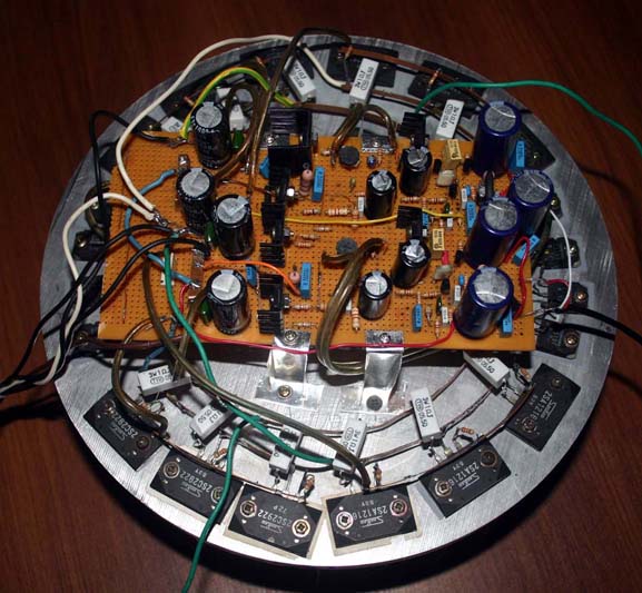

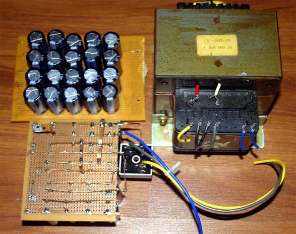

Dx-turbo picture as requested
dear Dx all,
someone has requersted me to post my final virsion of Dx-turbo picture circuit and the box design. here i posted my final virsion. i am really enjoying every bit of the music....
thank you
michael
What artistry. Thanks for sharing the pictures. If you have any of your power supply, I'd be interested in seeing how you did those as well.
Thanks for all the inspiration. You're truly a diy person and a credit to these forums.
best wishes,
Brian
Hey space2000, I really love the way you have mounted the output devices and veroboard. 🙂
Maybe Nordic could develop a nice small PCB for that design, then it would look schmic indeed.
