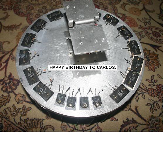

dear Dx,
i have question about the heat sink. i am using space heatsink as you have seen. i used one channel on it and the temp counted after 1.5 hour is only 33c my amb is now 29. i used one fan into the center. i am now using sanken. should i put two channel into one heatsink? as i have seen there is not much heat on it. it will be looks nice if i can put two channel into one sink.

here is the picture of how i place all those transistors into one heat sink.

space2000 said:dear Dx,
best regards
michael
Hi space2000
man i wish, your heatsink is awesome,
congratulations

Keep low current into the emitter resistances and of course you can install your second channel into the same heatsink.
When current is very low, your thermal drift problems will be very reduced... do not advance your emitter resistance stand by current, or your heatsink size may turn very deceptive.

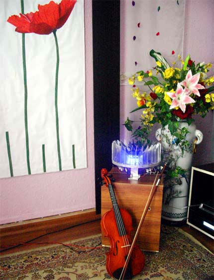

DX-Trubo pic
dear Dx,
here is the picture of Dx-turbo. sound good...really good...even my mother in law says.
i couldn't find any easy way to doing the box. its still have to do more things. anyway now it is in the box.....fully by hand made and made at home.

Real work of art, Space. You really know how to think outside the box, no pun intended. (really).
I was hoping for pictures of your circuit boards. Maybe you'll post some.
I enjoy the way you put this stuff togeather.
