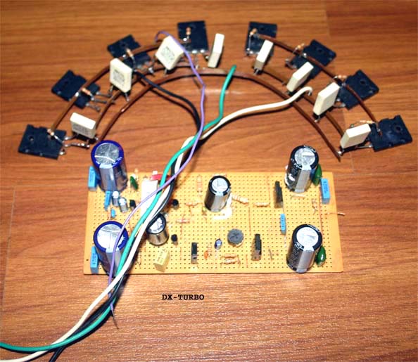

Dear all,
here i have just completed another channel since its working so well that i can't wait to make another channel. here just to show how will be when i put it onto the space heat sink. output transistor will be change to sanken 2sc2922. i just made it for to show you. how nice Dx-turbo sound, fantastic amp. its great amp in class AB. you all can make much much more btr then me.
i know when i will put it into the box sound will be more btr.

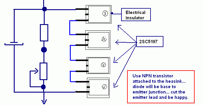

Dear dx,
i am now assembling the amp. i have some question about somethings i don't relly understand.
this few days i was operating without to attaching the diod on the heat sink. i tried one time but find there is a problem to attaching also have consider about short circuit with the heat sink.
now i have question, should i operate it without to attaching onto the heat sink or use any output transistor to make as a diod its easy to attach onto the heat sink as you recomended. i have some 2sc5200, 2sc5197 and 2sa1940, 2sa1943 transistors for output. pls if you can advice me this transistor how to use as a diod. means how to connect? thank you for your help.
which is positive and neg on the transistor E-C-B?
currently i am using sanken 2sc2922 as a output transistors but it expensive to have for diod.
best regards
michael

you can use a To92 or Eline or To126 or To220 transistor as a diode by shorting collector to base.
An NPN has emitter most negative, a PNP has the emitter most positive.
glue or clamp or bolt the flat transistor face to the heatsink.
a transistor with the collector connected to an exposed baseplate must be electrically insulated from the heatsink. Many To126 and some To220 have insulated faces.

dear dx,
Thaks for your diagram. i am now attaching onto the heat sink.
the amp is running quite well. no hum at all no pik or any unusual heat.
i think it is quite stable.

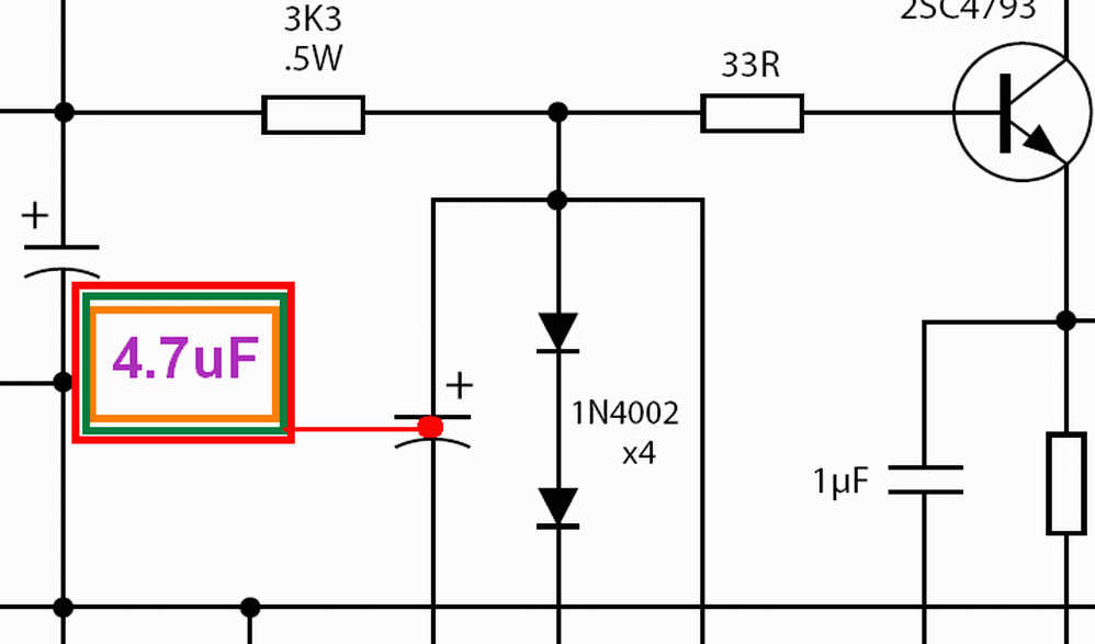

I found, folks, this condenser that needs to be increased.
Was hard to find the reason of my mistake... i have discovered because of an accident while tweaking...i was trying 1uF in this position.... the condenser i had there, installed into my prototype, measured 3.9uf when it is marked as a 2.2uf condenser....... so, in the reality i was having 3.9uf in that position and thinking i was having 2.2uF...old condenser used... an old Brazilian Siemens unit.
I could perceive, listening, that smaller values, alike 1uF had differences in sonics..... seems that alike tube sound... or when you have differences in amplitude into the positive half cicle compared to the negative half cicle.... the minimum value there must be 4.7uf (higher than 3.3uf)....i found that 10uf and 22uf works fine...but when you increase above this sounds strange..... not bad, but strange... undefined into the trebles....non realistic i have perceived....no air around the instruments.... the saxophone vibration, that is metalic..sounded alike some plastic saxophone vibrating....
Well... the amplifier remains sounding fine using 2.2uf..but i strongly suggest folks to try 4.7uf in this position.
The schematic will not need to be modified, the ones that use to read the thread with attention, if build using 4.7uf will have some advantage of quality over the others that has not the attention to read and follow the small tuning i use to make.
Those things i use to say...those tweaking results, can be checked by yourself, replacing condensers in this position (in this circuit of course).... imagine the sound produced by the Sax is a result of something thin and small alike a metalic nail vibrating (the metal used into the second world war...the cricket sound instrument used to communicate and help parachuters to identify their friends... the blade produced the cricket sound..this blade....a steel blade)...... so.... when sax plays, this vibrates and produces a harshing sound.... some vibration, metalic vibration... a harshing sound is the one you listen vibrating a dry bamboo splitted in two longitudinal pieces... cracked into two pieces into half of it's length.... so.... this is the noise the sax produces, but metalic, as it may use metalic blade..... NOW... imagine the blade made of some kind of plastic.... the difference of sound you may perceive substituting this condenser...this is what i have perceived.
Of course it is not very easy.... but if you go substituting and listening, you will see that diferences are.
