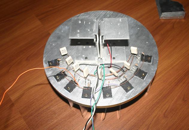

update
dear dx,
i just added two more pair of transistors so total now 4 pair. i got a bit problem now E-b at output transistors voltage get abnormal up down like suddenly above 0.600v then when i touch the diod for a while its comes down to 0.150 where it suppose to be.
now question is, i haven't fix the diod board on the heat yet. dose it cause by diod? last time when i was playing with only two pair of transistor its dosn't hpns even i never attach diod on the heat sink.
i am now attaching on my space heat sink...i will show you the pic.....soon....ok...wait..
best regards.
michael
best regards.
heat sink finishing with heat compound and DX-turbo.
dear dx,
here is the picture DX-turbo......space heat sink.
you can see back side placed transistor for one channel and another side unfinished fins assembled. i was assembling the fins with heat compound.
thanks for view.
mchael
Use that condenser, the 2,2uf that is connected into the diode series
Also check if your zobel is connected.... check if into the output you have some AC voltage (oscilation)...if positive, then increase the miller capacitor...that one you have into the VAS transistor, from base to colector..... if no result, then increase the feedback condenser to 27pf (from 10pf to 27pf).
Have you grounded your heatsink...do that first..in advance.

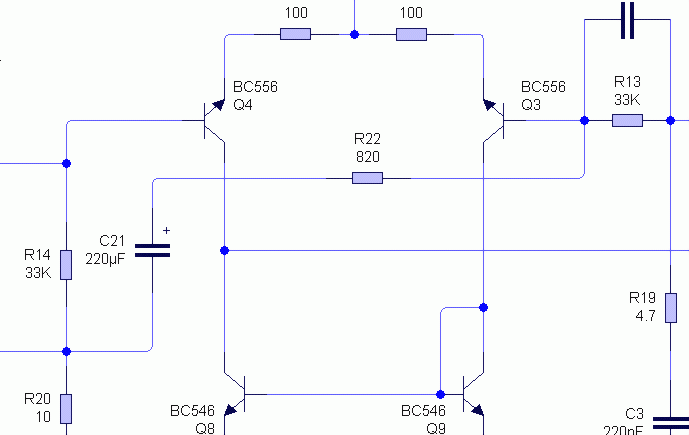

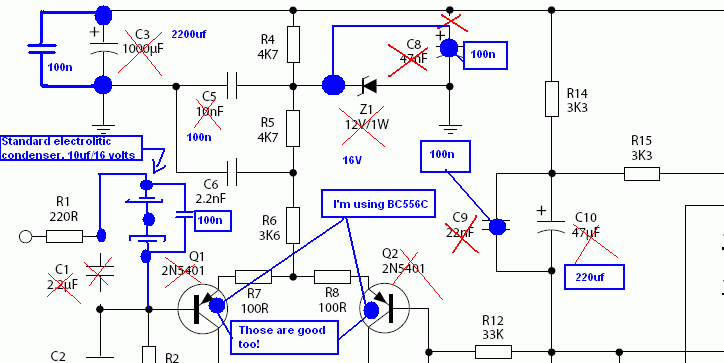

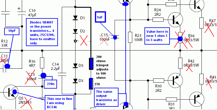

zobel.
dear dx, i think R16 is the zoble right? i attached the diagram for you. i am following this diagram. it is a bit diffrent then you posted here. i got it from your web site.
if it is not zobel, then which value should is use? 10ohms in series with 100nf cap to the GND?
sould i attach the diod on to the heat sink. i have some spare 2sc5200 and 2sa1943.
thanks.
Well man...your are behaving as a bad boy to uncle Charlie and will not receive
Chocolate bar this holiday...hummmm...bad boy not reading things.... there's an updated, much better schematic...your are using the old schematic... already substituted by the revision 2.
Unfortunatelly Todd Johnson is very busy and could not make the official pretty schematic...but i have published the revision 2 in the thread...bad boy do not read....it is OK!.. at least you build things..use your time to build in the place to read...it is fine.
I will show you the modifications in several images (big work)
regards,
Carlos
