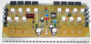

Re: Another PCB for DHR-DX amplifier
Hi Alex mm
I cannot say I found anything "wrong" with this revised layout, but I (for several reasons) tend to favor the one you posted previously here.

both of the pcb s
presented by alex mm should be cosnsidered as a product of a lot of work ....pcb like that is not made in 5 minutes ......
i will agree with carlos that both of the pcb will require testing from many points of view .....
for sure though this version here http://www.diyaudio.com/forums/showthread.php?postid=1554773#post1554773 looks simple and symetric but traces are not thick enough for an amp of this power....also the way drive board is away from power board cannot provide any guarantee on how the average user will make the wiring ( thats a very big risk ) if wiring is done wrong like for example far away from main board ...then feedbacks and grounds are going to be too sensitive ........
then on the other hand the newest is too messy and badly aranged ....it doesnt look good ...it might be working perfectly but it doesnt look good .....

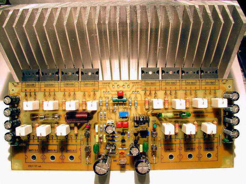

hei alex !!!! have you considered a "piggy board " ???????
please look attached foto of one pcb that is designed by me for the CHAMELEON AMPLIFIER and actually is made by two boards lower board is the power board with the power transitors and zobel and decouling and with one 3mm spacer and a three pin connector you have a piggy board exactly on the top of the power board that includes ( in my case ) the ic that provides the drive and also the seperated connectors for 15+15 volts .....
we all know that uncle charly doesnt like ic but this idea could be easilly adopted for your big amplifier and provide a lot of flexibility since also drive unit is going to be far away enough from all the big currents that flow in the power board .... and also the both pcb will end up to something very small, safe and functional ....
please take a look and private mail me with your opinion ....
thanks
thanks
Yes Sakis...looks good.
Thank you to show your board to us.

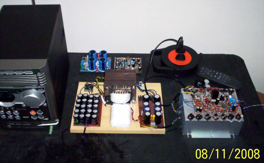

left chanel in progres.....
.....thanks uncle Carlos , but my work stil whaiting for me I waiting until mondey to buy some devices to finish ,the right chanel to http://i37.tinypic.com/xnf2ww.jpg component side and http://i37.tinypic.com/ergc9l.jpg botom side . So next weak I intend to testing DHR-DX amplifier
regards alex mm
regards alex mm

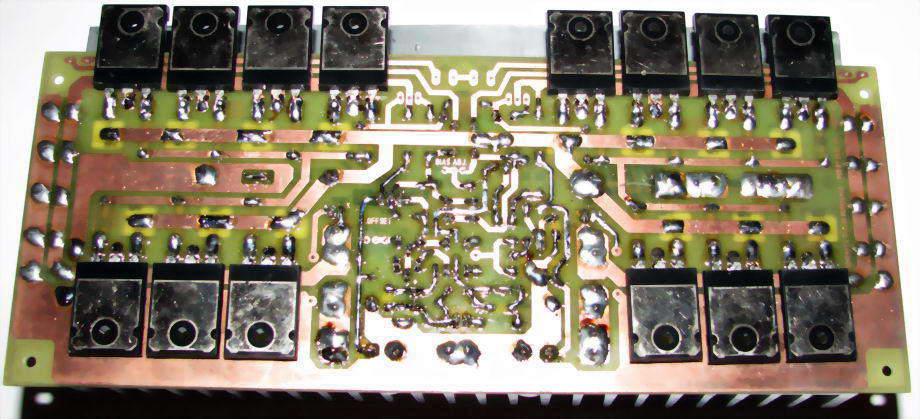

gest another picture ....
..... closer look of the amplifier here http://i34.tinypic.com/2q9me4h.jpg Regards alex mm
