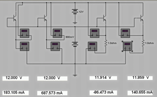

Power equalization.... equal power to transistors
Emitter resistances equalizes (turns equal, turns the same) the power into transistors... almost the same.... reduces differences.
What differences?
Each transistor has it's own gain, if not from the same "waffer" into the production, they will be different in many things..in special the gain will be different...and this creates problems.
The one that has more gain will work more than the other... it will hold more heat than another one...this will mean it can burn and the other will not burn..one will work too much and the other will work less.

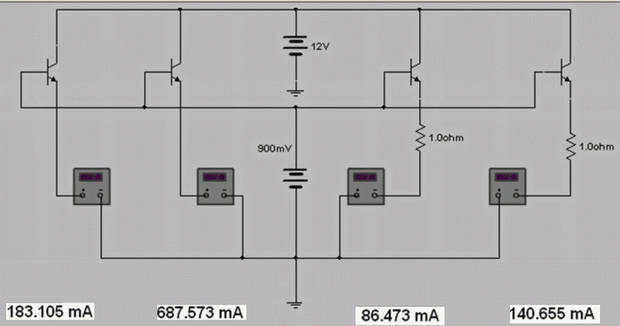

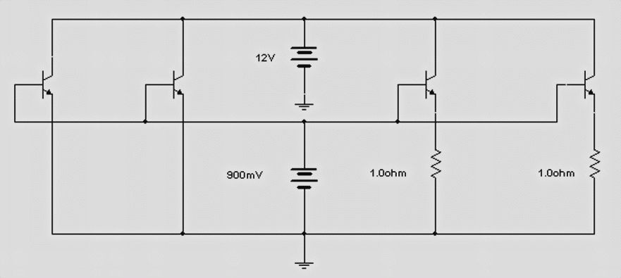

Observe, watch my sketch.... see that we have two transistors into the left side and two transistors into the rigth side...imagine they are into different amplifiers.... those two into the left have not equalization resistances into the emitters... the other two at rigth side have equalization resistances into the emitters.
I will force them to conduct...will use a battery that will send them 800 milivolts of continuous voltage into the base...this will circulate from the base to the emitter and will turn those transistors on..... as a consequence current will flow from colector to emitter... and the current will be different...because those transistors have HUGE DIFFERENCES OF GAIN.
The 12 volts battery will power the colector to emitter circuit.
Observe the schematic...observe all them with same base voltage...and almost the same base current.
regards,
Carlos
Then i have inserted amperometers in series with colector to emitter circuit.
Observe how currents are bigger...you see how bigger then are when not using emitter resistances...this is fine to audio power....the two transistors into the rigth side have emitter resistances..and they are limiting the power... some power will be developed over those emitter resistances.... you gonna have losses of power and heat.... where you have resistances you gonna have heat!...but observe the transistors are different.
Into those groups of two transistors.... 2 left hand transistors and 2 rigth hand transistors...the left one of those two groups are higher gain units...you see how bigger is the current because the unit higher gain.... even using emitter resistances, the current difference will exist....because the gain...but you may be able to control the power.
Observe the current measurements into those transistors.
regards,
Carlos

Now i will show you voltage and current informations
The voltage informed is the voltage you have measured from colector to emitter...so...it is connected directly to the power.... this voltage you can measure using DC voltimeter...one probe point at colector and the other at emitter... VCE is the name... Voltage from Colector to Emitter.
Also each current is informed.
You can see there are differences in current, even into the rigth hand.... those 2 transistors, even having emitter resistances shows current differences.
BUT!...... power is the result of the multiplication of Voltage by Current and them we gonna see different sittuations.
Observe the measurements.

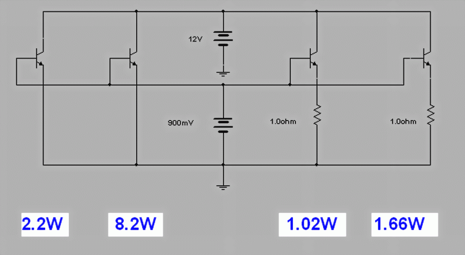

Now you can see the reason to use emitter resistances
You can see the power.... power differences into each transistor is less problematic into the rigth hand pair of transistors...
The difference of current into the ones have no emitter resistance is enormous..also the power difference as you can see into the sketch provided below.
The power was divided between the transistor Colector to Emitter junction and the resistance... the bigger the current flowing the smaller would be the transistor's Colector to Emitter voltage... and the consequence is that you gonna have smaller power... the bigger the current, the smaller the power into the transistor...the resistance will help a lot!
The dumping is disturbed with the emitter resistance presence...the bass is disturbed a lot.... kills the quality.... a sonic murderer....BUT, as transistors are different...we HAVE to use them when you are using more than one pair of transistors...and this...to turn power EQUAL into the power transistors.
I hope i have helped the ones had not this knowledge..there are many folks that does not know that.
