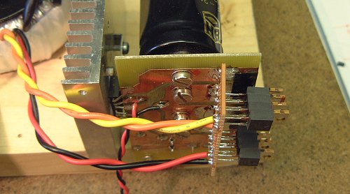

So yesterday I fitted my MUR860 rectifiers. See my WWW for some more details - wasn't sure what difference to expect, but I think that the sound is clearer, more detailed, possibly a shade brighter. Not a huge difference, and I plan to revert to the old standard rectifiers in a few days time to convince myself that I'm not going mad ;)
I made a couple of changes today. First off, I substituted the 100K pot for a 10K type and noticed that the bass tightened up a little. I had thought the 'flabbiness was due to the small square room and the speakers being in the corners but there was a noticeable difference.
Then I added 120 microfarad caps to the PSU. The bass got a bit tighter and the vocals came forward a bit. In fact the sound stage got a bit deeper despite the speakers being tight against a wall.
It's nice to be able to make these sort of changes so easily, especially as the PSU has no case as yet and I can just put the caps in, in a few seconds.

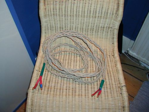

I would like to share the following experience: Today I connected my gainclone to my speakers using my DIY Cat5 braided cables, the FFRC, from the TNT website. This was the first time I tried these cables on the Gainclone.
The left side lenght of the cable is about one meter, the right side about three meters. Right side speaker made heavy distortion or something like that. It didn't sound healthy. I though the woofer was damaged, but it's not...!
My gainclone just didn't like this high cable with this lenght. With three meter cheap cobber speaker cable, everythings is OK.
Does anyone have similar experiences with speakers cables? Which types of speaker cables are best suited for Gainclones?
