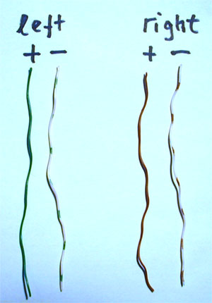

Fedde, I'm not sure if I understand you correctly.
Like this...?
Use only one twisted pair of CAT5. To lower the capacitance untwist the wires. It works. It's not something to die for but gives decent results.
In general - I don't thing CAT5 is good for audio. OTA is thinner - 26AWG, OFC. There is something in the CAT5 that spoils everything. But feel free to experiment. Two wires give the best results.

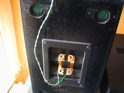

I use 'em twisted. Can tell no difference on my present speakers if twisted or untwisted. For the time being these cables will do fine
Like the look and feeling of such thin cables.
And I have no problem with oscillation, whatsover...
Uses same lenght now, 3.5 meters each.
/Jan

Are you driving woofers with that green/white cable?
If you do I'd say it might be a bit too thin.
Or do you mean you took a pair from a Cat-5 and that's what you're using?
It may sound fine at lower levels, like a few watts, and some tube amps driving horns were commented as sounding find. But serious levels requires wire area.

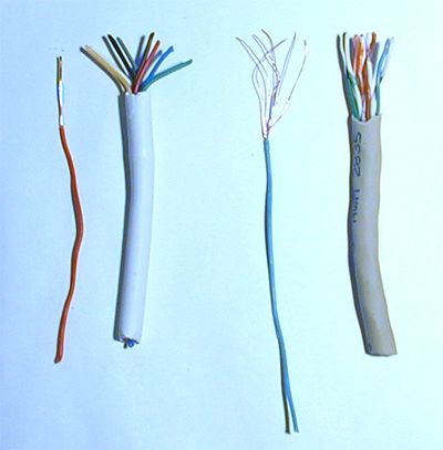

Nuuk, LCAudio sells this silver coated Stripline, that I use for line level wiring. I don't see why this wire cannot be used as speaker cables...
Below see pic of some phone cable I had. This cable - to the left - is used for my 2Mbit ADSL connection. Note that each strand is one thick copper wire, whereas the Cat5 on the right has several thin copper wires. I believe this cable come closer to the wire used in the OTA cable...?
I have now made a speaker cable with this phone cable and maybe - after burn in - I'll get more bass, I dunno....
/Jan

I use solid core CAT5. It has high quality copper. Only the insulator is not so good. I wouldn't use stranded CAT5. It could be that single wires give less bass at higher volumes. But I am not so sure. The definition of less bass is not so clear too. Frequency wise not so much happens I guess. But the difference is in tightness. Tighter bass has less 'width' of the bass. Then it seems that there is less bass, but wait till you hear a church organ 😉
I think that is the thing that people experience when they say the GC has too few bass. Some people prefer wooly bass (no offence!). In a disco or cinema I like fat bass. But a tight bass is more realistic.... :nod:
Fedde
