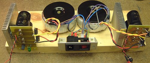

Just an update - I've converted my GainClone to dual-mono. You can see the origional version here, which used an 18V 120VA transformer to power both channels. Attached is a pic showing a pair of 25V 160VA transformers
I wasn't prepared for the improvement in sound quality! The imaging is much, much better, and the amplifier is more dynamic and powerful. I haven't detected any loss of bass with the 25V transformers. It's funny - we all know how important the PSU is, but it's nice to demonstrate it now and again
There's lots more detail on my homepage, including details of the cases I plan to use.

Mark - excellent idea of prototyping on a plank of wood, I've done a similar job with my PSU as the 'boxes' I have ordered are out of stock at Maplin.
And thanks for all the information on your site. I don't think that it is possible to read too much on any subject like this before building a Gainclone for yourself. Although I'm well on the way to completing my own amps, I found it very interesting to compare notes with your design.
One question - what did you use for your rectifier bridges?

Hi Nuuk,
They're just standard rectifiers - IR (International Rectifier) KBPC601 - they probably came from Farnell, they're just what I happened to have in my "stores". As you might have read on my page, I'm about to try some MUR860's
Glad you found the page useful. I've been meaning to email you and complement you on your "Decibel Dungeon" site - great site! I sometimes find it tricky to find my way around - have you got a "site map" page? Wouldn't want to miss anything!
Also, I love your GainClones - I've never thought about veneering a drainpipe I'm been meaning to ask - are the two holes on the front for the speaker connections?
