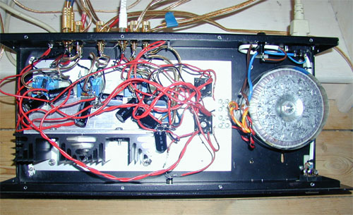

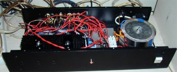

cable between PSU and amp
I've now upgraded my Gainclone with one more channel so I now have four channels total, and I use it as my main amp + surround amp (no center speaker).
One 300VA 25+25 for four channels. Two bridges. Plenty of power in my small room..
I tried Cat5 cable (like on Feddes Thor Amp) between bridges and amps, but now I use cheap cobber wire, cause I had no room for all those Cat5 cables in this small case and I nearly went crazy with all those wires 😉
This propably degraded sound quality somewhat and soon I'll rewire with better cable. Which cables are recommended between PSU and amp?
The case really looks like a bird's nest now. Although I have no hum.
Is speaker phase normal as in any other amp, or does the inverted circuit mean that one should reverse phase on one of the speakers?
What about absolute phase? I changed absolute phase and got much better bass on some other speakers, I tried it on....
By the way: Allen-Bradley feedback resistors, Caddock 0,2 R in output. Roedenstein MKP1841's. Standard 1000uf caps. Will try some better ones sooner or later.
/Jan
/Jan
