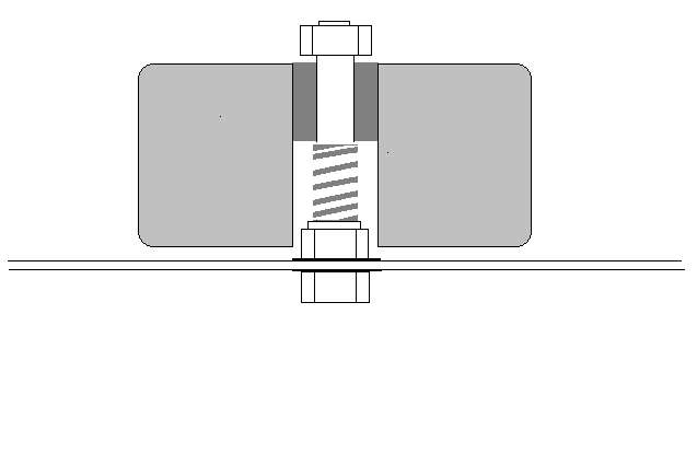

Peter,
I have seen toroids held down with cable ties, and I have seen them broken due to heat and/or transporting.
Carlos suggests mechanical isolation mounting, and me too - I suggest a spring sort of like below is likely advantageous.
Eric.
Bricolo said:I don't clearly understant the concept
the transformer will not touch the case's bottom
A screw will be fiwed at it's bottom to the case, and at it's top to the transformer, but with a dampening material
am I right?
The dark grey is solid epoxy or whatever material that glues and fills the middle of the transformer to say, half way down, and has a tubular hole through the centre.
A bolt and locknut are fixed to the bottom of the case.
A spring is fitted over the vertically mounted bolt, and the transformer/epoxy centre assembly is fitted over the vertical bolt and slid down to engage the spring.
A nylock nut is fitted to the top of the vertical bolt to retain the transformer, but has clearance.
This enables the transformer to 'float' on the spring, provided that the vertical friction is minimal, and that the spring is soft enough to isolate the transformer and cabinet from each other.
Brass bolt and nuts might be best.
Eric.
BUT if the vibrational energy from the transformer doesn't go into the casing, where does it go? It can't disappear according to science. Will it instead add some sort of frequency 'boost' to the power line? (I don't know this, I'm only suggesting it)
I always remove transformers from the case containing the circuits/CD drive etc. If I still wanted to negate their vibrations, I would build a box with a false bottom and add dry sand to the lower compartment. That way the vibrations agitate the sand particles which rub against each other and transform the energy into heat.
An alterantive if you want to keep transformer/power supply and circuits in the same case would be to create a base plate beneath the base of the casing and bolt the transformer to that, at the same time isolating it from the case (in a similar arrangement to the one suggested. The casing would then be isolated from the new baseplate by whatever means are preferred.
