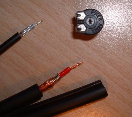

Is this a problem if I use shielded cable (see the picture in one of my previous posts) even for the grounded pins?gpapag said:

I only have those 2 (the big one and the little one, I plan to use the big for output and +/- rails)
Bricolo
You may have problems routing this thicker cable. But technically speaking, No there is no problem in using this cable.
Regards
George
OK, when I'll finished (after I'll started it ) the case fot this amp, I'll use the shielded cable
the thin one seems to be 23AWG, the big one 20AWG

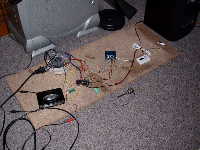

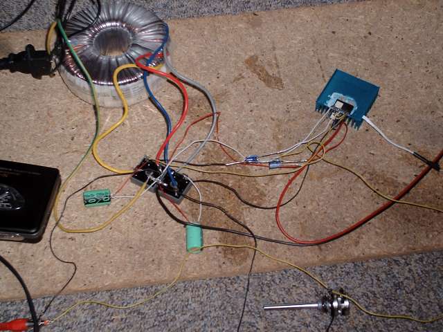

for the momment, I'm using such poor cable, and everything is on the floor in such a mess. I'd be banned from this forum if I post a photo of my setup
but it works (except heat problem that seems to be oscillation)
Bricolo said:for the momment, I'm using such poor cable, and everything is on the floor in such a mess. I'd be banned from this forum if I post a photo of my setup
What do you mean? Show us the chaos... not everyone is Peter Potter
