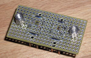

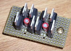

Peter, could you post a pic of your rectifier build? Did you make a PCB for them like your Alephs?
Here's how the bridges look. I placed the diodes in a way to achieve minimum connections. Two 4.7u N caps are on ea. rail between diodes.
K with A connect on the outside and this is where the 4 wires from secondaries go (through the large holes). Eight pins in the center are for 8 wires going to the amp. Two K and two A of four diodes pairs are connected with short wires on a components side. This is mounted directly to the rear panel of PS enclosure. I didn't really see a reason to make PCBs for that.;)

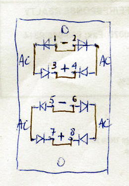

Here's the schematic of my bridge. Pins 1-4 create nodes on the DC side of the bridge for one rail; the other four pins, for the other rail. The 4.7 N caps (2 of them) are connected between pins 1 and 3, and 5 to 7. There are 8 wires from PS, and the ones from odd number pins go to one channel and the ones from even number pins got to the other channel. The grounds for both channels are connected on that board.
There are additional 4 x 1000u/50V caps in the amp (2 per chip). I didn't put any small caps across the diodes. First, there is not enough space, second pinkmouse tried it and reported that they soften or smear the highs. Another observation I made: I tried to use a nice 10A, Swiss made AC line filter with the PS and I didn't like it. I observed similar effects as PM reports.
