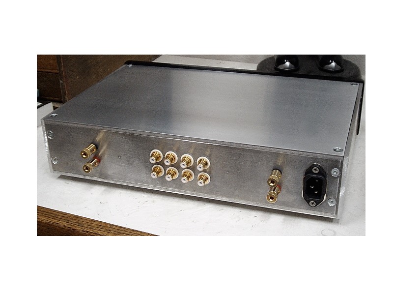

Thanks for the compliments all
The chassis is homemade, even the knobs which are 1.5" 556 silicon bronze. Nice and heavy and add a nice feel to to the volume and switch. Great stuff to work with, by the way. The PSU filter caps are surplus 1000uF/50V Rubycons , the snubbers are Phillips MKT 1uF/400V. Using Mills 10k on the input side. No output resistors. I also have some Caddocks to try but have heard they are dry in a GC. I have some polycarbonate caps and might give protos suggestion a whirl as I prefer a warmer sounding amp.

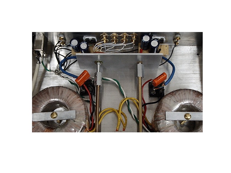

Its sounds great! Smooth, clean and neutral. A bit forward as others have stated. But I knew that from my prototype. It had a little edginess until I put the caps on the bridges, which smoothed it out nicely and the bass tightened up even more. Not sure if the edginess was due to the new BGs or the $14 toroids/$3 bridges I am using. I'll wait and see. I wanted to use BGs on the bridges like you did but only have a couple left and want to use them for another gainclone a friend wants. I will try the discrete MUR860s once the caps break in. The bridges in now are GenSemi out of my prototype with about 100 hours on them. MUCH better sounding than new NTEs I initially built it with. The pot is a $8 carbon 50k log. No balance problems though. The NOS ALPS I bought are indeed balance pots, one is going into an integrated AX I am planning . I am looking at future pot options as well. An easy fix though. The cones are something I will consider for the future as this amp is going to my daughter when my Aleph X is done. What cones are you using, Peter? Are your production models getting them?

I put the 1uF mylars across +/- DC outputs of the bridges and immediately notice a smoother delivery. Peter is using BG 4,7uF across his discrete rectifiers.

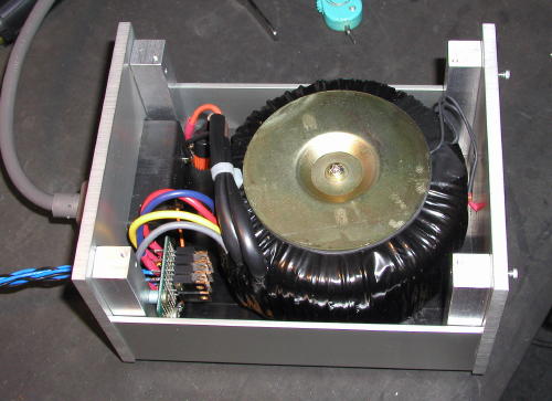

Peter, could you post a pic of your rectifier build? Did you make a PCB for them like your Alephs?
This is a pic of a rectifier. I'm currently working on rectifiers for new supplies, but will not bother making PCBs. I'm using protoborads and p2p wiring. When finish, I'll post a pic.
The cones I'm using currently are sourced locally, they are made out of brass and I found them sounding better than some more elaborate spikes. Will postpic later too.
