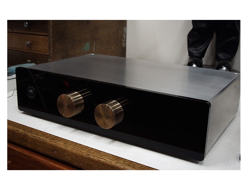

Just another integrated Gainclone
This is it. My humble attempt. Laugh if you will, but it makes me happy. 😉. Four inputs wired with 21AWG silver wire (easy, Frank :wave: ) and I added the BG4.7 Ntypes. How long do you think it took your input caps take to break in Peter? I had the copper shield all cut when I decided to listen to it as it sits and since it was dead quiet, I left it as you see it.
