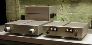

Peter Daniel said:
I didn't want to give a customer a reason for a doubt if I used BG or not.;)
BTW, my acrylic GC has the caps skinned, but the first one also didn't and it sounded better.
So you remove a thin layer of plastic from the caps and then put the whole amp inside a block of........PLASTIC:eek:
could that be why it sounds bad:idea:
There are plastic and plastics. It's not that it sounds bad, it just doesn't have that extra touch. One way to get to know, is trying different things. What if it would sound better and I would've never tried it?;) So don't blame me for that.
Here's another pic. Proper light and tripod makes also things look different.;)

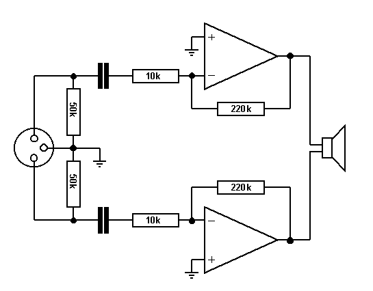

Hi there,
Very interesting thread indeed. And beautiful too, thanx to Peter ;) .
I've read the thread all along, but something still puzzles me... Sorry if the question seems absolutely dumb, but If the GC is used in an "inverted" configuration, thus the amp is an inverter, I still don't understand why the "+" of the speaker is not connected to GND while the "-" is tied to the chip's output. This is done in the Zen design, but not here... Am I totally :crazy: ?
Apart from this, I've had a little idea for combining balanced input and more power... As bridging means having two signals of opposite phases, why not trying to use both signals of a balanced line to drive two amps, and connect the speaker between the two outputs. I've attached a little drawing of the idea. Is it worth testing ? Feel free to flame or praise :cool: . Notice that I didn't mentionned the polarities of inputs and outputs, since I don't know the answer to my first question ;)
Re: Bridge over trouble balance...
question ;)
In the pictures it is not but it is of course up to everybody how they connect their speakers. Just like my Zen R I do connect the speaker in absolute phase on my GC. Why would one not? Lots of people are picky about absolute phase and want switches for phase on their pre-amps but in this particular thread it is often neglected. I did ask the same question as I felt it justified but the reply then was that there was no need to be anal about it. I just can't see any reason why one would not at least aim at correct phase as the work involved is nonexistent (solder 2 cables one way instead of the other way...). I say do it..

The amp inverts phase indeed Peter, after all this topology is called an inverting amp. So reversing the speaker connections does make sense when one emphasises on absolute phase. It may come handy in case you use a non os DAC. Both devices invert and absolute phase will be correct again. This can possibly be a stimulation to build a Kusonoki style DAC :nod: Just don't say it was me that made you do it !
Jean-Paul :wave2:
