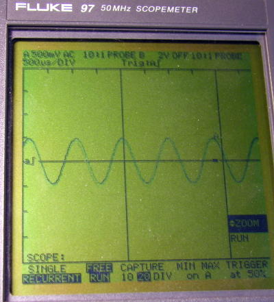

jean-paul said:The amp inverts phase indeed Peter, after all this topology is called an inverting amp. So reversing the speaker connections does make sense when one emphasises on absolute phase.
Maybe I'm checking it the wrong way, but if this is the input signal:

Inverting?
Hi Peter,
can you display input and output on your Scopemeter simultaneously? If not how do you know that they are not inverted? I notice that you have your scope set up for positive edge trigger. In this case the scope will show the upslope of the signal at the left hand side of the screen and hence will move an inverted sine by 180 degrees.
You might want to try triggering your scope off the input signal whilst measuring the output signal ( if your scope allows this ). Alternatively use a signal which cannot be confused if it is inverted e.g. a ramp.
James
Hi Peter,
James

James,
That's a very good point. Since I'm not using the scope that much, I've never thought about it.
Of course the best way is to use both channels and see both waves simultaneously. My mistake. I was rather surprised seeing the same wave pattern on both input and output, but thought that scope would not lie.😉
Thanks for clarification.

Peter Daniel said:I would imagine that for amp reversing phase, the sine wave should be reversed too, but it's not. This is the output.
As nemestra mentioned this explains it. Your scope triggers in the same position on the wave and it looks as they are the same phase but displaying both would show that they are not.
Thanks.
