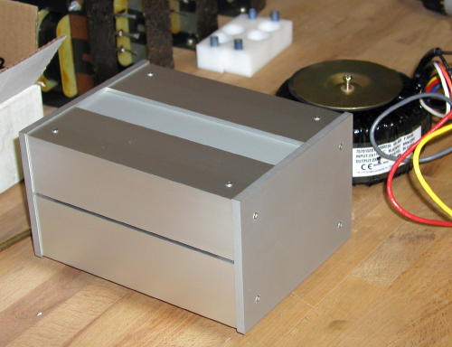

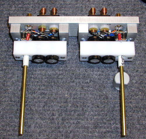

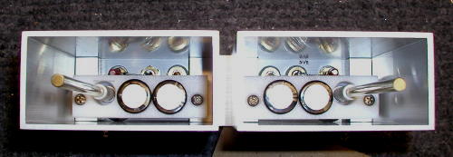

I am curious as to how you attach the front and back plates to the two extrusion sections that make the body. Would you be willing to share that secret?
As you see, there are 5/8" bars attached to front and rear panels. The size and placing of the bars is such that the square tubing fits tightly over them. There is actually no need for extra fastners, but I'm placing 4 screws at the bottom to make sure it stays together.

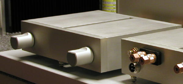

I didn't want to give a customer a reason for a doubt if I used BG or not.😉
BTW, my acrylic GC has the caps skinned, but the first one also didn't and it sounded better. The bit to drill the holes is 7/8" and when I skin the cap it is loose, so I have to put the tape around it anyway. Since the first amp sounds so good, I decided to do this one exactly the same way. The only difference is a resistor in the feedback loop. First one had Holco, this one is using Rikken, I can't get Holcos anymore.
