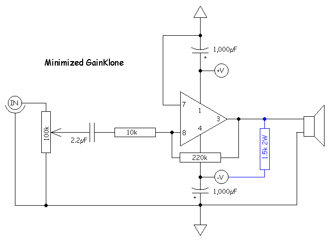

Since I got few emails regarding the schematic, here it is again. I didn't like the blue 1K5 resistor and I find that circuit sounds much better without it. My coupling cap is 4.7/50 BG N. PS is using 400VA double 22V secondaries and the rectifiers are MUR Motorola diodes. The umbilical cord is 8 strands, run side by side, of silver plated copper stranded wire in teflon insulation. There are two bridges, one for positive, one for negative rail, used for both channels. So ea. channel is powered by 4 cables, with separate grounds, connected together at the - speaker terminal.
No capacitors in the PS unit (even small ones). At the amp, I'm using 2 x 1000u/50V BG electrolytics per channel. Also the pot is log. with 50k resistance (both halfs of 100k in parallel).
I'm using 3 spikes under the chassis, and they improve the sound evidently.

BTW: In the amp you mentioned do you have a single supply for both channels ??? You can interpret the text in two ways!
I'm always using non insulated version with berryliun oxide washer. I think that heat transfer is better this way. Yesterday the amp got pretty warm during the session (I would say 40-45 deg C). Even when played loud it didn't loose control, but the speakers, based on Dynaudio drivers, were not very efficient (87 dBor so). The amp has single supply for both channels (1 toroid, 2 bridges). Toroid is 400VA though.
When I tried the amp with 1k5 resistor from output to - rail it was day and night. It lost all the magic when resistor was connected. Regarding, comparison betwee the two gainclones, it seems that they have similar character, but again the other one is producing more magic. In other words it is more open and musical with subtal nuances portrayed in somewhat better way. And there is absoutely nothing to complain about the bass. BTW, the guy who keeps my amp used to be a Cello player.;)

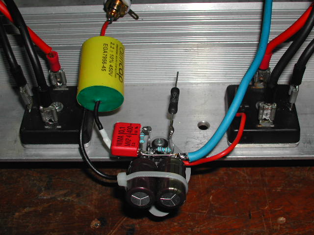

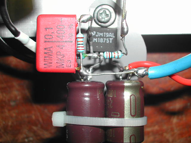

I finished building my GC 2 hours ago and have been listening to it till now, even as I type this message. First impression, (when music is starting), it was surprisingly good for such a simple circuit. I thought it was sliiiightly less detailed than my commercial Yamaha BX-1 Class A amp. I hope it will improve as it is breaking in. I am using Mr. Thorsten Circuit with regular resistor and capacitor with the exception of the AuriCaps for the input coupling (WIMA MKP4 for the 100nf). I will try to attach some pics later.

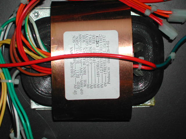

ok dokie - ive given up with the transformer adding wires (i dont see the point) - so how many turns would i need to remove?
my amplifier is very close to being finnished - i need to sort out the transformer (its currently a 300va 30v transformer - needs to be about 25v)
and i need to find some 2.2uf film capacitors and some high Amperage wire (sounds like a trip to maplins)....
Peter Daniel said:
I did that on my toroid, to get 18V out of 24V. I had to remove around 4 to 5 feet of wire. When you do it, you can take readings in a meantime, so you can't go wrong.
When you remove the wire, you don't have to go to maplins, because you already have some high Amperage wire.;)
