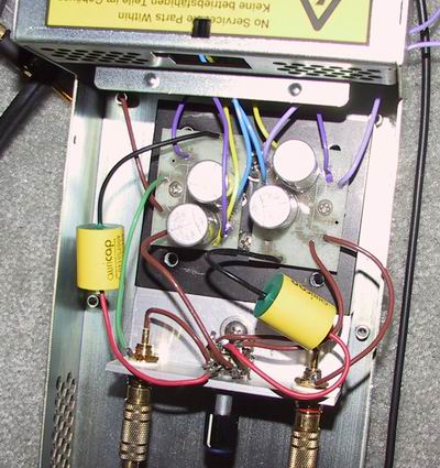

Clever idea with chip mount and PCB. If I see it correctly, the screw is not attached to the PCB and the chip leads are bent the other way. In a long run it may put too much stress on the leads. How about using plastic spacer between board and chip, so the screw will hold the board as well?
Yeah, the pcb-chip connection is only 5 chip leads strong. I like the plastic spacer idea.Peter Daniel said:Clever idea with chip mount and PCB. If I see it correctly, the screw is not attached to the PCB and the chip leads are bent the other way. In a long run it may put too much stress on the leads. How about using plastic spacer between board and chip, so the screw will hold the board as well?
