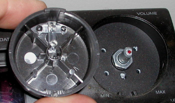

The POT has a bigger diameter than the knob, no way i can feed a line trough! And as you can see a couple of posts back, there is not that much room inside the GC aswell.
Basically you need one wire to the LED, the knob shaft and chassis acts as ground. So if one pin of the LED touches the knob, you need one wire to supply the power. If you bore the back of the knob, it will provide space for the wire to fold. Make a hole in front panel for the wire to go out and attach to the LED. It's a simple solution but it should work. Make sure that the wire is flexible enough.
Peter Daniel said:Basically you need one wire to the LED, the knob shaft and chassis acts as ground. So if one pin of the LED touches the knob, you need one wire to supply the power. If you bore the back of the knob, it will provide space for the wire to fold. Make a hole in front panel for the wire to go out and attach to the LED. It's a simple solution but it should work. Make sure that the wire is flexible enough.
Sorry, but the shaft is plastic, however we could use the nut from the POT to act as ground. I think i'll try it tomorrow, but first i have to find the LED's we want to use.

Sandy H. said:Glue the LED in with a 2-part epoxy after soldering 18-20ga stranded wire to it, 2 or 3" longer than the LED. Wrap the wire 1 and 1/2 turns around inside the torroid in the back of the knob and through an 1/8" dia hole in the panel. The 1.5 turns will act as a spring when the knob turns.

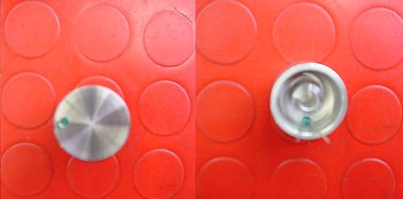

Jerry T. said:Thanks for all the info guys, this is what i've done.
All i have to look into now, is how to get the wires trough the chassis. But that shouldn't be a problem now!
PS. sorry for the poor quality photo's, but you'll get the idea.

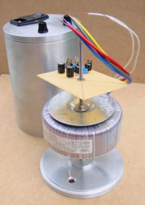

Here is an update of the Power Supply section. Now that I'm mounting the small board with the rectifier I'm wondering how these were mounted in the original Power Humpty.
I'll use only half of the board as the tube is large enough to accomodate two transformers. This way i'll leave room for two separate power supplies in one tube. Anyway I was just wondering whether there are smarter ways to get the rectifier section in the tube apart from the way shown on the photo...
Pictures floating around on the internet of the "original" gaincard (if of the original) give a messy impression, but maye the Power Supply was of higher quality. Anyone pictures of the inside of a Power Supply of $3000?

Maarten,
In your power supply configuration, will not the threaded rod through the transformer and the aluminum case create a shorted turn?

Good point! They even warn for this in the manual of the toroids. You can destroy the toroids by allowing current to pass through the bolt!!!
Fedde
Fedde
I don't see any difference between mounting the toroid the conventional way, or like we have done?
Instead of the normal bolt we have used a longer one, for the rest we use the same parts that come with the toroid.
But if there are any problems i can make nylon covers for the toroid.

I am fairly sure that because of the way torroids transformer works, it is not a concern to use metal rods going through its center.

That will not help. The point is that current will flow through the bolt! The current can go through the bolt and return via the case. The primary side will induce currents and it will be a short. The only way to avoid this is to isolate one side of the bolt. I don't know what happens if you isolate the two sides of the bolt and mount two toroids on it. I think that will work...
