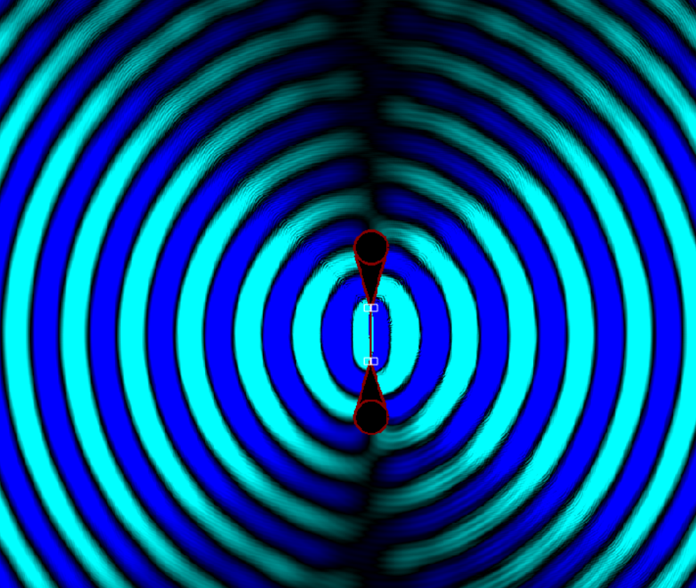

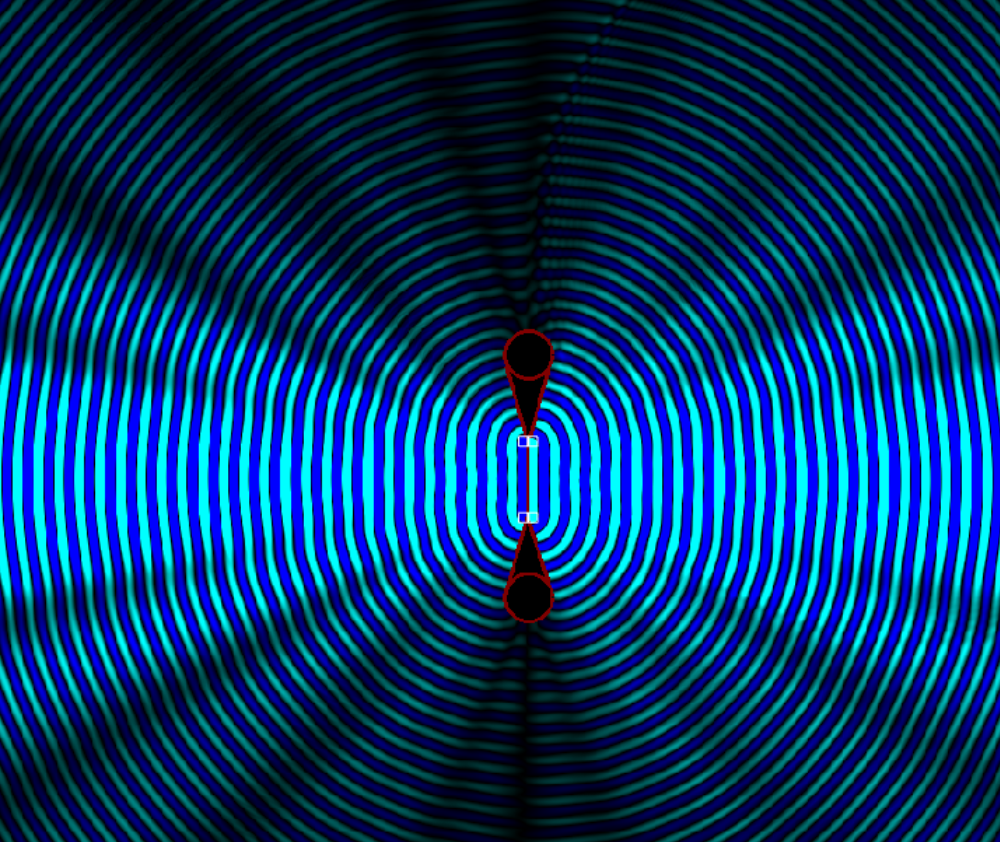

We are playing at very high frequencies which could make things sensitive. This isn't a spherical source, but the conical shaped diaphragm looks even worse. Also the length of the line may not be at the right scale to see the solution clearly.
What is the cause of the nulls?
It looks to be behaving more like a driver in a flat baffle although no nulls directly on axis

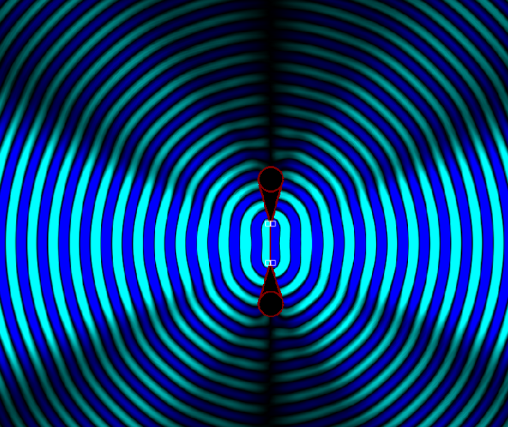

So, if it's possible Scott, could you repeat the procedure as per post #36 (or #39) but add a gap approximated to an 8" driver in between and include that triangular 'extras'?

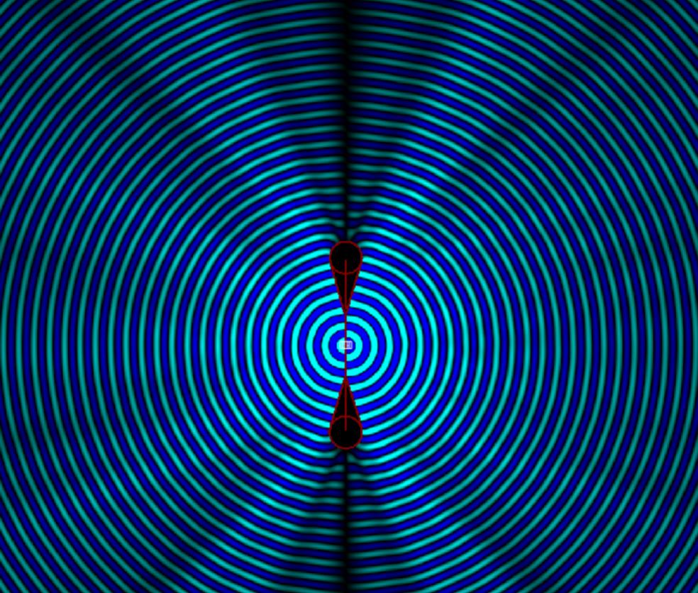

Like this? It's behaving similar to a flat baffle again
Hmm. Can we deduce from this that at higher frequencies where the driver operates as a point source, there are fewer 'nulls' but as the driver produces longer waveforms, the 'nulls' reappear?
The modelling appears to be consistent and the next question would be how closely does it represent an actual physical driver and how do we go about evaluating this?
Does the same pattern change significantly if the angle of the triangles is doubled to 60 degrees? Also, can you can alter those 'gap triangles' to have curved sides like a parabolic function, and if so, would this change the overall pattern of nulls (assuming such a thing is possible)?
I've often wondered if a waveguide on a FR driver baffle would reduce the uneven radiating pattern like the spherical chamber does and here we are, actually modelling a similar thing, and including the rear surface too!
When I suggested a donut/toru, my idea was for a LF dipole source, not a HF waveguide. The sims that you are showing seem to be at a very HF - short wavelengths. I would not think that such a design would work well above the point where the wavelength/2 is about the size of the source.
That certainly seems effective above the dipole peak https://www.diyaudio.com/forums/multi-way/361169-polar-response-frame-ob-speakers-6.html#post6370340 The wave guide appears to help eliminate nulls higher up and makes the off axis null consistent. Of course the tool doesn't take into account the driver.
Yes, I was thinking it would be better to come back to the frequency where a plain dipole sees its first HOM, and work up slowly in frequency.I would not think that such a design would work well above the point where the wavelength/2 is about the size of the source.
It began because the sim has no frequency scale.
Not sure whether OS can bring out a very long straight source to spherical? (Though it's probably moot with trying to use drivers this way into breakup). I feel if so it would take a device impractically larger than the current toys. Better cross that bridge when we get to it.
The sim doesn't know anything about drivers. The waveguide eliminates the largest on axis null which is the first one above the dipole peak. A flat baffle with round over doesn't have the same effect, see attachment. The sim isn't clear on the first null, tricky to get frequency low enough to show it properly.Hmm. Can we deduce from this that at higher frequencies where the driver operates as a point source, there are fewer 'nulls' but as the driver produces longer waveforms, the 'nulls' reappear?
It becomes more horn like if the angle is increased, not something we want I don't think? I've tried parabola, no real differenceDoes the same pattern change significantly if the angle of the triangles is doubled to 60 degrees? Also, can you can alter those 'gap triangles' to have curved sides like a parabolic function, and if so, would this change the overall pattern of nulls (assuming such a thing is possible)?

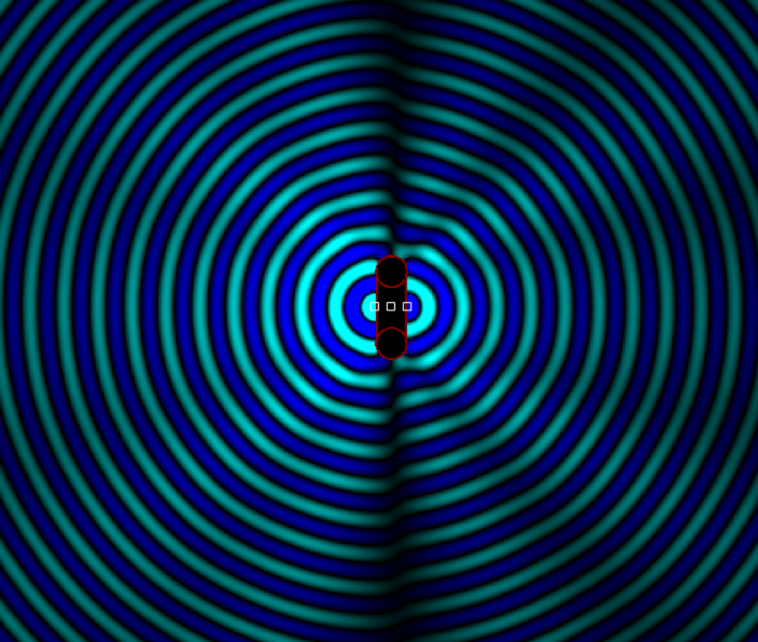

This doesn't seem to be representative as I can't get it to produce a null directly on axis.Do you want a finite source .txt?
An OS is for a circular source. A Prolate Spheroidal coordinate system allows for a long thin line to be made spherical. This is covered in my book. There is also the elliptic cylinder as a close approximation.
