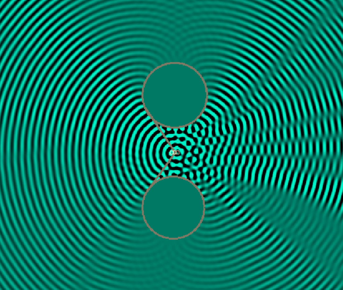

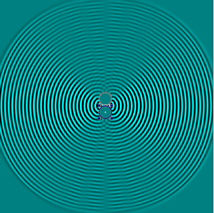

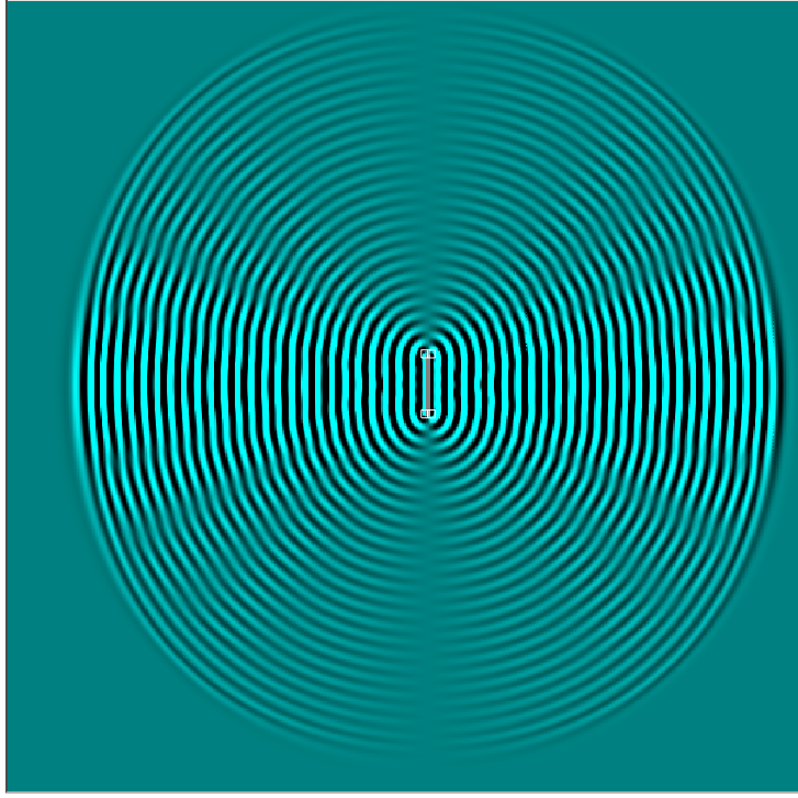

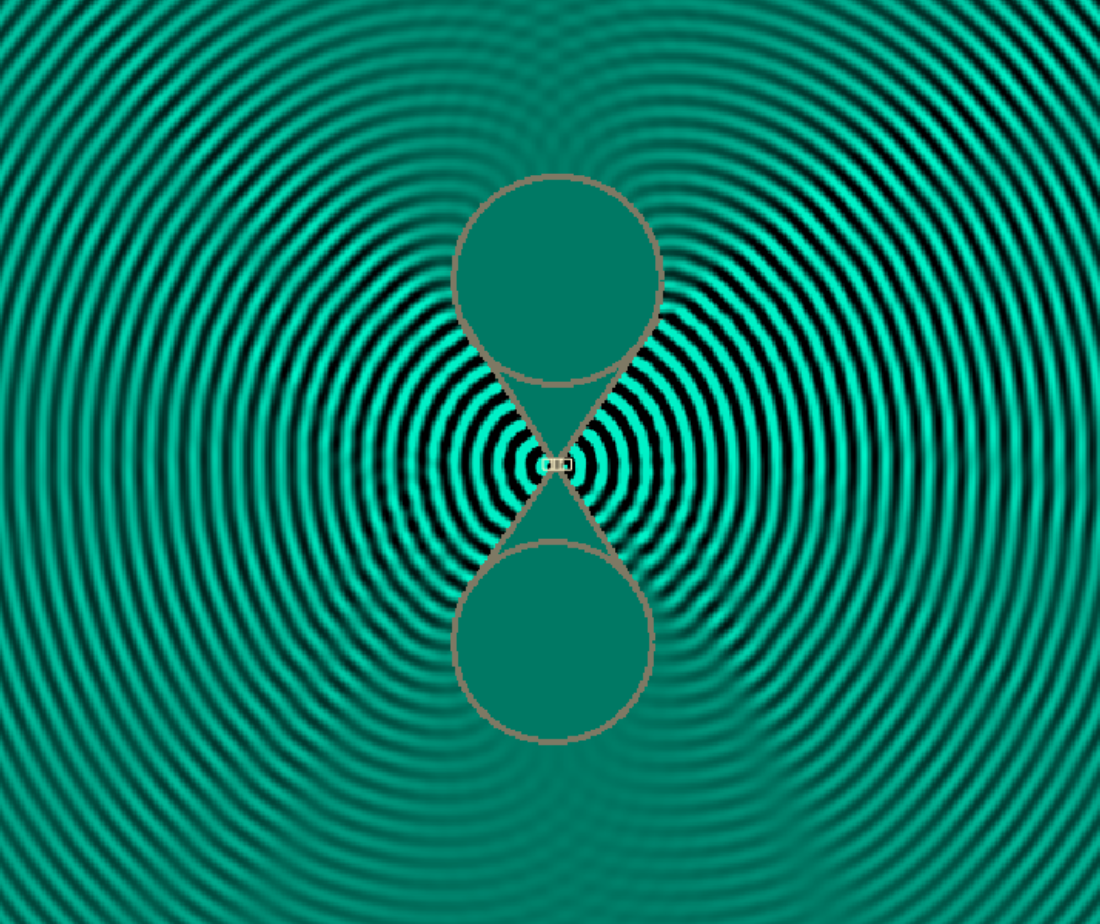

Yes, the toroid is interesting. Having a raw driver with no baffle gives a high level of cancellation.
But look at this almost ideal looking high frequency behaviour, none of the other simmed shapes works like that up high.. (idealistic raw driver (second image) for comparison.
OK, this is too simplistic a model to make generalisations, and poor choice of frequency, but I think it says something about the potential of the toroid.

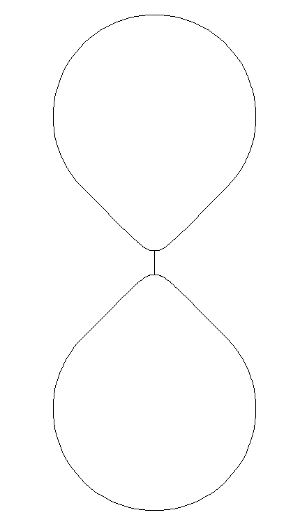

Perhaps it should start out as OS?
Umm Alan, pardon me but where does this "OS" profile come from, and why would it be better to start with it?
In the interest to reduce the overall size, can this profile be 'squeezed' to be a 'more squat' vertical profile (= same surface perimeter) without compromising performance?
Don't pay any attention to the relative dimensions. This is a concept, and I haven't tried it, though I'd be interested to hear what others have to say.
However I'm noticing that with the right baffling you can get higher frequency extension with dipole like behaviour. What this OS option may offer the higher frequencies is a reduction of diffraction over the purely round version. The effect at low frequencies should be minimal.
