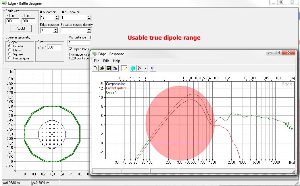

Now, after having read Siegfried Linkwitz "Diffraction from baffle edge" article, I must assume that the round baffle for the midrange in this OB is a very bad idea... or do I need to unlearn something

drterbi, you and SL are right.
A perfectly round dipole has very narrow range of operation (usable passband) Above dipole peak (here at 500Hz) the speaker loses directivity and slowly exhibits normal directivity. This leads to difficult power response and easily to difficulties in achieving balanced sound in typical small rooms with lots of sidewall reflections.
Also the tweeter of this Seligkeit is a very poor "dipole" practically.
But the slot-loaded bass should work fine!
We see this kind of problems in almost any commercial "dipole" loudspeaker. Dipole 8-directivity is lost typically above 1000Hz.

In this design I would assume that the tweeter is not much of a problem, due to its small baffle and directional on-axis output.
But for the midrange, as Linkwitz states "the magnitude of any diffraction effect is greater at the low frequency end of a driver's range." So I would assume that the large baffle around the midrange would cause large dips and peaks all over the place?
Thanks. The red marking looks like trouble.

^Yes, avoid loosing pure dipole radiation/directivity range, then you won't get edge interference ripples! This means a 4-way speaker and dsp for eq and steep xo and still one will eventually hit the physical limits around 5-6kHz and get diffraction ripples and loose uniform directivity. And anyway vertical directivity is a mess always!

Generally circular baffles would be a bad idea. However, with an open baffle speaker there are other considerations. For example if the band pass is limited to the frequency range below the first dipole peak, a circular baffle will be superior in that the response will have the same off axis variation regardless of where it's vertical or horizontal or anything in between. Additionally, if the diameter of the baffle is chosen such that the driver becomes directional before the first dipole peak is reached edge diffraction is minimized as a problem. So, with careful design considerations, a circular baffle, even with a conventional speaker, can yield superior uniformity in special response. Like most things, the devil is in the details.

- This is either very wrong or I have still not understood diffraction from baffle edge
