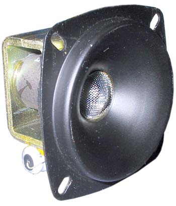

A small horn tweeter that is often found in old Sansuis... so probably made by Atomix. Model T50
Reminds me, Al did you pop out the metal screen before you measured them?
I usually see them used ~10k +

Having a metal screen in front of a tweeter really messes things up when you measure with MLS signals. I would recommend doing a gated sweep to see how they compare.

soongsc said:Having a metal screen in front of a tweeter really messes things up when you measure with MLS signals.
The impedance curve smooths out with them gone, so i assume it has some resonances.

I left the grille in, simply because I couldn't see a simple way of removing it. Does it just pull out, or do you have to dismantle the tweeter to get it out?
i just stick a pointed stick in (metal works best). lift an edge and then use a set of needlenose if it balks. It is just glued to the horn sides.
