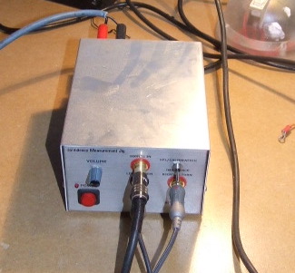

Boy, do I feel like an asss. After 5 hours of reinstalling sound card and the drivers (because SE would not see the input no mater what), reinstalling SE, testing sound card itself and bunch of other things, I've decided to start with simple staff.
2 new probes, I've made recently were constructed incorrectly! How could it be done, you ask?
Apparently in the hands of a talented new comer it can be!
Measurements are fine now.
