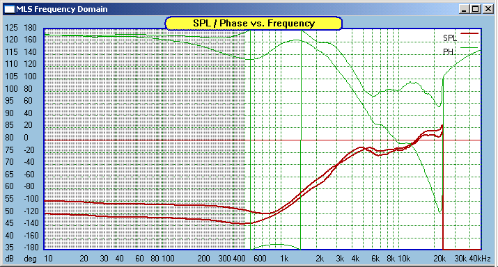

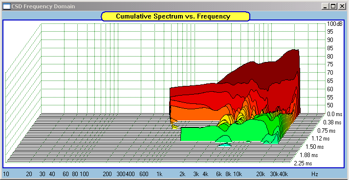

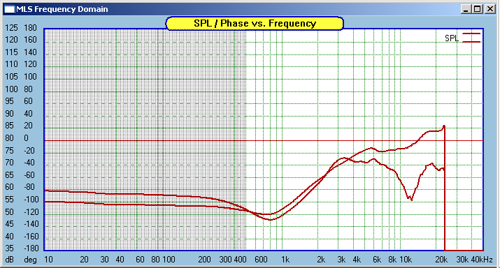

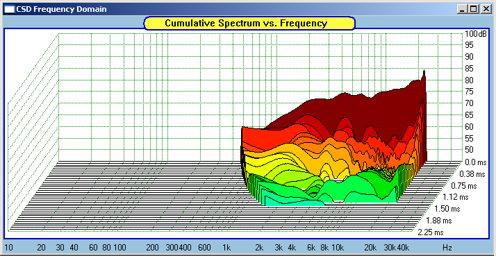

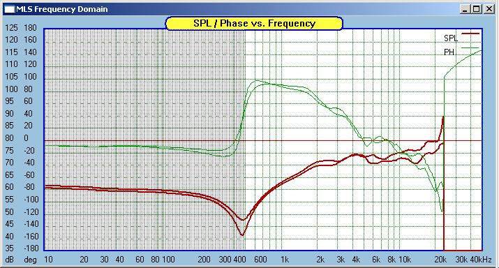

The audax and the unknown look nice Al.
Even the JVC is clean and good in its rather limited passband, your using a 4" mid so you'll probably be good on power response to around 4Khz, still leaves a bit of gap to the JVC though. Maybe with some small amount of compromising you could make it work.
From what you've shown so far I'd definitely say that Scan mid with the unknown tweeter. Distortion testing should be next up on the agenda and that could change things. I don't even need for you to post bass test results, I've heard the Volt B220 so that, I think, is a forgone conclusion 😉
