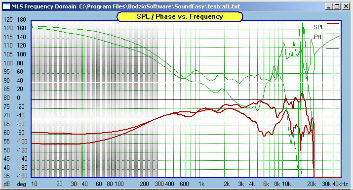

The scanspeak looks pretty smooth. How long until we have the distortion plots? 😉

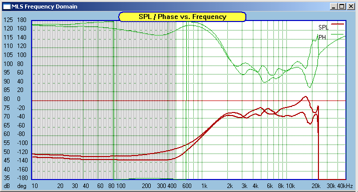

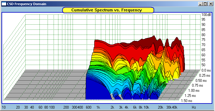

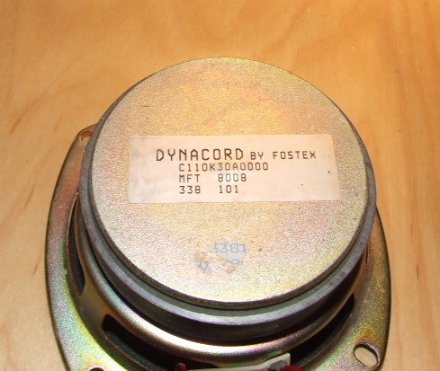

Okay here's the on and off axis for the Dynacords:

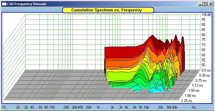

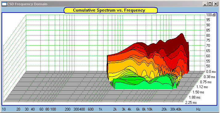

The CSD on that Scan looks very clean within the first fractions of a millisecond.
The offaxis looks better than other two as well. You could quite easily use a 2nd or maybe even 1st order filter with that as there's no real breakup to speak of.
Nice driver, what vintage is it?
I'd guess it's nineties from the styling, I really know nothing else - even google doesn't help. Have to get some more 12mm mdf to do some mounting plates for the tweets, so that won't be 'till tomorrow now, then we'll see if one of them has a nice roll off to match.

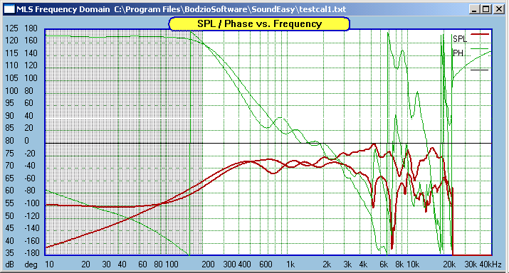

pinkmouse said:Next up, whilst my veggieburgers are grilling, the Fostex driver.

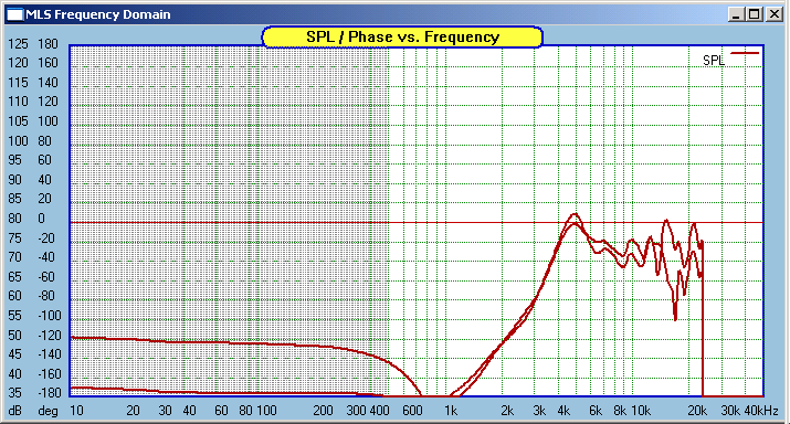

Well, after a brief interlude with much strangeness measuring my Tapped horn prototype, it's back to tweeter testing.
Up first, the budget Audax TM020G7. On and off axis FR graph. Look at the very smooth off axis response, this would be great for one of those upward firing omni jobbies.
