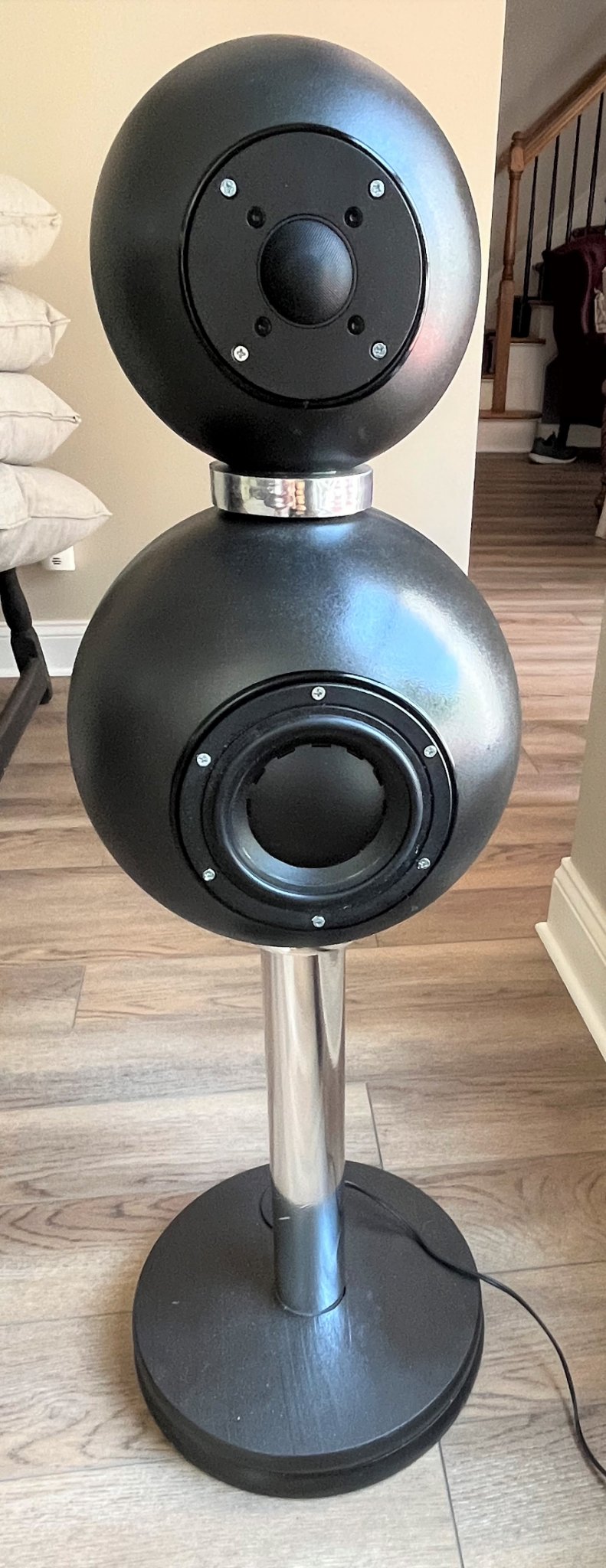

This is of course a very important topic and I have built both 2 and 3 way recently (actually 2 + sub and 3 + sub). I am a sphere speaker guy that has a great concern about minimizing diffraction effects and increasing soundstage. Spheres largely eliminate baffle issues. I also like to avoid larger cones as much as possible producing the mid or high frequencies, as the outer part of the cone itself can be a diffraction source. So I prefer domes for tweeters and mids. Metal vs. fabric? Metal is a bit sharper and has break-up issues but better transients, in general, while fabric avoids these issues. Domes also can have good off axis response. There are lots of good 1" - 3" domes available. There are also very good smaller cones (3" - 4") that address mid frequencies. As pointed out here, and I agree, for mid bass (mid-woofer) frequencies down to 100Hz or so, 5" - 6 -1/2" is probably where you need to be. For really low bass, subs are a solid option and relieve you of the larger cabinet problem for larger bass drivers. Plus you may need just one good sub to meet your low bass needs. Some larger designs have a couple bass drivers and bigger cabinets and that adds cost.
3 way can incorporate a mid driver that may be more precise in certain ways but as you point out, the crossover becomes twice as complex as you have two points to address rather than just one with a 2 way. Blending 3 drivers is harder than 2 (plus you have to buy 3 vs. 2). One of the considerations is that with domes for the mid in a 3 way, the lowest they can usually be crossover is 500-800 Hz, so that's right in the midst of the vocal range and many instruments.
So I tried a 2 way design so the 100Hz - 2000 Hz range could be done with a single driver BUT not using a 5"- 6" traditional shaped cone driver. I selected a Dynavox LW5004PMR 5 1/2" polycone (so not paper, not metal but polyester based) that can cover 100 - 2,000 Hz (and higher if you like) AND it uses a 3" VC, very uncommon. So it handles power and it has a dome configuration over the coil area, and then an outer cone to the rim surround, but overall the cone area is shallow. So the diffraction is minimized and the off axis better supported, i.e. its not "beamy" sounding in any way. The key thing is it covers the entire vocal range with a higher dispersion dome configuration while also producing the mid bass down to 100 Hz.
The next selection was an 1-1/8 fabric dome tweeter (a Dayton) that could crossover at 2,000 Hz (12 db/octave) and thereby provide the higher mids and treble with also a wider dispersion driver. Most dome tweeters can't cross as low as 2,000 Hz, but this one can. This also avoids the cone induced FR irregularities of the Dynavox that begin to occur at about 4,500 Hz and up. The overall result is a very smooth mid that you can listen to all day long and still crisp highs. The tweeter is more efficient than the midwoofer, so had to adjust with an L-Pad.
While the separate 2" mid dome in my 3 way (also a Dayton) can be a bit crisper in some situations, it can also be sharper with certain vocalists and instruments (also depends on the recording) especially at higher amplitudes. Since we are most sensitive in the mid area, there is a trade-off between a separate mid and a 2 way which may yield a smoother sound.
The 2 way portion is supplemented by an 8" sub, which gets down to about 40-45 Hz before roll off, enough to audibly reproduce well bass guitars and tympani kettles, etc. but a bigger sub of course will shake the room a bit more.
I find that 85 db (and peaks can be higher) is a safe listening level for the ears while also providing the dynamic range that makes music sound more real. While say 75 db is above "background" music, it's not enough to fill out the dynamic range. I have a typical decent size family room (20 x 20) so these fill it just fine. They could go easily above 90 db but that gets into the area of potential hearing damage especially if for any length of time. Plus the spouse or roommate may not like it so loud 🙂
So I looked for a 2 way solution (plus sub) that avoided using a traditional cone for the mids and avoided a higher crossover frequency (many speakers use 3,000 - 4,000 Hz).
Pic below but a little distorted.

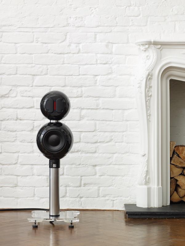

Well, they look cool, and there are definitely specific design choices that have been implemented!
Thx - attached is the Demand Better Audio Envy 2 - I kinda took some inspiration from them but the DBAs are expensive and have lots of hi tech aspects. The spheres are 1 mm thick carbon fiber, so you need a mold but also avoid problems of box enclosures plus they use extensive internal damping to avoid resonances (which I do as well). The woofer (I think it's about 7-8" so doesn't necessarily need a sub) shows a pretty larger dust cap "dome" to overall cone size, which I like. It's got a ribbon tweeter, pros and cons to that. A review (at least one guy's experience):
https://www.tnt-audio.com/casse/dba_envy2_e.html

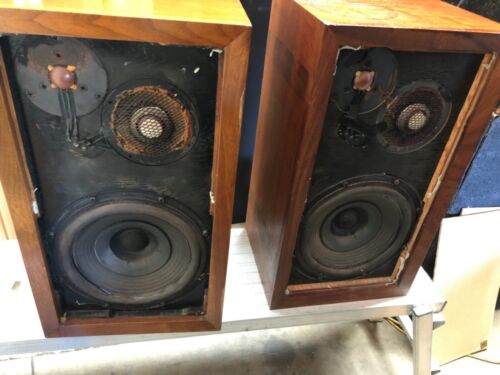

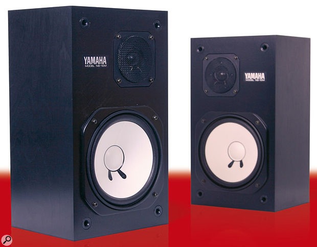

So attached a pic of an AR 3a, still IMO one of the best 3 ways ever made. Notice the CTC on the tweeter to woofer is prob. 8 in, maybe a bit more. Or how about a Yamaha NS 10? A bit less but not much. There are plenty of good speakers with CTCs that are not 5-6". If you have an 8" woofer and stick a 1" tweeter right on top of it which will have usually a faceplate, for example, your CTC will be about 6" min. So how much does an extra 2" make at 10 feet away?
I think the Envy's tweeter is a Swan, doesn't mean it's not good.
https://www.swanspeakers.com/product/view?id=597
You can take a look at a interesting video on the Vandersteen site about cone break up, and paper is prominently referenced.
https://www.vandersteen.com/news/the-truth-about-pistonic-driver-cones
I didn't mean to say an 8" woofer doesn't need a sub, if you're okay getting down to say about 60-70 Hz, an 8 is okay. If you want lower, then add a sub.
