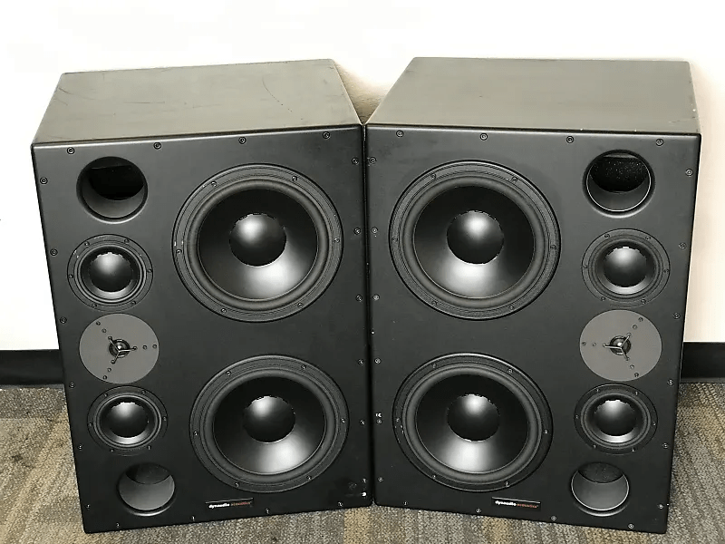

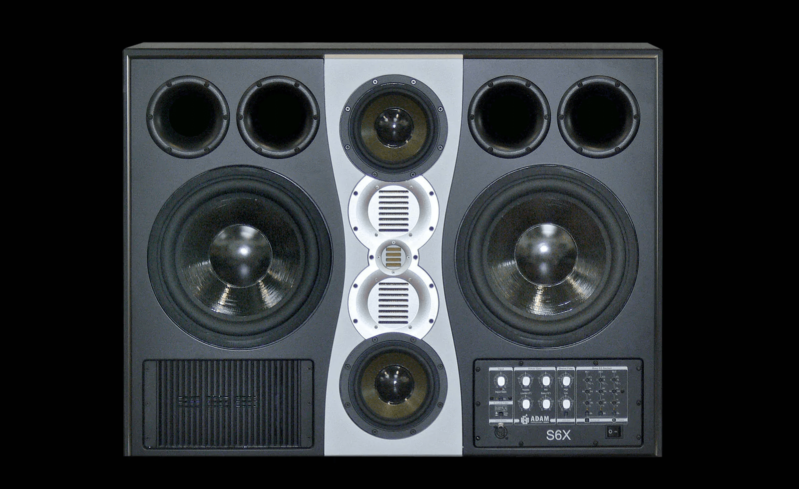

I'm looking at some large and expensive studio monitors, and I wonder, why are they so large? Why do they have two of everything, and at least three ways? My immediate thought is that it is for power handling - they simply need to be LOUD. Is there any sound quality benefit to these designs at 80 dB volume? Or could we remove the duplicate drivers (still leaving the three bands, of course), and have the exact sound quality at lower levels? I'm thinking that more drivers = shorter excursion = better linearity, but at the same time these MTM designs have known drawbacks as well.

yes, 15" woofers in large cabinets make their presence known at 80db, even at 60db. thats the advantage of HE, it sounds good at low spl.I'm looking at some large and expensive studio monitors, and I wonder, why are they so large? Why do they have two of everything, and at least three ways? My immediate thought is that it is for power handling - they simply need to be LOUD. Is there any sound quality benefit to these designs at 80 dB volume? Or could we remove the duplicate drivers (still leaving the three bands, of course), and have the exact sound quality at lower levels? I'm thinking that more drivers = shorter excursion = better linearity, but at the same time these MTM designs have known drawbacks as well.
"more drivers = shorter excursion = better linearity,"
but the point to use a 15" is to match a mid. the goal is simplicity
What known drawbacks are you refering to?I'm looking at some large and expensive studio monitors, and I wonder, why are they so large? Why do they have two of everything, and at least three ways? My immediate thought is that it is for power handling - they simply need to be LOUD. Is there any sound quality benefit to these designs at 80 dB volume? Or could we remove the duplicate drivers (still leaving the three bands, of course), and have the exact sound quality at lower levels? I'm thinking that more drivers = shorter excursion = better linearity, but at the same time these MTM designs have known drawbacks as well.
Main studio monitors are sized to play clean at loud levels often in fairly large rooms. Midfield monitors is the jargon for speakers sized to play clean at standard levels in rooms typically found in the home. The Neumann KH 420 is a well designed example with plenty of supporting information on the website. There are similar speakers from other manufacturers like Genelec.I'm looking at some large and expensive studio monitors, and I wonder, why are they so large? Why do they have two of everything, and at least three ways? My immediate thought is that it is for power handling - they simply need to be LOUD. Is there any sound quality benefit to these designs at 80 dB volume? Or could we remove the duplicate drivers (still leaving the three bands, of course), and have the exact sound quality at lower levels? I'm thinking that more drivers = shorter excursion = better linearity, but at the same time these MTM designs have known drawbacks as well.
