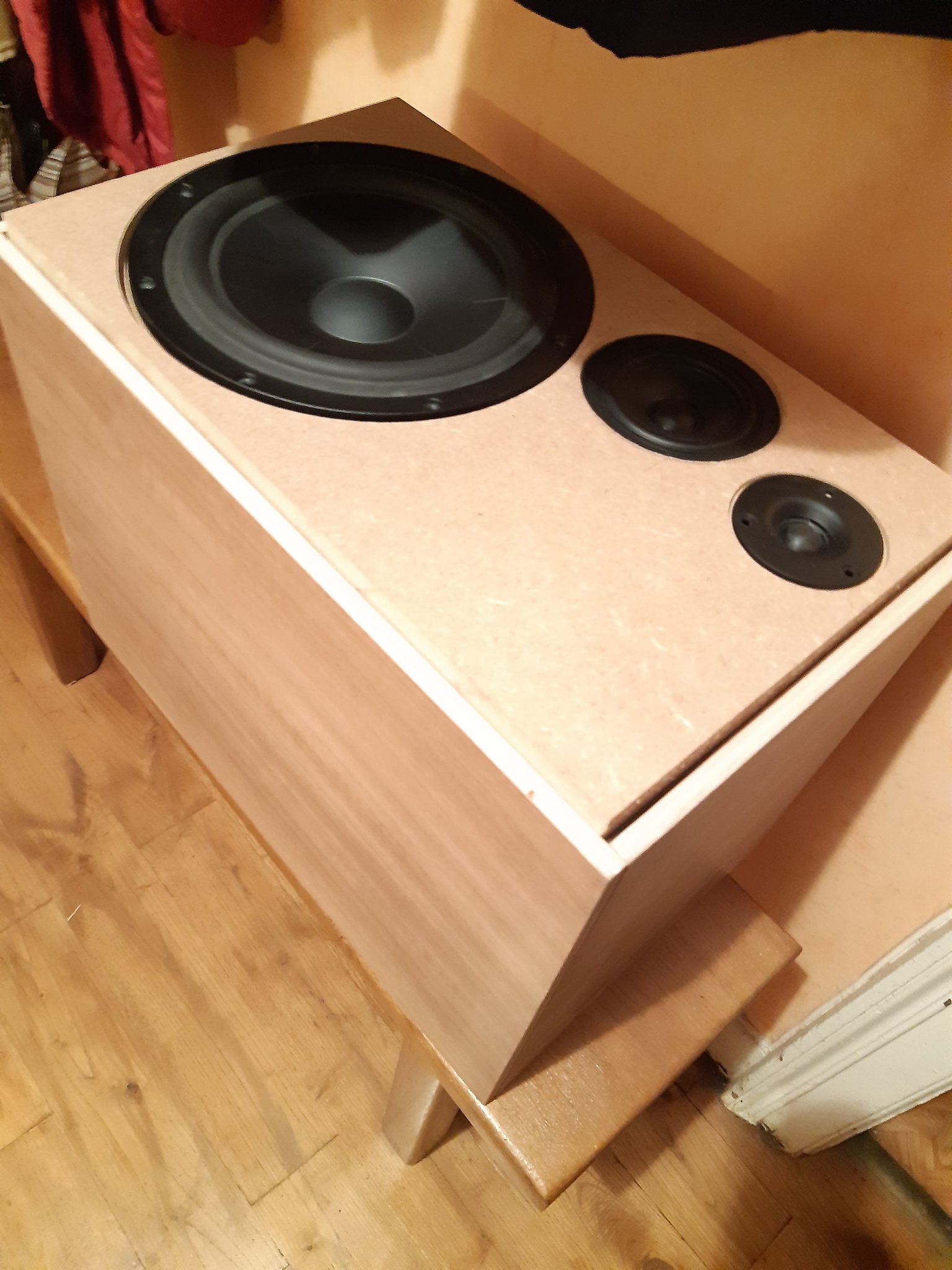

I have also a modest diy I modeled myself as a learning project...it has the size of an Aberth british loudspeaker classic 2 ways size 45 cm × 28 × 33 deep, but 3 ways sealed for little rooms with 8" + 3" + 1" sligthy horned....filter passive in progress...removable back and front, british BBC homage for the look. Picture joined.

Many goid brands, not all expensive...Kef is a good one, better to me than B&W for instance. KlH310 from Neumann is certainly versatile. But it must be heard before a purchase. I am not a Steteophile writer so I am surely not the one to listen to and taste and rooms are a personal thing imho... Edit : I am too in a reflexion for a 2 ways horned or a 3 ways classic with 12" midbass driver...from PA world for all the drivers.
