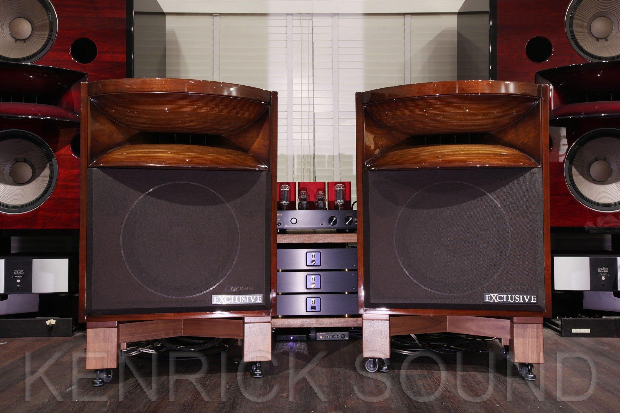

https://en.pifferia.com/products/lals-classical-152-horn-speakers

From my limited experience,classic horns do not work well in small rooms if we take into acount the 2 ways topic ! You often want to liste a little far from them... Idem for big 15" sub à la Onken... it asks bigger room for me... Well, maybe the room modes each time I heard such systems maybe !
But I also know that such TAD systems above in a well treated studio room is what sound engineers work with...
