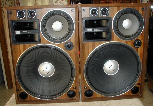

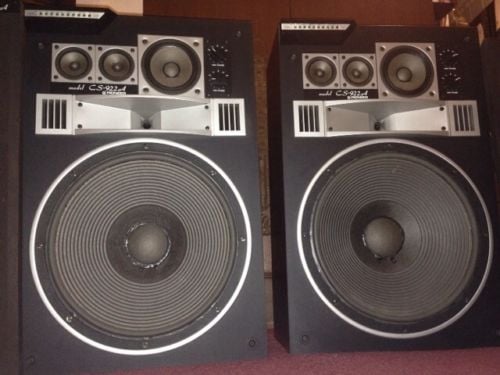

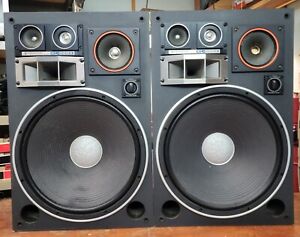

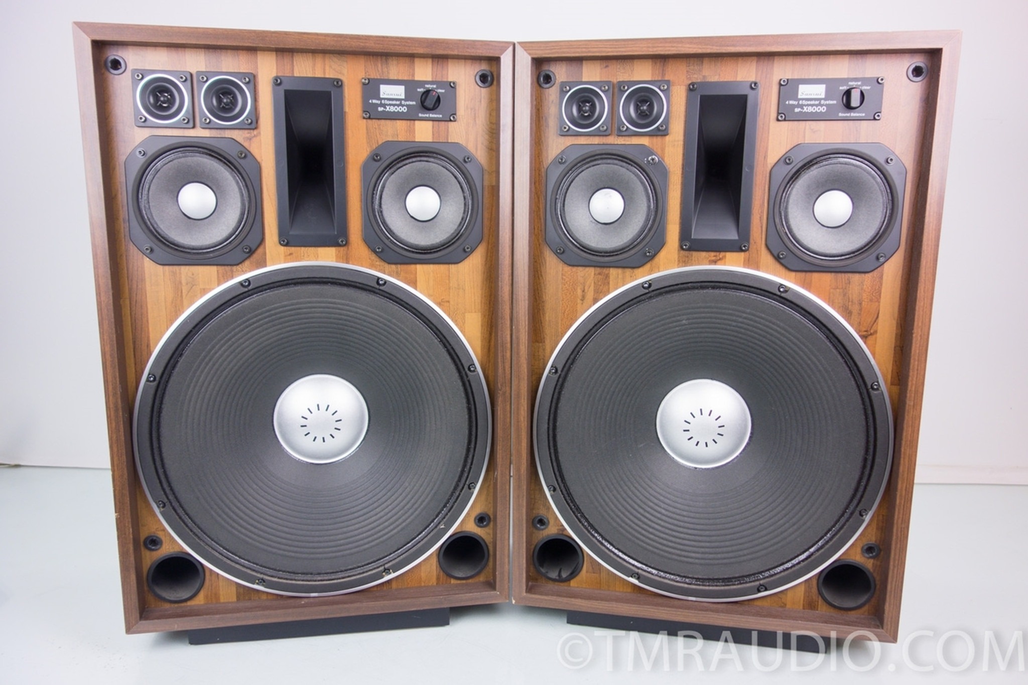

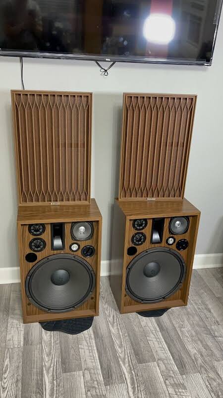

At this point I am only interested in 10-way speakers. I just can't listen to a 9-way, or (gag) a mere 8-way. Imagine asking a driver to cover more than a single octave... why it is just outrageous. A 3-way (eye roll) is not hi-fi... it is not low-fi... it is No-Fi... I had this amp specially made, it goes to 11.
Good old times of kabuki speakers...
