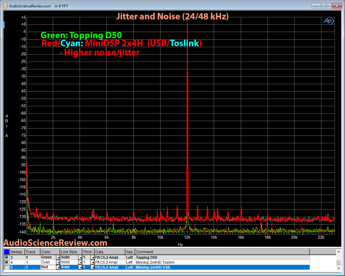

I didn't buy miniDSP because IMO the 2x4HD tried to do too much -- ADC and DAC couldn't be more than a few dollars in parts (quality). Even the (NLA) 2x10HD couldn't output 2-channel 2-way digital; would have at most served as EQ for main/fullrange driver digital (1-way, delay not supported) to external hifi DAC, using analogue outputs with delay for all other/lesser drivers.
I love the sound of a 4" midrange driver. That's a reason why I like some 3 or more way setups. The midrange needs to be crossed no lower than 200Hz and go up to maybe 3500 kHz max. Works a charm for me, especially with a 3/4" dome tweeter.
So you guys have an agenda - no ADC/DAC, because it's not hifi...
My 4-way speakers with ADC/DAC of Minidsp were voted best in show - in 2014. And I did tell they use Minidsp!
So the speaker is very good 🙂
But there are noticable differences and also at Minidsp between different digital sources.
Just the whole result matters indeed🙂
Yes, you can notice the difference just by looking https://www.audiosciencereview.com/...urements-and-minidsp-2x4-hd-dsp-and-dac.2674/
In anyway usefull. The most terrible digital devices have good numbers since the beginnings.
