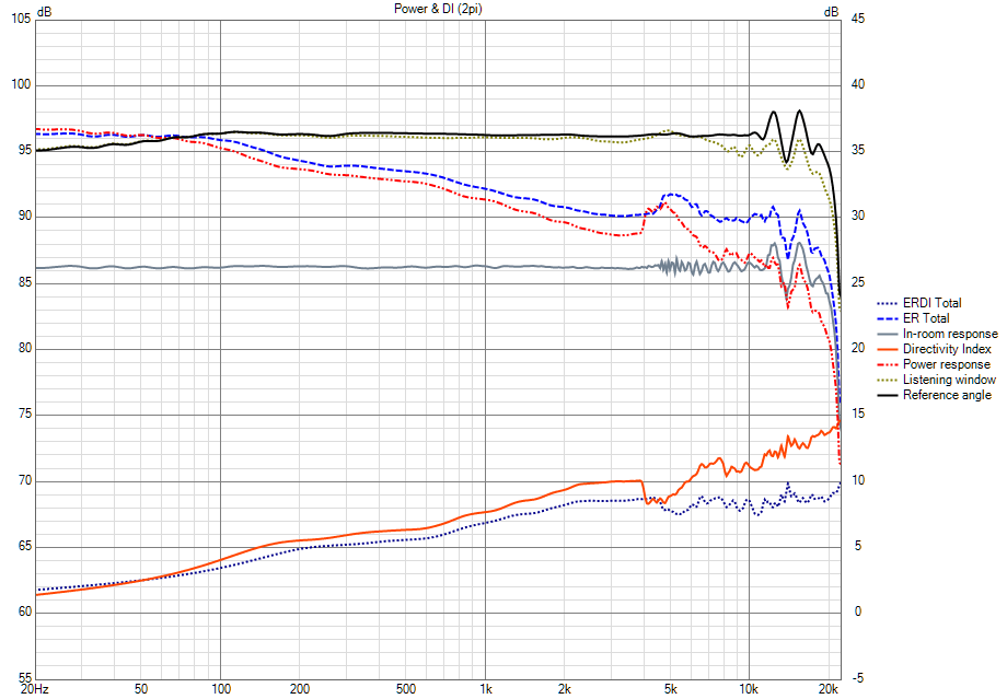

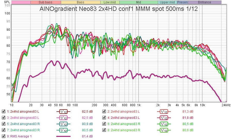

I use a lot of DSP and even trickery based on science (like in that thread you mentioned). Most stories I've read of people that start out using DSP is that it makes their speakers sound dull or some other disappointment. I'll tell you, it isn't straight forward right away and it requires patience and perseverance to get the most out of it. But the rewards can be great.
I use a normal functional living room, with limited space available for speakers. The puzzle was to get the most out of that. It made me work that much harder.
Above the Schroeder frequency I want the speaker to be as independent from the room as possible. Below it, I want them to work with the room.
Nowadays the arrays are filtered, consisting of 5 separate driver groups, the higher in frequency one goes, the less speakers contribute. At the bottom end they all share the load.
Don't know what to call them though, 5 way? Or 1.25 way... anyway, if you follow the craze on ASR about the Harman type graphs, you probably wouldn't expect an array like I showed to look like this:
A smooth and slowly rising DI, in other words: predictable results in-room. To take that a step further I put big absorption panels at first reflection points.
Without room treatment and DSP I would never be able to pull all of this off. Going by what I've learned, most of it on this forum and helped and/or inspired by fellow members here...
